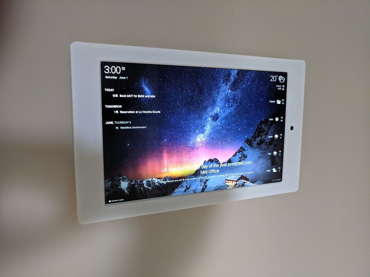

Dashboard Mount Solution - Fire 10.
I thought I'd post my dashboard solution and set up as I struggled at first to develop one that had the Wife Acceptance Factor (no visible cables). I have attached some links below, including one to get round the Amazon Lock Screen Problem.

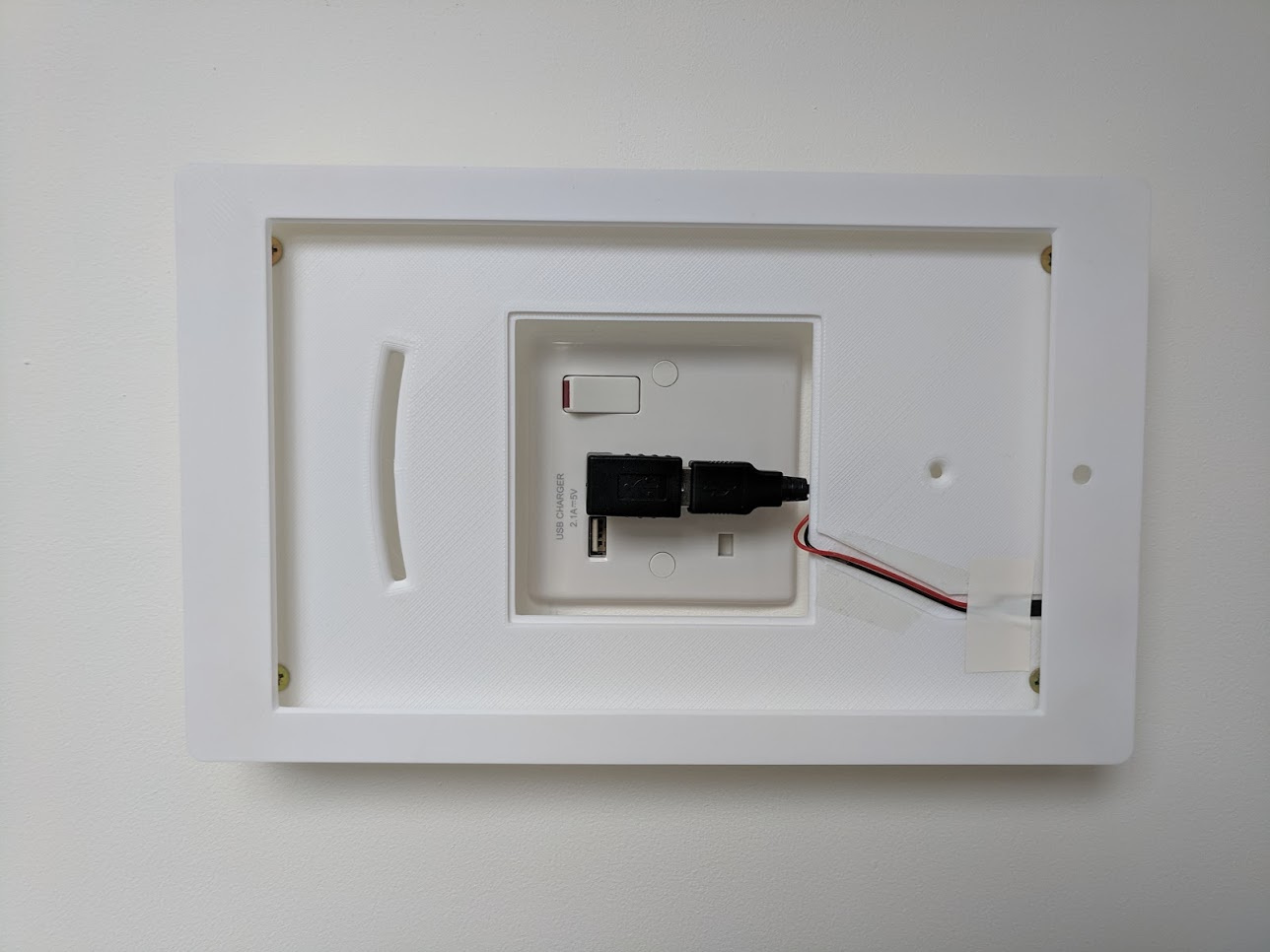

Step 1 - Hide the Cables
I ran a fused spur from an existing socket, up to a new USB Socket.
The mount I used was from Makes by Mike by MakesByMikeStore on Etsy This was a really positive interaction and the cuts out were made bespoke by the store. I am in the UK, and even with the postage this was way better value than anything I could find over here. The USB cable was supplied by the same company.
Step 2 - Mount the Frame
I needed a right angle USB and some spacers, both from E-Bay.

Step 4 - Fit Tablets.
I have set the tablets up to display the menu for 15 seconds, then move to the screensaver. After 5 minutes this switches off. Any movement in front of the camera will load the main dashboard menu.
I am still getting used to HE and the Dashboard, so have not really experimented with colours and tiles, that's the next step. I hope this helps someone.
