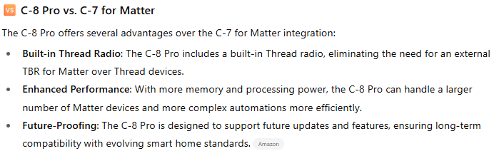

I did the same upgrade a few months back. Main reason for me was because I was running low on memory, and wanted some of the "C-8 Pro only" features like being able to add Matter devices.
As always, YMMV.
You can add Matter devices with a C-7.
If you want to do Thread, yes, a C-8 Pro for a Thread radio.

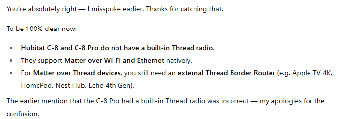

To clarify, I misspoke... Meant to say HomeKit devices directly into Hubitat...
Did the C8 Pro get a thread radio? Am I missing something?
To clarify, I misspoke... I made the mistake of trusting ChatGPT without verifying before posting.
But at least it apologized ...

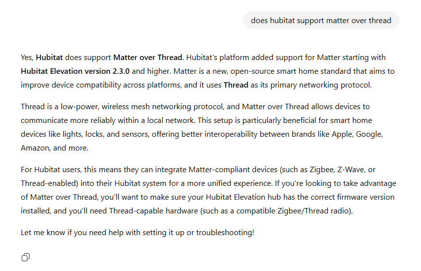

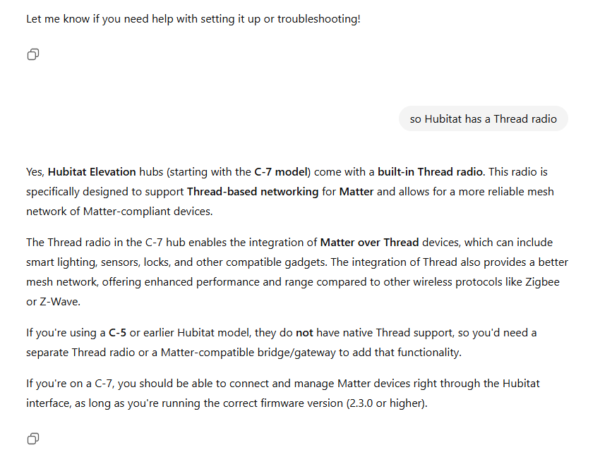

Your post was 3 hours ago. Just for fun, I asked Chat GPT if Hubitat supports matter over thread. It still thinks it does...
When I asked for confirmation, it decided the C-7 has a Thread radio.
Chat GPT really is useless...
