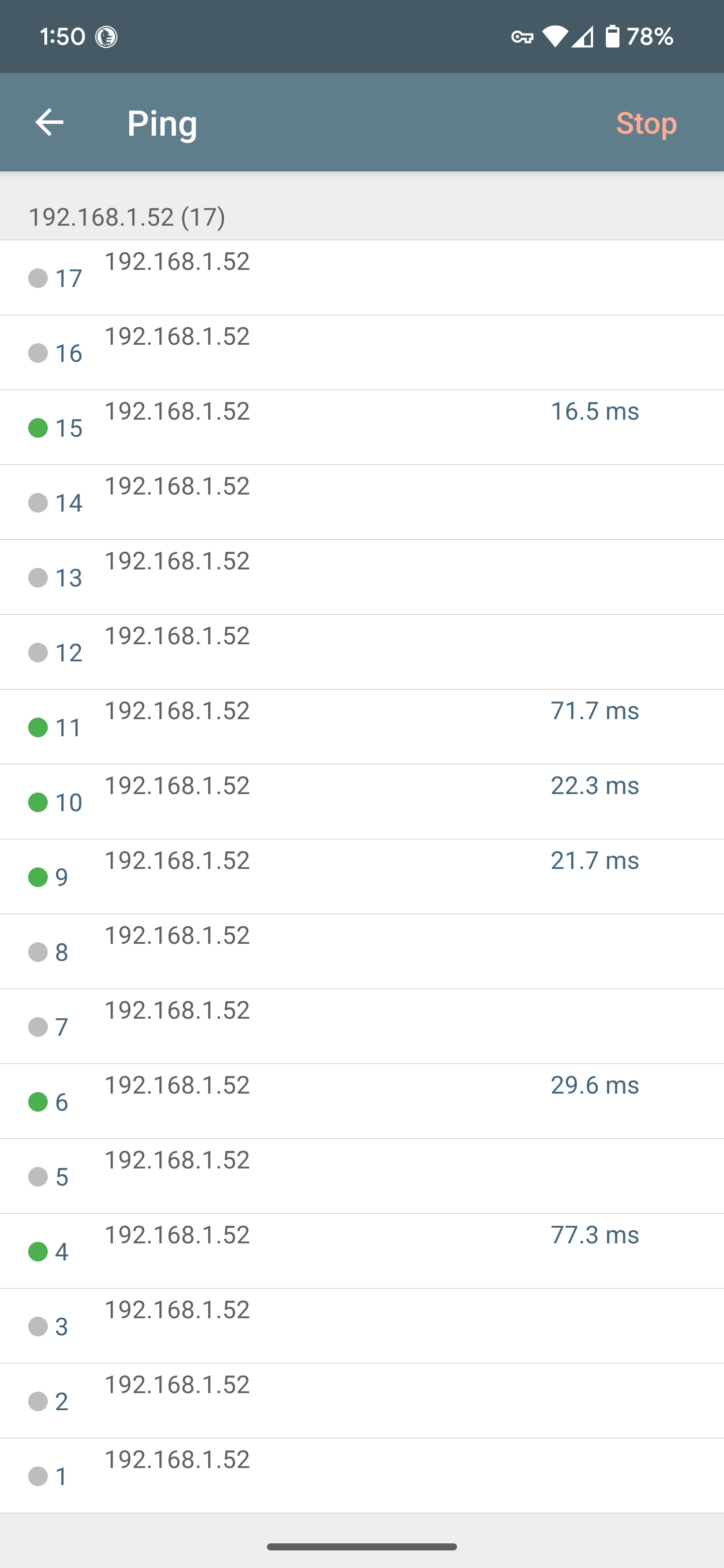

Have a Shelly UNI plus set up to read a voltage and it is working but throws errors of connection failure: connect timed out.

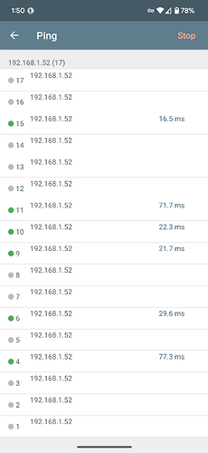

If I ping it constantly it's there for a few or one ping then gone for a while then back, repeat.
Is it a power saving deal that it's up and down or ?
It is within 10 feet of WiFi also

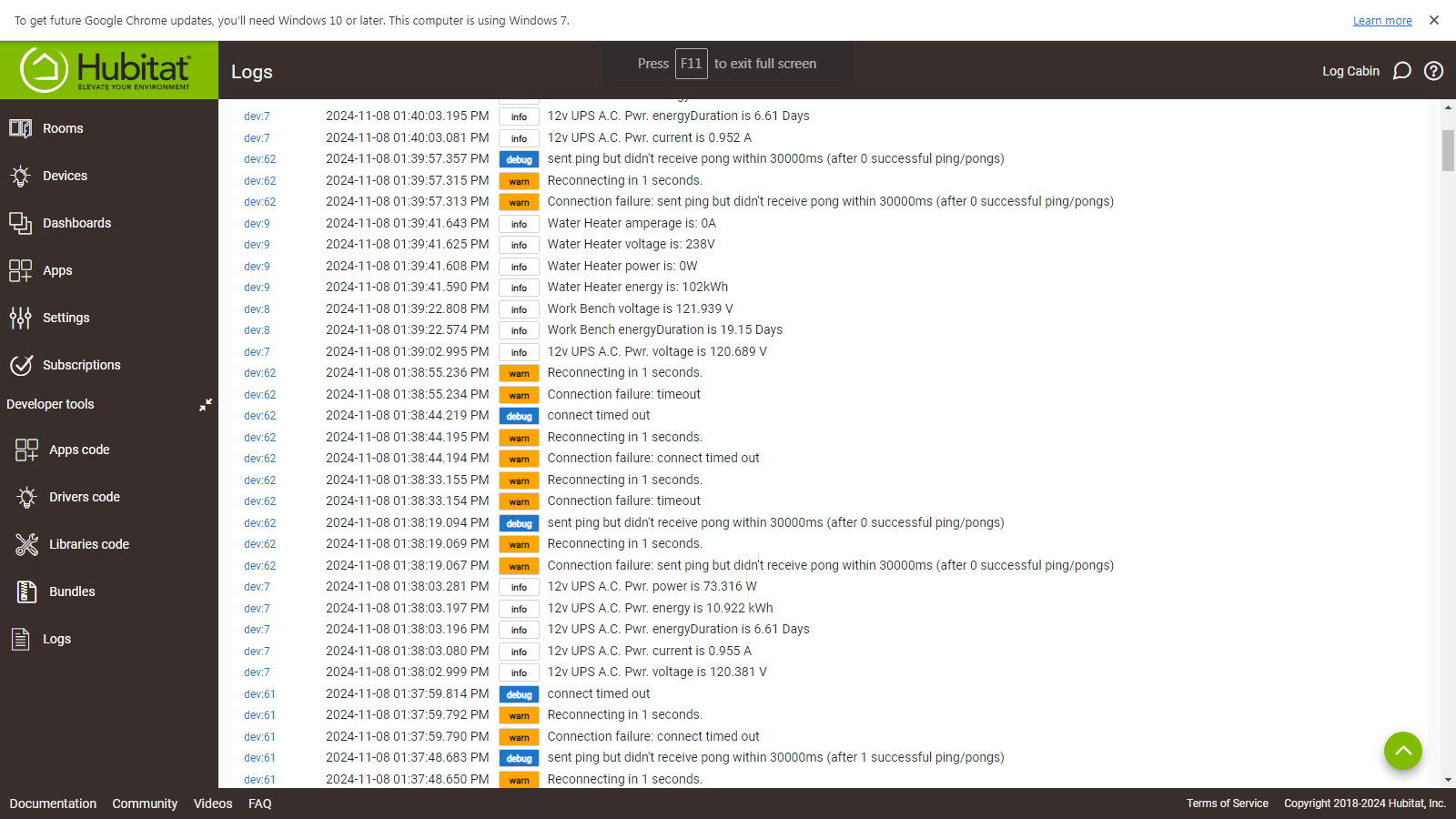

Other than logs showing error it is working.
But if I try to access the UNI on main WiFi it has trouble connecting and might sometimes but then HE loses connection and I have to go to device and click connect to fix it.

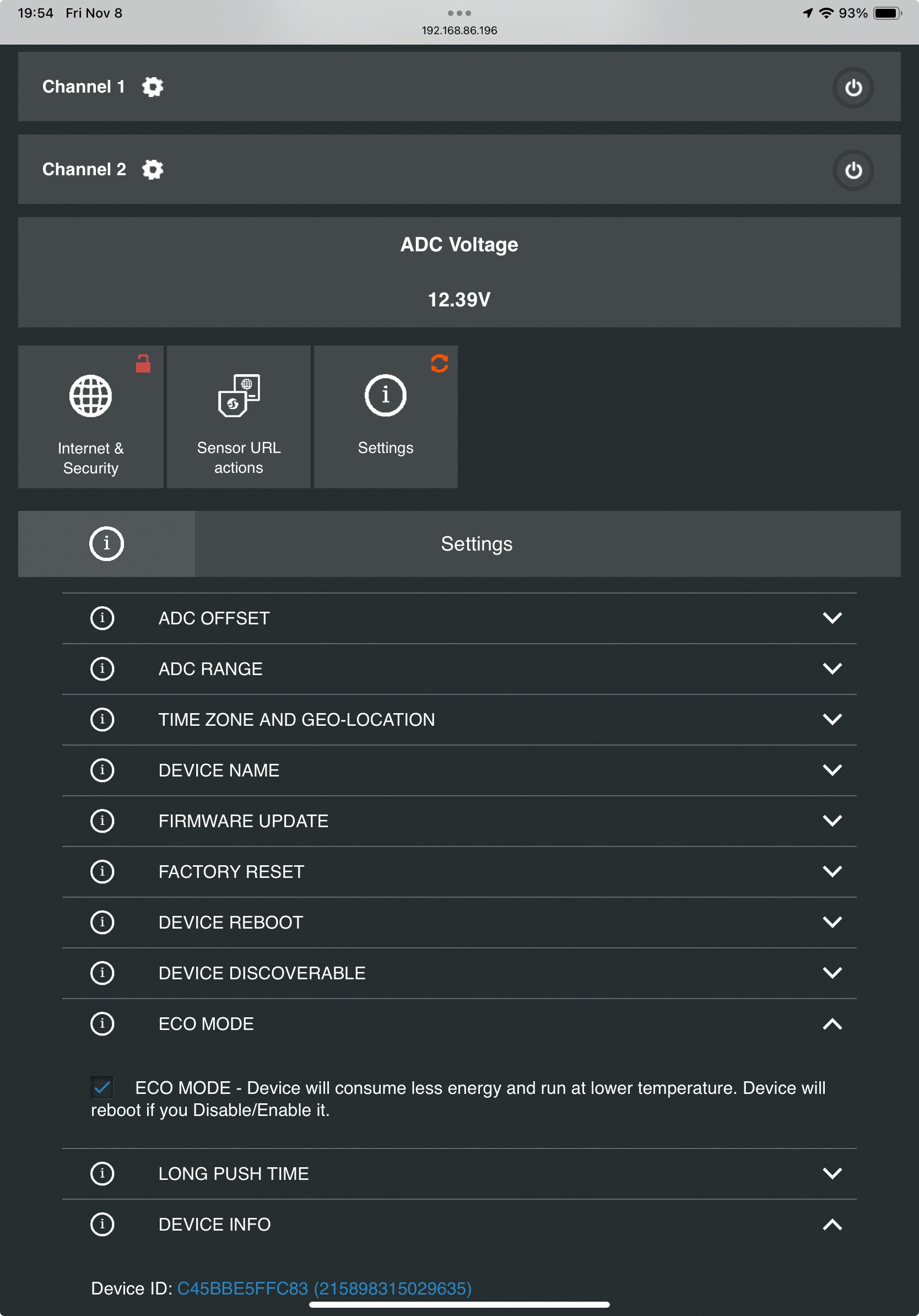

Im running latest FW. Are you in ECO mode on the shelly? I set mine to ECO and it dropped the idle consumption considerably which I want cause running on a battery/solar system. Wonder if in ECO mode its using its ESP32 chipset sleep mode periodically. Maybe you have no issue if it doing what you want?
I don't recall seeing the eco mode, guess I will need to poke around a bit in the webgui.
It’s under settings:

Eco Mode is off in the Shelly UNI webgui

Wow, you running an older version for sure, mine look different. But yeah ECO mode is there.

Not exactly on the topic.. But you seem to have 1 second reconnection timeout.. It might be a bit to rough.. 5..10 seconds might be more reasonable.
Connection may be lost here due to two potential problems (generalized).
  1. network issues
  2. firmware issues
On second topic behavior might be not that obvious, but some other http commands might in some cases hit websocket connection on Shellies (don't know if it may be related to the device being busy internally and not being able to keep websocket protocol intact)
Check if you have the latest driver version. After that if you see a chain of reconnections try to manually (on a driver page) disconnect and then reconnect.
There is a chance that asynchronous reconnections might overlap (like after delayed confirmation of success driver send "connect" request thinking it is not yet connected)
After connection success (with debug enabled) you should see a quite fat log of driver taking a survey in case of any state changes were missing while offline. And your logs miss this response - this basically signals that connection weren't established,
