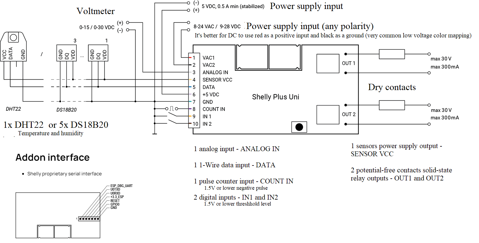

The folks over at Aartech recommended the Shelly Plus 1 UL (Shelly Plus 1 UL - Aartech Canada) combined with the Shelly-Plus Addon Sensor Interface (SHELLY-PLUS-ADDON Sensor Interface - Aartech Canada) to host up to five DS18B20 external temp sensors as per this diagram:
It looks like the add on interface clips on to the Plus 1 and uses its serial interface for communication and power. Would your driver set work to expose these temp sensors connected to the add on interface? Aside from initial configuring with all sensors connected, should these sensors just show up as child devices? What is the "leanest" setup to do this on Hubitat while keeping traffic low? I'd like max reporting resolution on the temp sensors if possible to at least 1 minute and/or 1 degree F reporting intervals.

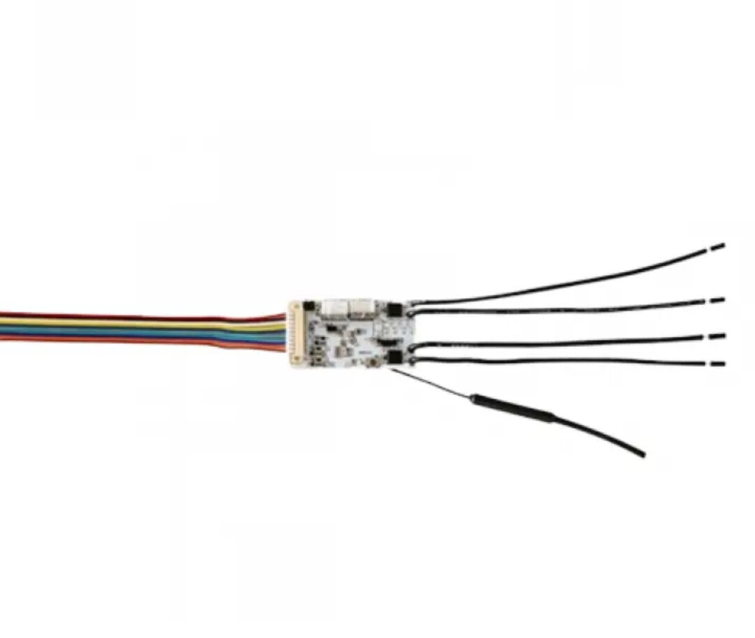

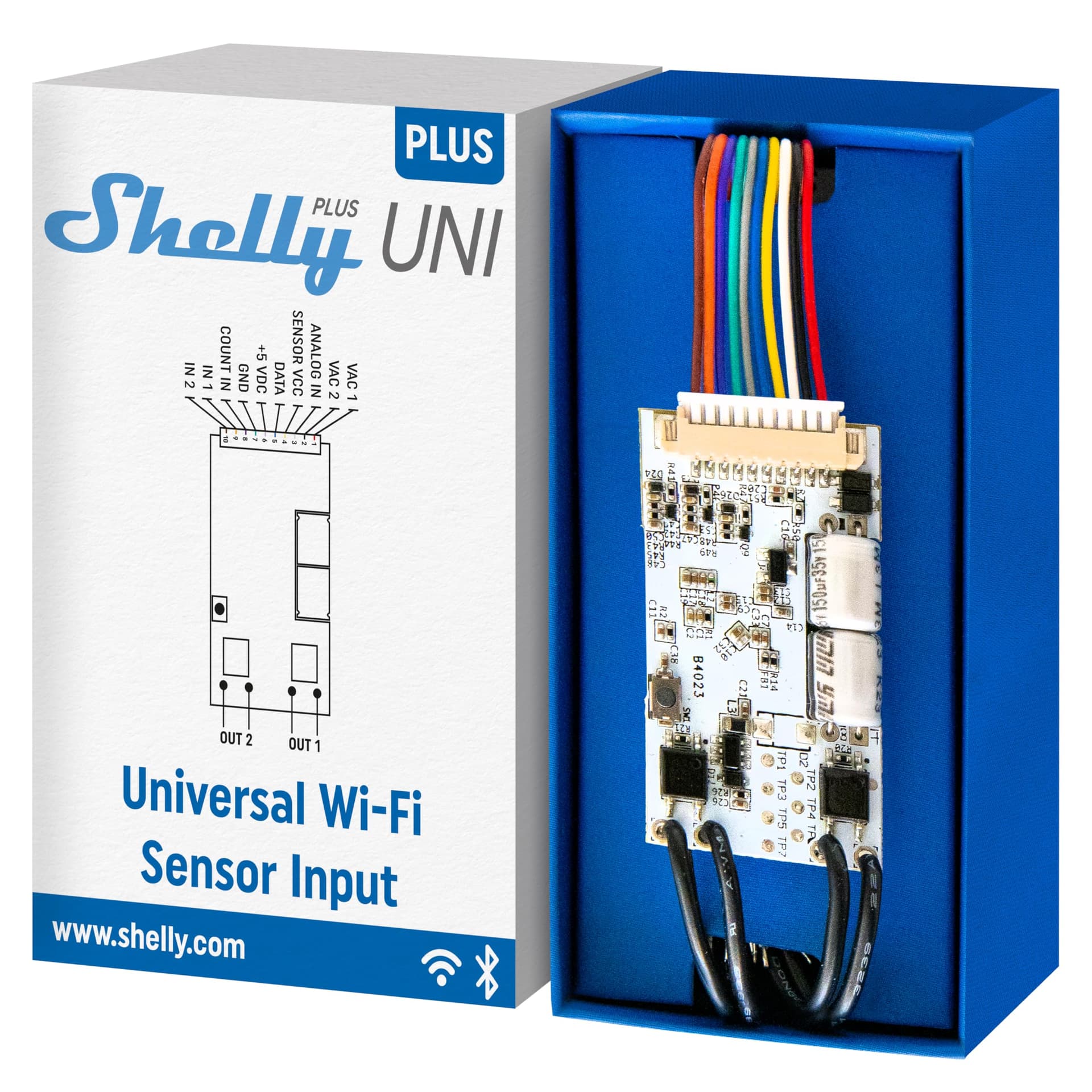

Regarding smart implan alternative - there is so called Shelly Plus Uni. Should be quite close to what Fibaro Smart Implant is.
The sensor add-on module is supported on top of any shelly plus module it can be attahed to. After attaching module, connecting and configuring the driver 'Configure' command should survey your setup for sensors/components and spawn child devices accordingly. As long as your shelly device and add-on module can provide you a setup of choice it should be handled by the driver. (Shelly Pro switch addon module is also supported)
Currently there is no support for smoke sensor and very limited support for rgb/rgbw functionality. Shelly BLU is currently not supported directly (But can be used trough custom scripts as there is shelly scripts support in this driver). CCT functionality is ready for submision (driver update). Switches, meters, dimmers, buttons/contacts, shutters, analog inputs, pulse counters, temperature sensors - supported with auto scaling to the number of channels specific shelly device implements. There is partial support for Shelly Plus Wall Display (thermostat component is not documented; on/off is not working due to that - expected control payload attribute seem to be ignored by the device [on the firmware version the implementation were tested back then])
As for traffic - this one is not that great. The driver is using WebSocket to keep comunication line open. And all shelly devices send periodic data once every 2 minutes on average (depends on the device). Shelly does not provide any option to throttle the trafic (despite such request were made to their support site more than a year ago without any response nor feedback).
There is another approach (in other driver) that uses hooks to send state changes (not sure if it has add-on module support). Hooks (in form of scripts) can be manually tinkered for the traffic required. The cost of using hooks is the nesesity to expose hub to inbound connections to other devices (WebSocket is a hub-initiated connection; Hooks are device-ti-hub messages initiated by device).

I was not aware of the Uni, but it does look to support 3 external DS18B20 temp sensors. I guess you just need to be a bit more creative with this product with respect to a case for protection.
Again, your feedback is very much appreciated :slight_smile:
Keep in mind there are two devices Shelly Uni and Shelly Plus Uni. My driver supports only the latter one (as a Shelly Plus family device)
Ok, duly noted. Aartech here in Canada only stocks the Plus, so all good.

I modified my Aartech order to two of the Uni Plus devices. I'll report back here once they arrive from back order.
