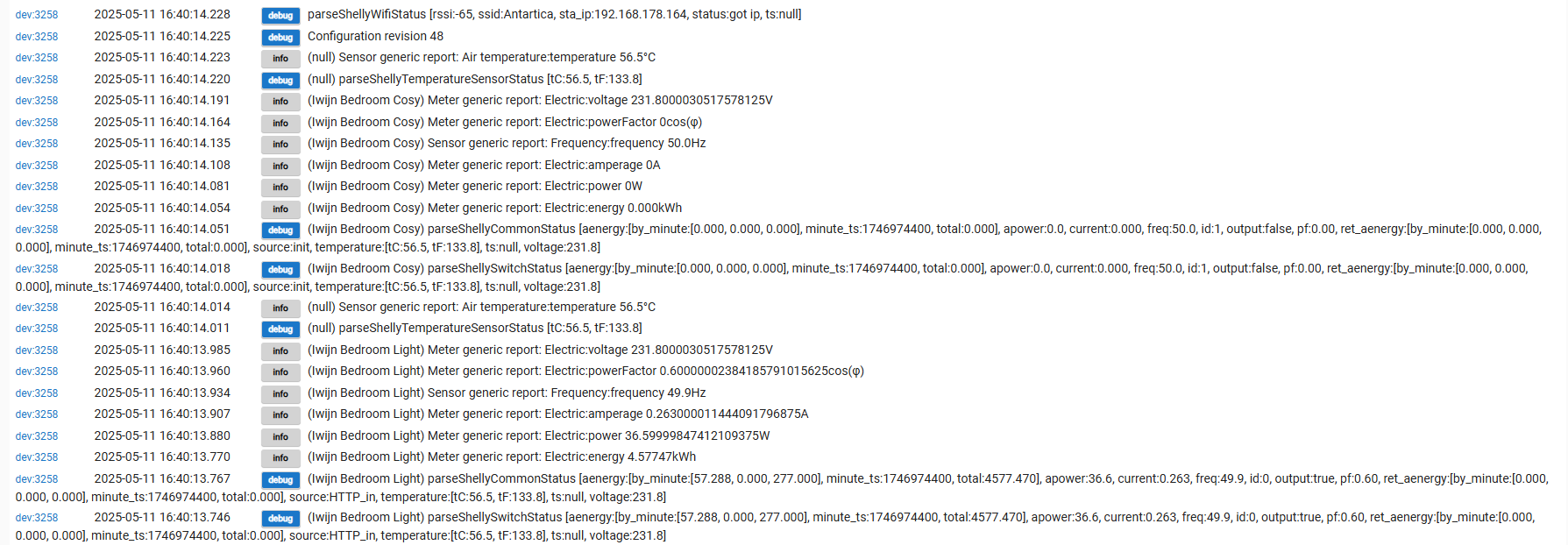

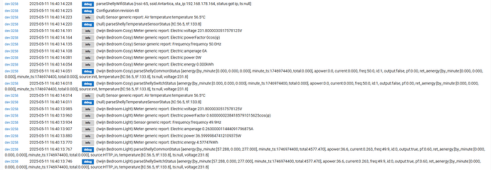

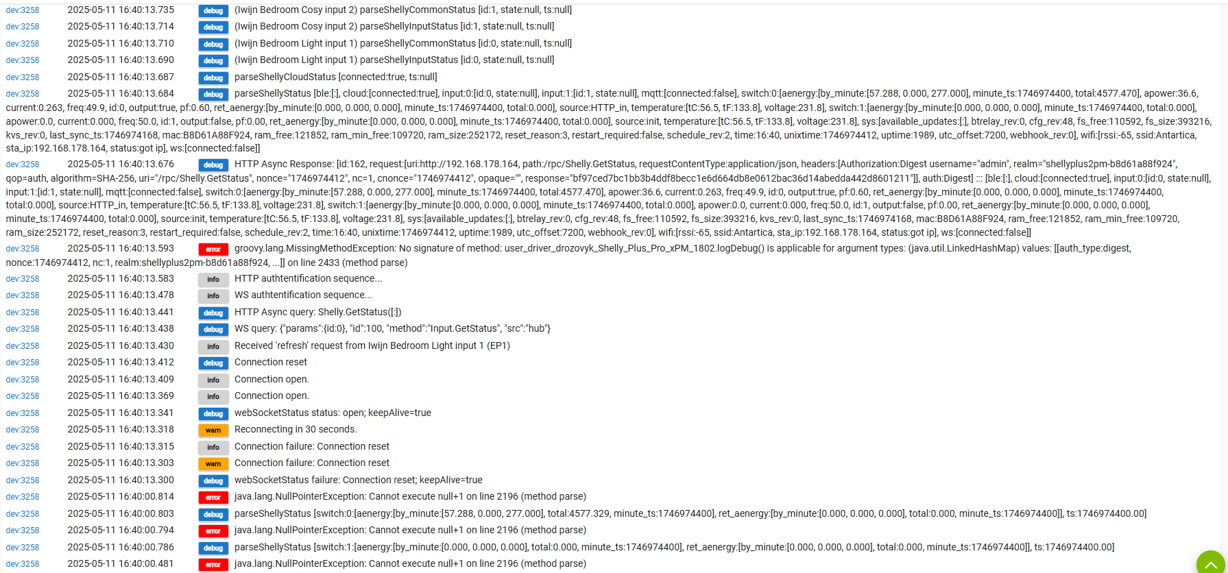

I have the same issue, the logs starts when I turn on the device using the shelly app
Summary
Thanks for the log. Looking into the issue.

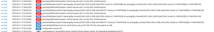

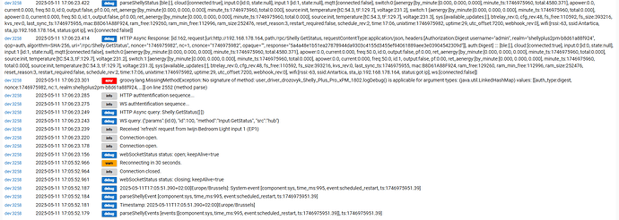

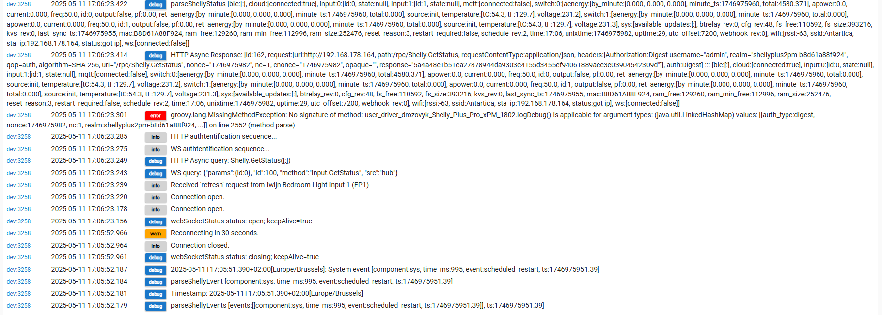

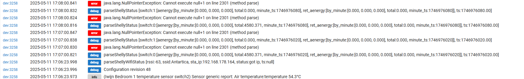

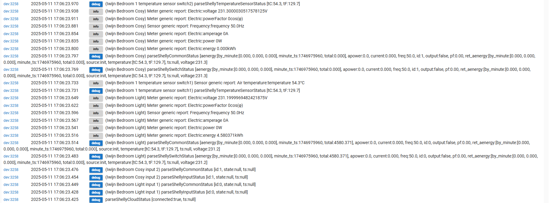

And this is a log with your latest bundel of a reboot of the device
Summary
It looks the same. And it seems like an expected attribute is missing in the device response.
P.S.:
Confirming: the issue is probably comes from the latest firmware. According to documentation status report must contain 'id' attribute. While HTTP response has it, WS events are missing it. Working on a solution..
The bundle is updated.
The missing 'id' attribute issue is mitigated by extracting it from component name instead.
