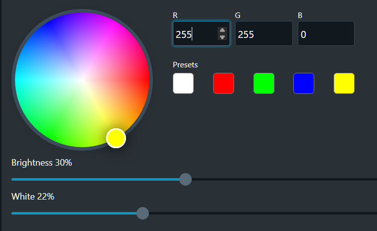

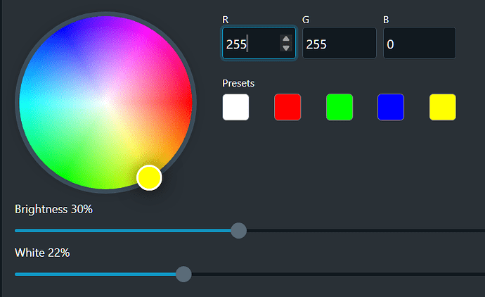

I am testing Shelly Plus RGBW device.
Driver (Shelly Plus/Pro xPM) picked up all inputs (even the one which is configured as analog). All inputs are working just fine and as expected.
However RGBW controls are near 100% Brocken.
On/Off commands are working for all 4 channels all together (it looks like as intended).
Set Level (on the left side of Set Saturation button) works only for the RGB channels.
Start/Stop Level Change buttons are working for all 4 channels (again, it looks like as intended).
All other button are not doing anything at all. As a result changing color is impossible.

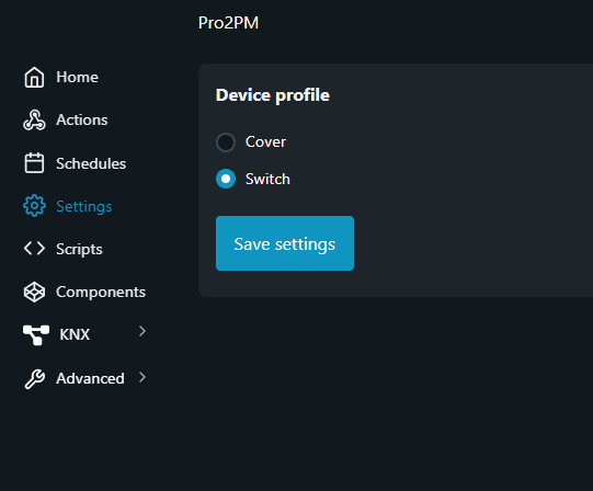

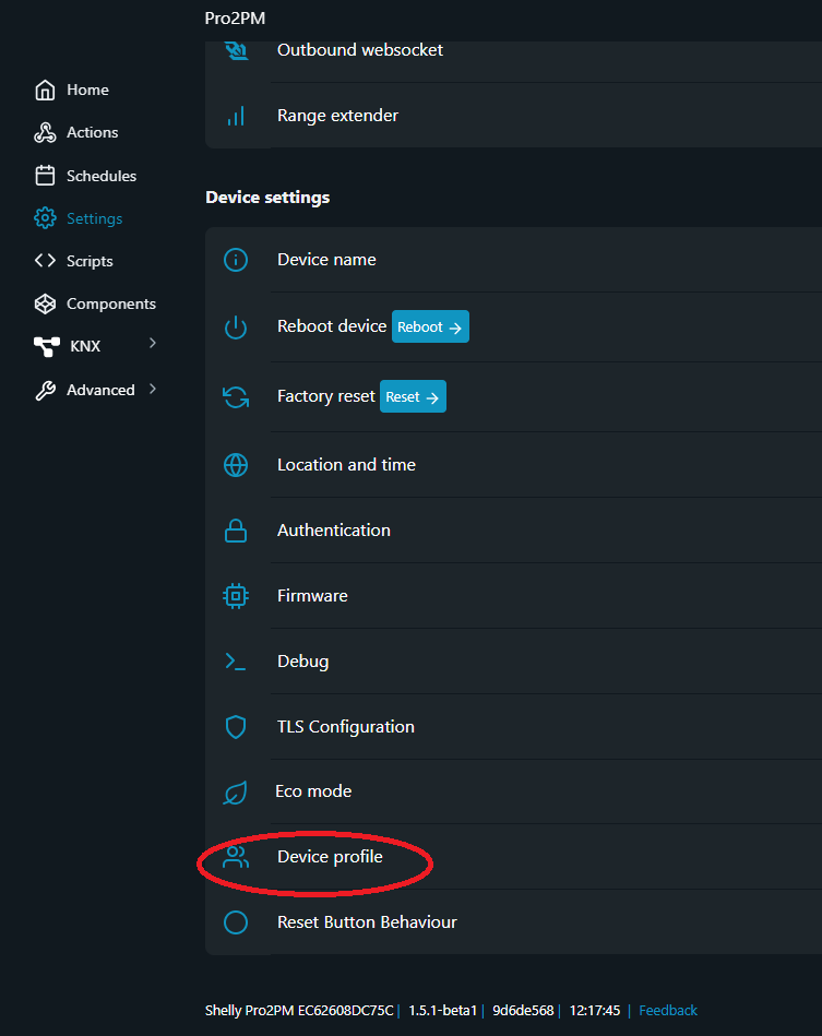

A RGB and RGBW profiles support is incomplete. I can try to finish it. Tho I'm lacking the device itself for proper implementation and testing. It will need some iterations with feedback without device at hand.
As for individual channels - this mode is expected to work. There should be profile selection option on the device itself (Shelly web interface). After changing to the separate channels profile device should work as 4 independent dimmers. And driver should spawn child devices accordingly after pressing 'Configure' on the device with active profile.

The RGBW profile is tricky to implement properly specifically due to the W channel. The math it self is trickier to mix in W channel and adjust RGB part for a specific hue. It basically needs to detect what amount of target color can be deliwered with W component and augment with RGB the rest. As such it needs to know W component temperature (as a user adjustable setting) and the same way it is desired to know RGB part white (all to 100%) color tempreature (usually 6500K for RGB leds)

As I already mentioned, all these color calculations and tricks for the color/color temp settings should/must not be done in Driver. This is job for the app. Driver should/must provide only a controls for the individual channels. Almost the same as it done in individual channels mode. White (W) channel ALWAYS must have an individual control. In RGB(W) mode On/Off Switch should/must control RGB channels in one shot and Channels 0, 1 and 2 simply should be marked as R, G and B respectively. Color Picker is desirable but not really necessary. This is exactly what Shelly app is doing.

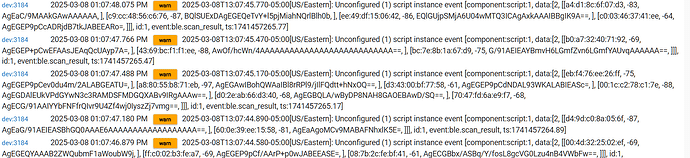

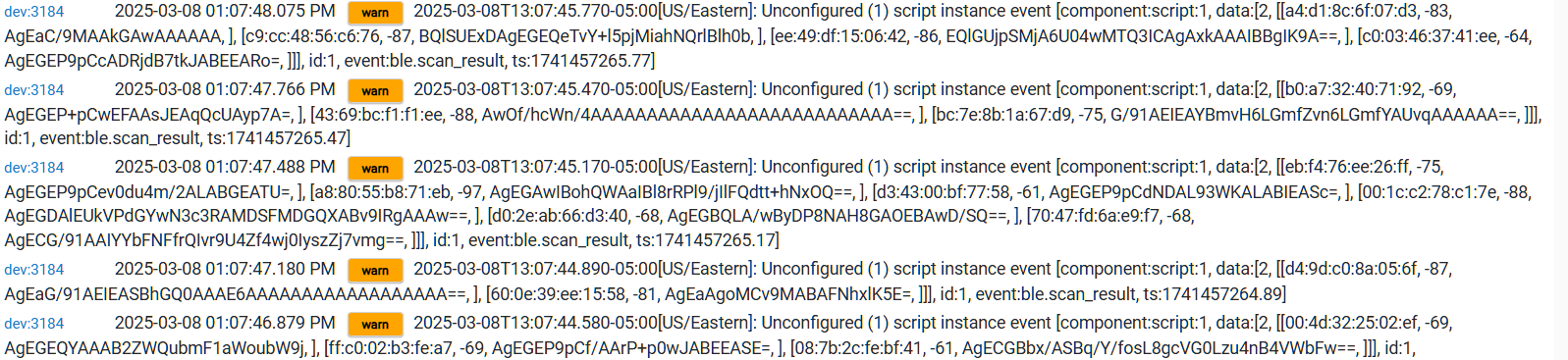

These warnings in the log are from Shelly I4 DC device:
What is unconfigured and where?
How do I fix this (minor) issue?
You seem to have added a shelly script. It might be related to bluetooth devices.
Driver sees its activity but no child device to forward to.
Just press 'Configure'. Corresponding child device will be added.
These child devices are 'switch'-like allowing to start/stop script, showing if script is running and allow to get custom messages from script if needed.
ble_scan_result will be ignored as script child devices listen for specific events. Those are listed in the sample script on a hubitat device page. Scripts may send events to the hubitat driver child devices. Tho there is no custom events from child device to shelly script yet.

Shelly I4 DC has a BLE related script added.
Your advice took care about this warning. Thank You!
