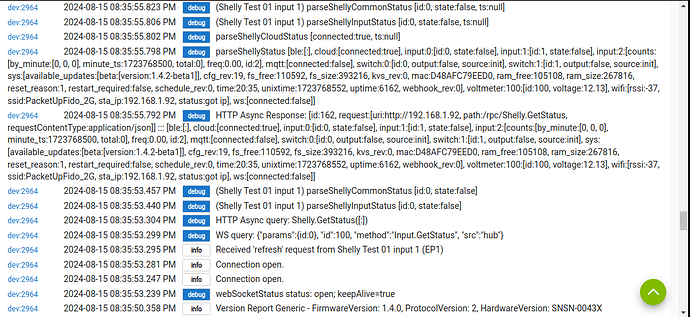

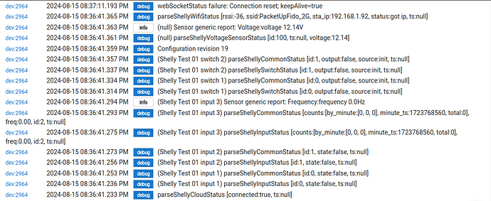

The voltage didn't spawn but the rest of the children did this time. I had to restart the Shelly, it had gone off-line.
The logs are showing that there is a device called voltage sensor 101 and that it was installed but when clicking on that device in the logs it says that the device is missing.
Below are the component list and the logs. I wasn't sure what logs that you needed so I attached all 20 screenshot pages.
It looks like the driver is close to working. I can see the voltage reading being returned in the logs.

I updated the driver.
But it should work. According to your logs it behaves just like the typo mentioned before is still there (not the latest version).
With that typo device get spawned but then deleted right afterwards as it's not put in the 'white list' for child device cleaning (that removes unused child devices)
(null) int the logs means it is unable to find a child device for the specific component and id.
I thought that's what that meant. I'll download and update again and let you know. Thanks.
All set. The Uni voltage is showing up. Thanks again. I really appreciate it.
