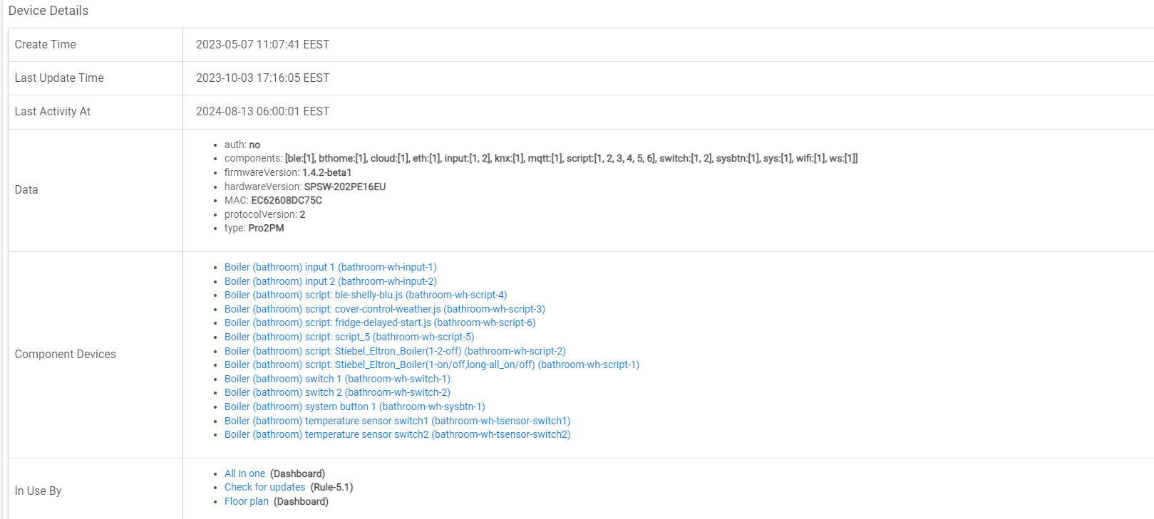

Screenshots are below. I do not have a component list. I pressed poll and refresh to generate the logs. Thanks for taking a look at this.
What driver have you installed?
Component list is specific to my driver. It appears after pressing 'Configure' button and shows what device functions driver can see. Later based on this list specialized child devices are spawned.

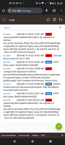

Here is what I get when I save the Uni IP address and hit configure. I tried pressing connect and others to but it didn't seem to find the Uni.
I have no component list.

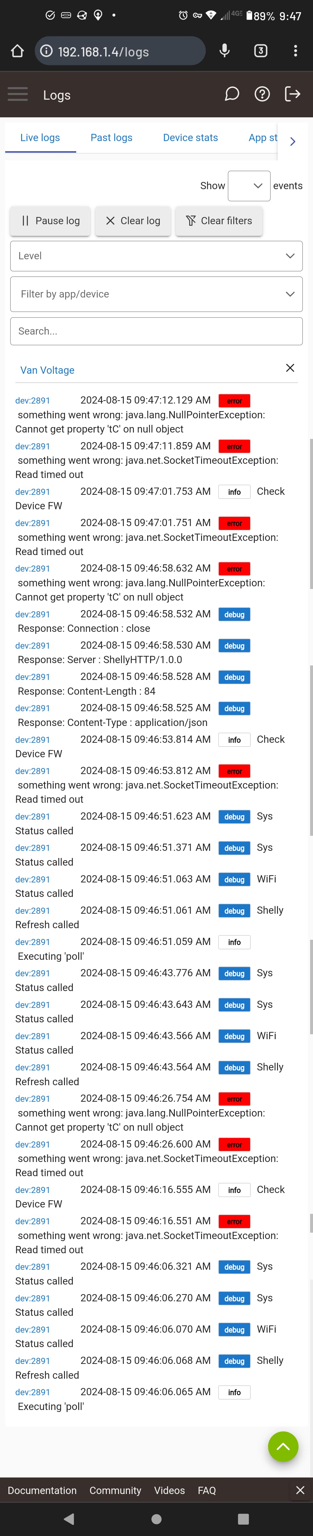

This is what I get when selecting debug logs and press configure
Oh. That one should be fixed in the latest version
There were an issue with type casing when debug logging is enabled. Basically debug log were blocking 'configuration'
The applied change is
logDebug(componentMap) -> logDebug(componentMap.toString())
at line 302

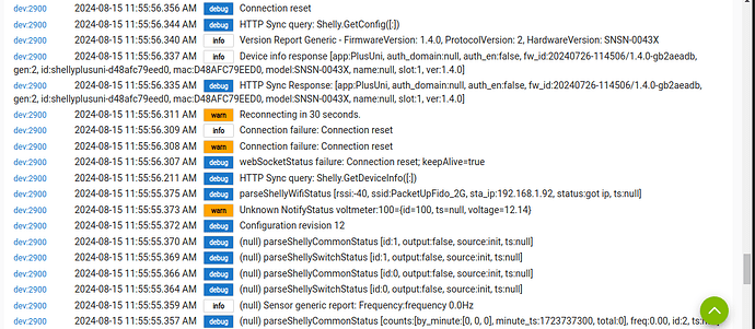

Here are the screenshots of the components and logs.
Summary
Components
Logs
Ok. It detected most of the features.
You have
input 0 - (configurable) switch
input 1 - (digital) switch
input 2 - (counter) pulse counter
They are intact with documentation. Input 0 can be configured as analog input (voltage meter) in the devices setting. Right now it is set to 'digital' or 'switch' mode
Voltmeter as a separate component is not yet implemented. But I now have logs and will add it.. Well.. Maybe in a few hours.. I guess..
