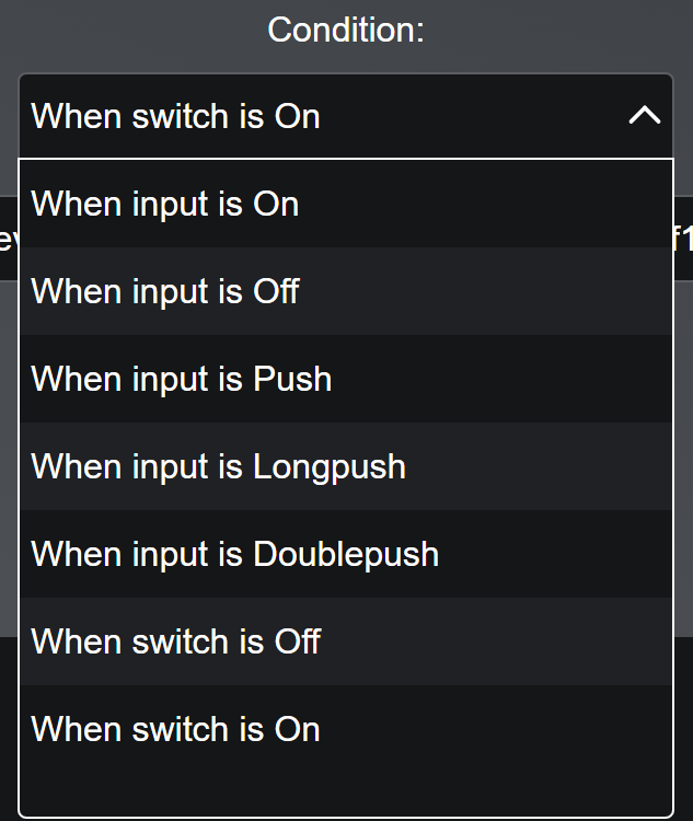

Yay - it's working! I created two webhooks, one for when the switch is on and one for when the switch is off and now the device state updates in HE whether I turn the switch on/off via HE app or manually.
Just curious, what's the difference between 'when input is on' and 'when switch is on'?:
Not sure.... have you read any of the docs for the device? https://shelly-api-docs.shelly.cloud/

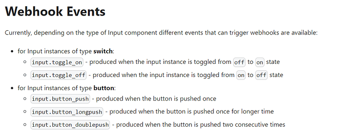

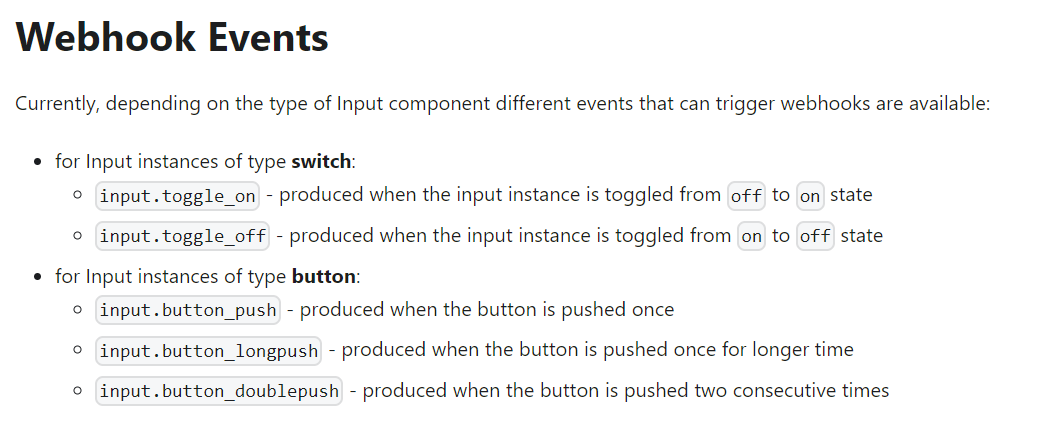

Thanks I found the below in the below, but I it doesn't make much sense to me. I still don't see the distinction between input on and switch on. Any ideas?

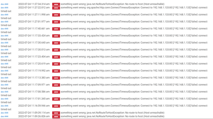

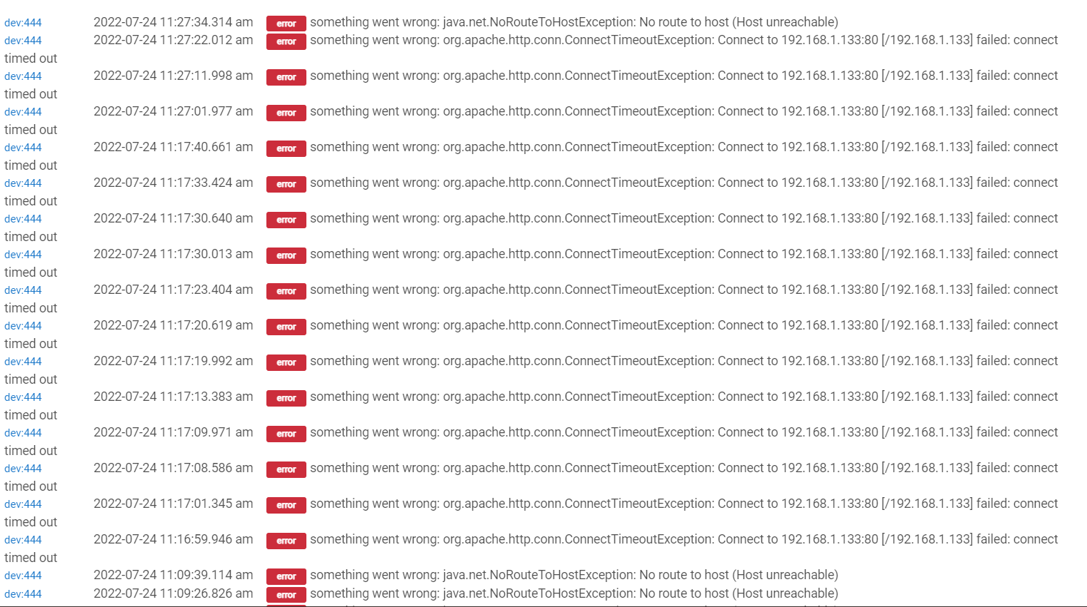

But, the motion lighting automation I have has been a bit janky. I turned logs on and noticed this in the device log. What could be causing this error:
Not a shelly issue but a network one, last 2 lines are the reasons.
