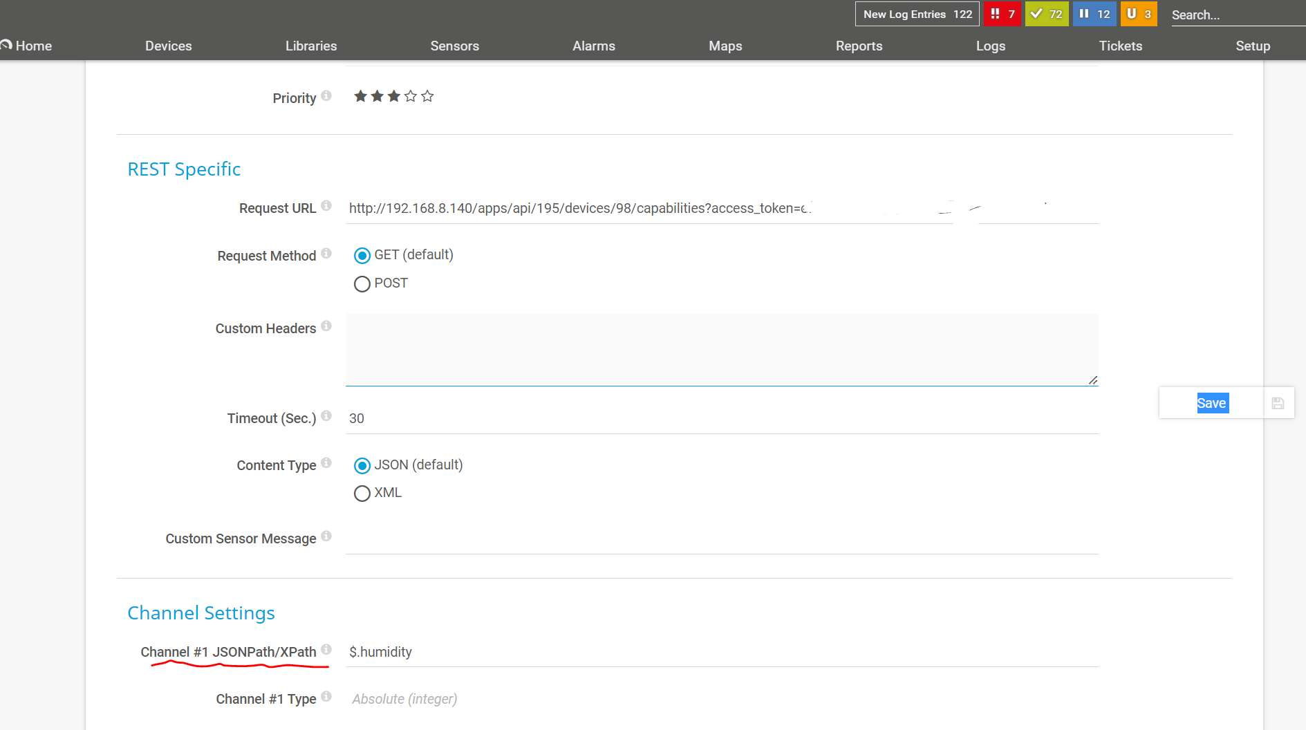

Thanks Simon, I got that far and can see a webpage with the data I need, but I want to know how to use that JSON data in a client. Just not sure of the syntax to extract the parameter value.
That would depend on the platform you are using, which I now see is the crux of your question :slight_smile: That I can't be 100% sure of.... Sorry.
But if I had to guess.... It would be, in my case:
For Virtual Battery Sensor:
attributes[0].currentValue
For Battery Status:
attributes[1].currentValue
Thanks for the help, I managed to get it working after a bit of playing. I'm able to read 10 channels into PRTG which has a decent historian in it for trending.
format to use is "$.0.attributes.temperature" based on GET for All Devices with full info.

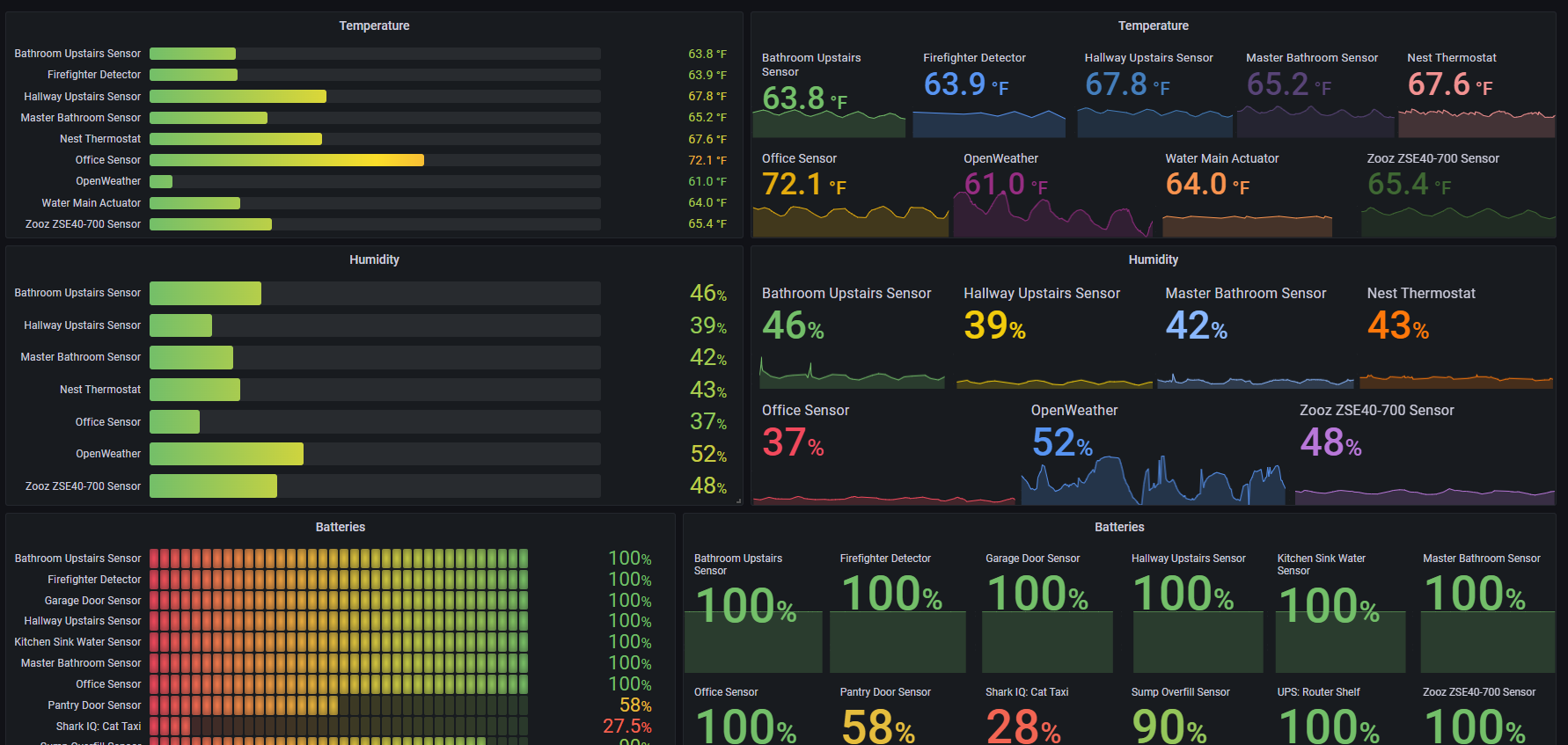

Just updated my main sensors dashboard yesterday. I was getting so much data from multiple sensors the line chart turned into a big mess. I kept the line charts below so I can see trends if I want but now I can see current conditions at a glance.
