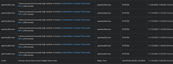

C7 Hub - I have been checking on this for a few weeks and have found that the Ecobee Suite APP may be the culprit here.
Unsure why its posting so many events an what I can do to cut these down. Any advise would be great.
2 EcoBee Thermostats with a total of 5 remote sensors between them

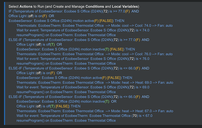

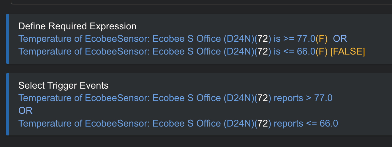

One App running on the Office thermostat side. With required expression.
Perhaps a different way of approaching this would be, are you seeing any changes in the performance of the hub in responding to triggers to automations you have configured? "Spammy Devices" is likely a result of defaults in HE for the number of events considered "normal" that does not account for some edge cases, which things like Weather Stations and alike will produce with a number of attributes updated regularly, which may be the case for you as well. Equally, there may other reasons for elevated readings from the EcoBee App that the HE hub automatically picks up, but may not be a reason for concern.... but is up to you to determine.

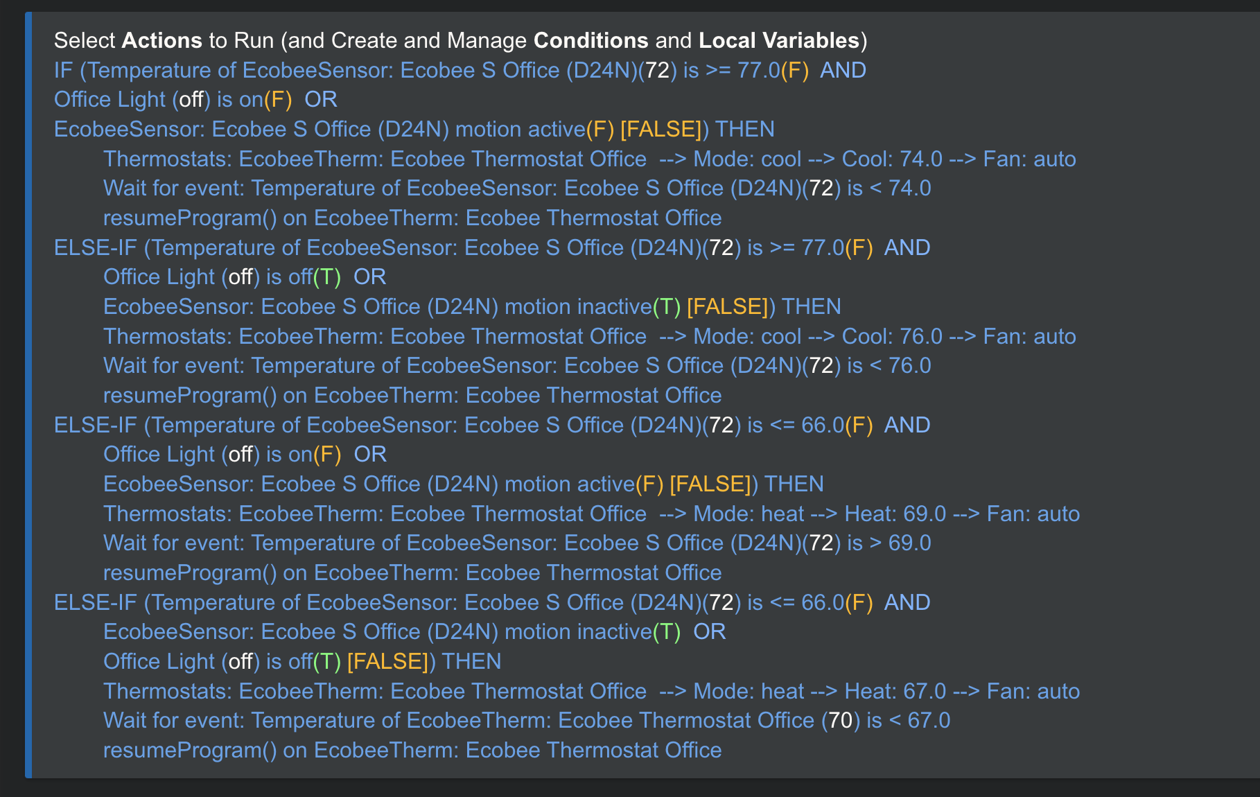

Should I add an END-IF or Exit Rule to the above rule?
With the way the rule is now, I don't believe you need it. I think it would only be needed if you wanted to add extra actions below those covered in the last ELSE block.

What do you have Events set to for all the Ecobee devices? I assume that you might have a separate sensor and thermostat judging by these screenshots? (I'm not all that familiar with Ecobee)
I would set these as low as possible while keeping rules and history functional (I.E. probably 2-3), there likely isn't a need to store dozens upon dozens of events.
Remember that each item is an event, so temperature would be one event, and if you are saving 11 events that equals 11. However many thermostats have other events like battery, humidity, heat setpoint, cool setpoint, fan and so on. So that 11 events balloons to hundreds when you have a few or even upwards of a dozen items generating events.

When I adjusted based on your post above, I noticed the exact level of events was 11...... which coincides with the event log. I have dropped this to 3 for testing and to see if we have another sever load issue.
