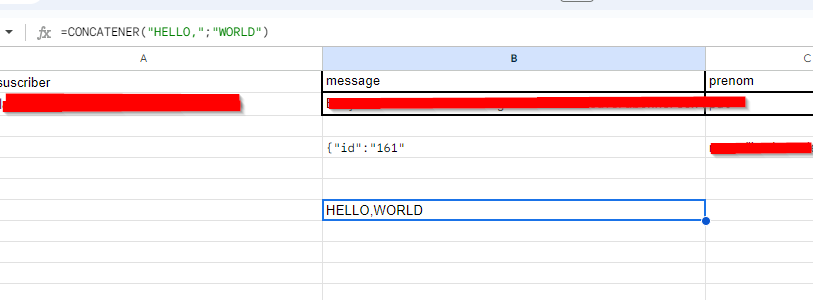

Thanks for this, but my connector is string type and I try to pass "hello, world" and its not working because of the coma, even if I use texte("hello, world";"") or TO_TEXT("hello, world"). Normally the coma inside string like this should be taken by the connector and set the variable correctly.
encode url for a coma? looks a little overkill and my @ is working well, its pretty weird.
I ll try it but the need to encode my coma in a string makes no sense to me!
its not working, the coma part of the concat() not there. Everything I try to pass works perfect without urlencode except the coma that is not working.
