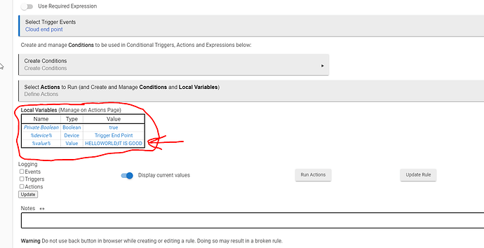

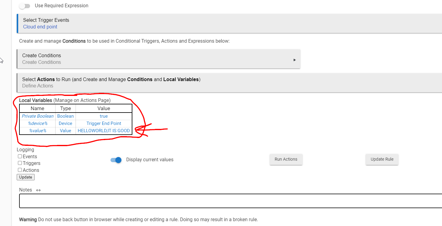

Sorry but I m not sure on how to do exactly, I just create a new rules with cloud end point. Now it ask to create an action, if if I choose update variable, I must select a variable to update. Is it the right way? In your url, its like we could specified the variable to update there setHubVariable=myVariable:example%20value?
So not sure if I m doing well!
Also, I see that I can create other variable from there, it looks like separeted from my other variable, what is the difference ?
Thanks again!
I should have missed something... it works but the hub variable not updating, but I see the content inside the rules... here my sheet formula (I merged all the stuff inside one formula) followed by the rules
it looks like it try to update a local variable...
