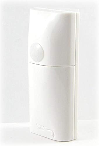

Depends on the location and what you are trying to achieve. By far the fastest sensors are the 2018 samsung zigbee motion sensors, Hue motion sensors are equally fast. For bathrooms I prefer the Nyce ceiling mount motion sensors since I can get humidity temp and motion from them. They work well for capturing motion in the shower and bath. Everywhere else I use the Samsung motion sensors.

NYCE sensors are amazing but very expensive. Reports temp and humidity as well.
Claim is they last up to 5 years.. haven't owned one that long yet though.

I use the round one that mounts to the ceiling. I don't have any experience with the other one. I went with the ceiling one because it uses triple-a batteries. The steam rising from the shower or bath triggers the humidity faster, and the motion sensor can peek into the shower from above or around the corner to the bath also.
Same reason I use that exact same device, in the exact same application.
Yeah I am using both for a client of mine. The regular sensor works great for things like stairs with landings etc - back is angled so you can mount it in a corner. The round ones I've used in closets for the most part but can totally see using it for regular rooms as well use given the wide area of detection.
