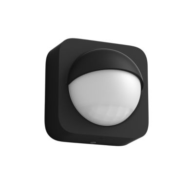

Haven't got one myself but I've seen these advertised. (Coming Soon).
I'm also interested in that one, barring any issues with reporting lux by itself (doesn't the Hue indoor motion sensor not send lux on its own, only when it gets a motion event? Or has that been resolved?)
My indoor one reports lux every 5 minutes, most of the time. Sometimes it might be 10 mins but I think that could be if the lux level has actually changed or not.

I got the outdoor sensor. Anyone have any ideas regarding lux reporting ranges? Right now it’s mostly cloudy outside and the lux is over 13000.
Is this a normal range?
I researched those at one point and IIRC they had a range of 0-64000 or 65000. That was when I learned there really isn't a standardized measurement for lux.
