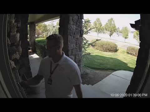

As for interfacing with HE I do have some automations setup that interact with my cameras. For example when someone walks up to my front door the camera recognizes that a person is there and triggers a rule in HE that switches the HDMI input on my TV which displays the video from my camera. It also triggers an Alexa routine that greets the person at the door.
There is a lot that can be done by integrating your cameras with other systems so I would highly recommend it.

in a bid for one up man ship - like the other poster, I too used a trigger event to tell the TV to display - but I took it farther - to picture in picture! worked great, heavy delay tho. in the end had to remove it as it triggered when cars went by on the street. (I used the camera triggers not BI). Now I just get up when someone knocks.... LOL.

I use the deepstack AI integration in BI so it only triggers when there is a person at the door.
