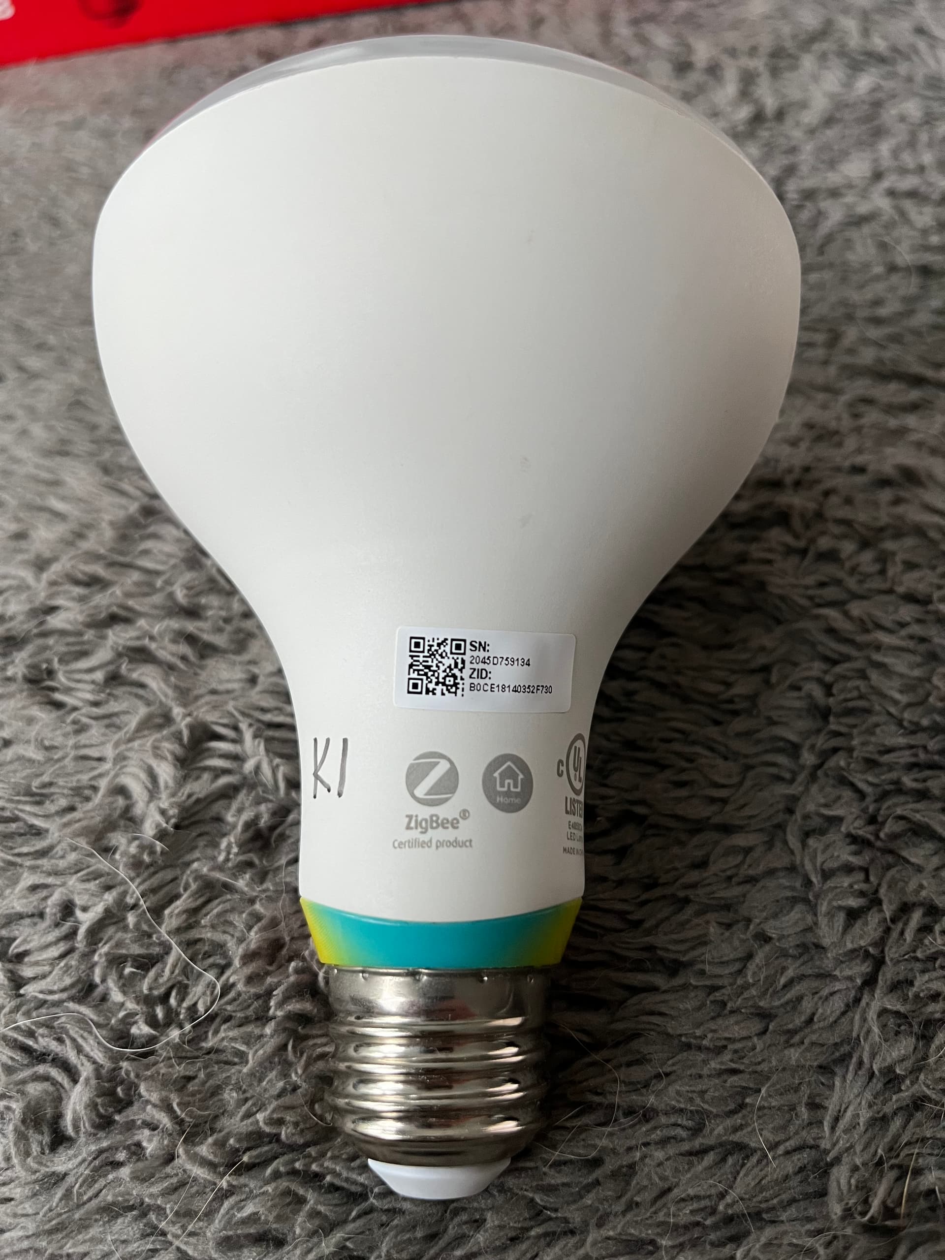

I have 23 of the Sengled Smart LED RGB lights (the BR series that looks like a floodlight). I pulled one of them from the socket and verified that they're Zigbee certified, so I bought the Hubitat Elevation C-8.

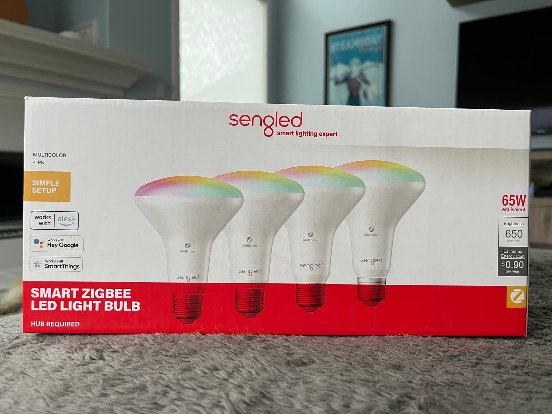

Can you start out by listing the precise model of Sengled bulbs that you have? And also their connection protocol?
Sengled made bulbs that used at least 3 kinds of connectivity protocols:
  1. Zigbee
  2. WiFi
  3. WiFi + Matter
Hubitat supports the first and third.
If you indicate the model number, we can help you figure out the rest.
Personally, I’ve used Sengled zigbee bulbs with Hubitat.
I suspect you have the third kind that use Matter, and need an Echo (or Apple Home hub or Google Home) to onboard them. And that may have been the message you saw from the Hubitat mobile app.

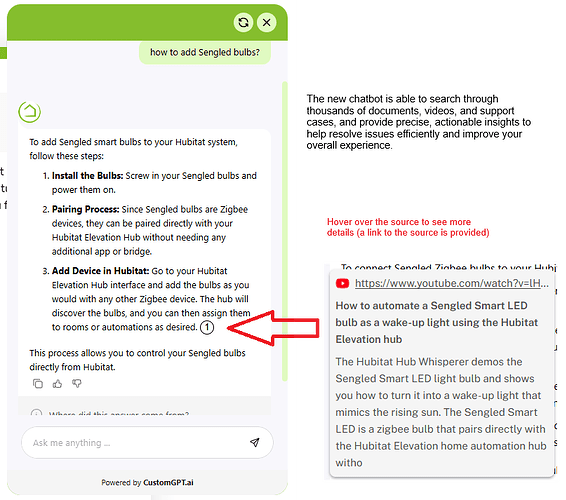

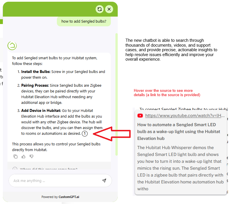

If you didn't check out our recently launched chatbot, you might want to give it a try [click here for more details]
