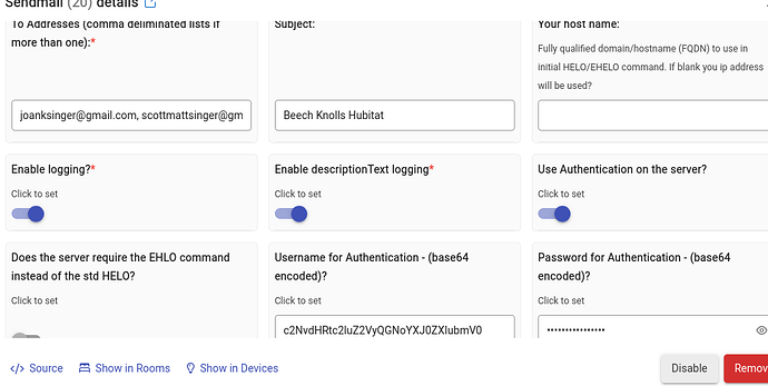

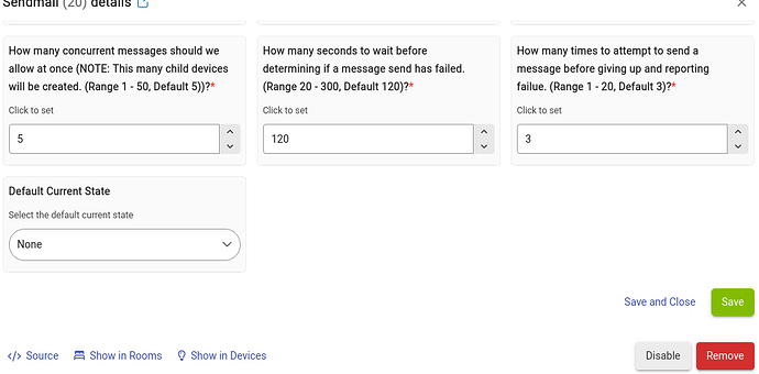

I'm new to HE and in process of migrating my set up from Vera. I need to be able send notifications via email. I installed LGK Sendmail device using Hubitat package manager but am struggling to successfully send a test email message from the device Commands page. I am trying to send email via Gmail smtp server. Logs seem to indicate that my request is timing out.
Google recently eliminated the "less secure apps" gmail setting which allowed legacy third party apps to authenticate. So maybe that is the trouble here?

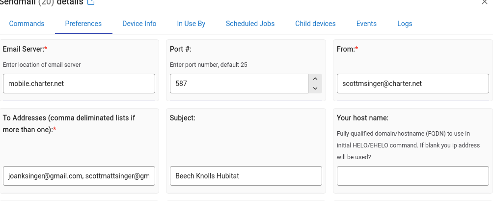

Screenshot of my Preferences settings:
Screenshot of Log:
Any suggestions would be appreciated.

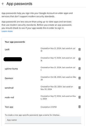

Is that the password for your Google account?
Or did you create an app password for this particular instance of Sendmail running on your Hubitat hub?
You need to do the latter for this to work. Read the instructions at this link on how to create and manage app passwords:

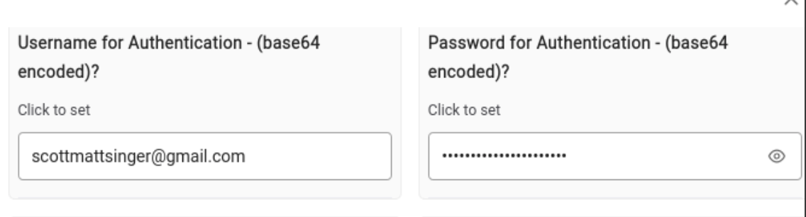

Also remember the User/Pass must be Base64 encoded (manually, by you) -
Your screenshot for the username is showing plaintext - See:
This has bitten me in the past.

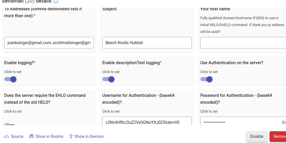

To eliminate google SMTP server as the issue, I substituted my ISP SMTP server, userid and pw. I also Base64 encoded login and password. No change. Same timeout messages in the log. Still unable to send an email. I must be missing something here.

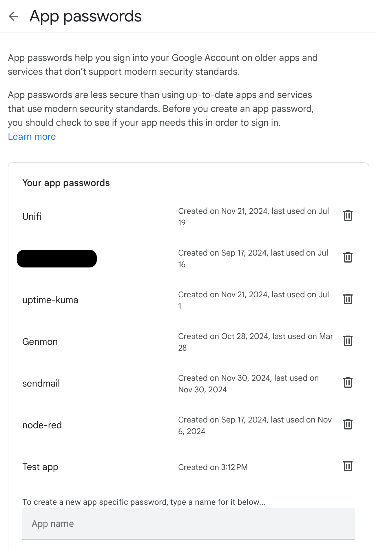

I can still create new ones .... I just made one 2 minutes ago as a test. Google does require that you have two-step verification turned on for your account before you can create app passwords.
Timeout message sounds like network to me - Either 587 or 465 is either getting blocked (via FW or ?), or these ports aren't open on the remote email server -
What I see for charter.net, also implies SMTP/25 is open - See: Charter Email Settings: POP3, IMAP, and SMTP Server Settings
I might also try using SMTP.charter.net per the above.
Finally, I would focus initially on connectivity, to avoid the timeout - Can you verify at least the 3way handshake via telnet, or CURL on 25 or 587 - Verify that you can at least connect to the port versus "Connection Refused", before working on SMTP HELO's, etc. - Try getting a working set of credentials/ports in Outlook or some other local client, that you can verify before transposing this into HE.
Just my suggestions on how to troubleshoot.
ya as mentioned it looks like it is not even connecting. .try telnetting on port 587 you should get something
ya that will not work hubitat does not support ssl or tls over telnet which is what sendmail is using and if you look at charters/spectrums docs they say ssl/tls must be enabled.
