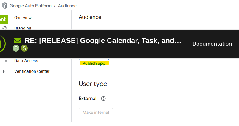

Be aware, the Google API screens have changed a bit since 2021 when this app was first made available. As a final step in enabling the Google API in this app, you will need to click publish on this screen:
You're welcome.
Post that change/update in the other thread. He'll be happy to update the instructions.

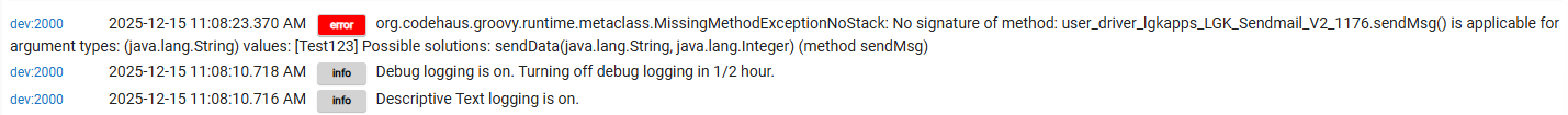

I posted recently that I was unable to send mail from the Device Activity Check app possibly due to ill-formed text produced by the app.
Now I seem to have a different issue sending even a test notification from the device driver ..
that has nothing to do with sendmail.. it is sending the content it gets verbatiom.. you would need to change the app sending the notification content.
Yes, that was my take on it as well. That’s why I posted that issue in Device Activity Check’s thread. I included it here only for context.

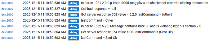

The second log listing is what I’m asking about here mainly. That comes from sending a test message from the driver.
i just tried both device notification and send message.. both worked.,. you must have an old version.. recommend you update,. at one time i only implemented one of the two send functions.
Indeed. Perhaps I got complacent depending on HPM. I was still on V2. I have now put V3 in place. That did resolve that problem, but now back to looking at the bare LF.
I'll post further in the Device Activity Check thread, but it could be the case that there's no interest in fixing it there since a bare LF doesn't cause an issue to other notification devices. Would it not be a simple fix to just not send a blank line since we know that to be an RFC violation?
