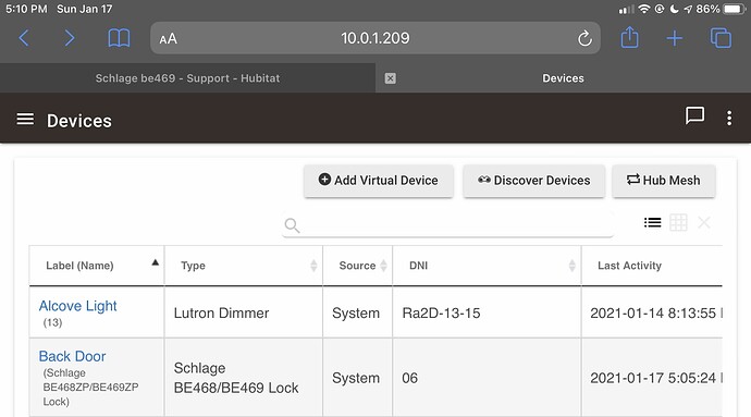

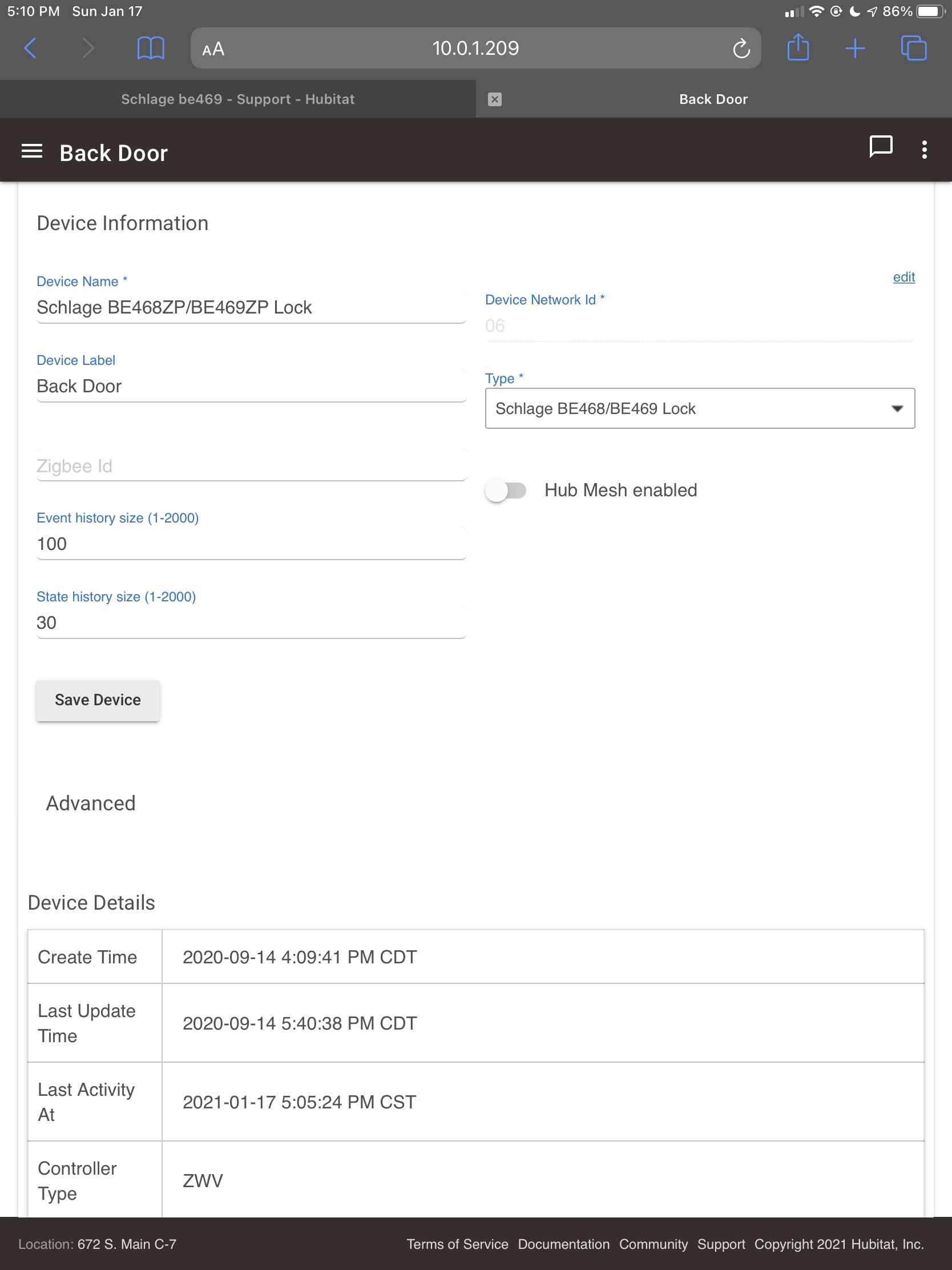

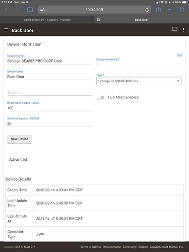

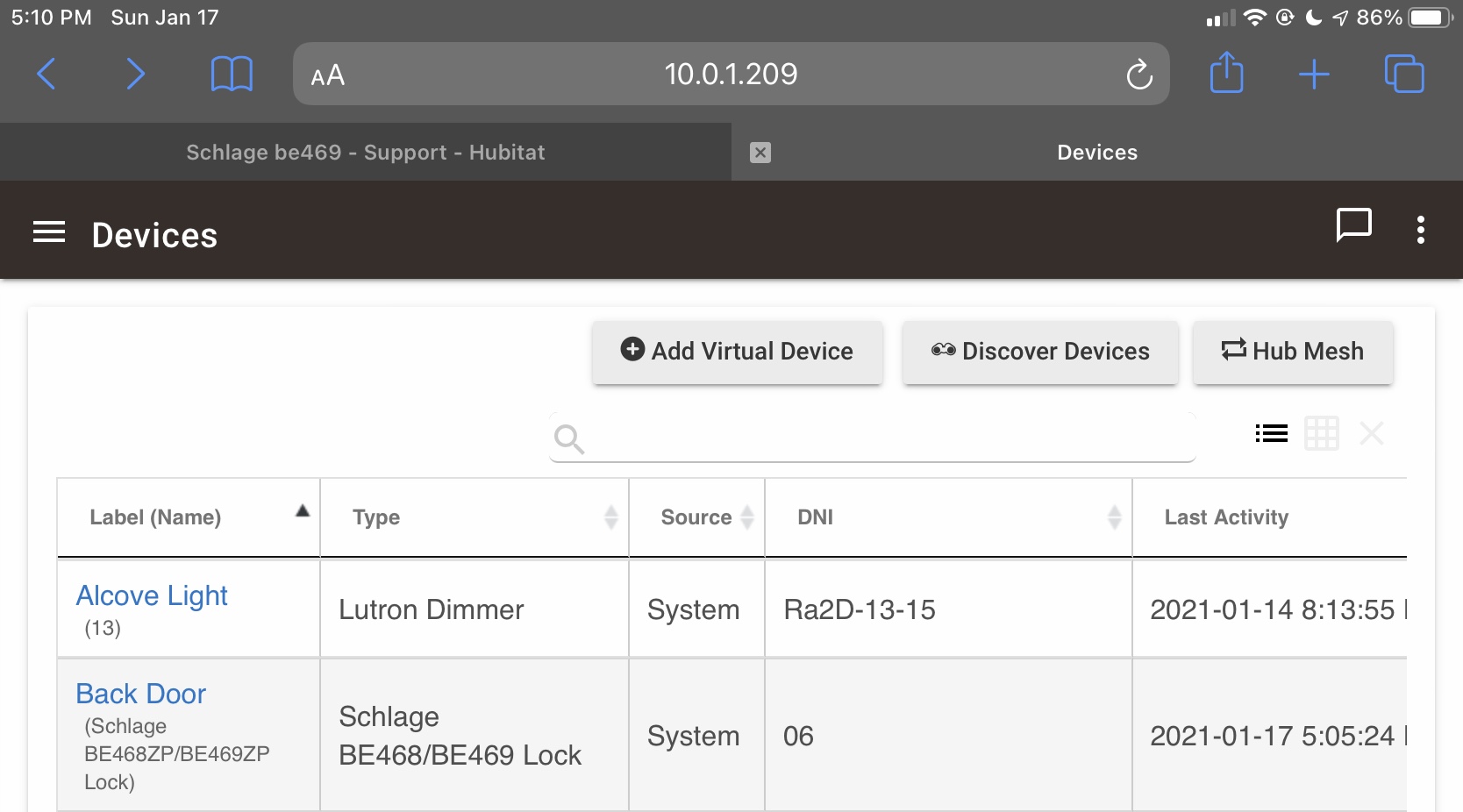

I got a new Schlage BE469ZP (firmware Ver: 0.10.9)
When pairing to HE it didn't pick up what it was which I thought was odd, and had to manually hunt down the listing for Schlage BE469
@bcopeland , @mike.maxwell - here is the fingerprint from my logs if useful:
2021-01-17 01:46:22.739 pm infofingerprint mfr:"003B", prod:"0001", deviceId:"0469", inClusters:"0x5E,0x98,0x9F,0x55,0x6C,0x8A,0x22"
Did you then change driver to built-in BE469, then save device, then hit configure?
There is a built in driver other than generic lock?
Yes, there is a built-in driver for BE468/BE469.
