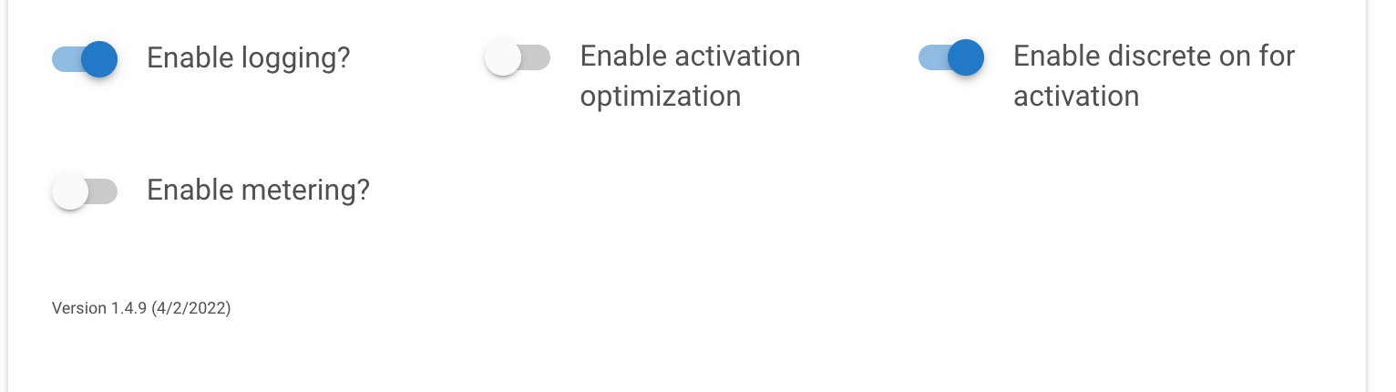

*Turn on “Enable optimisation”
*Turn on “Enable metering” and set to 1000ms
*Turn on “Enable discrete on for activation”
Now, I thought the last one would crack it but none of the above fixed the problem. Why did I think the last one was the solution?.....

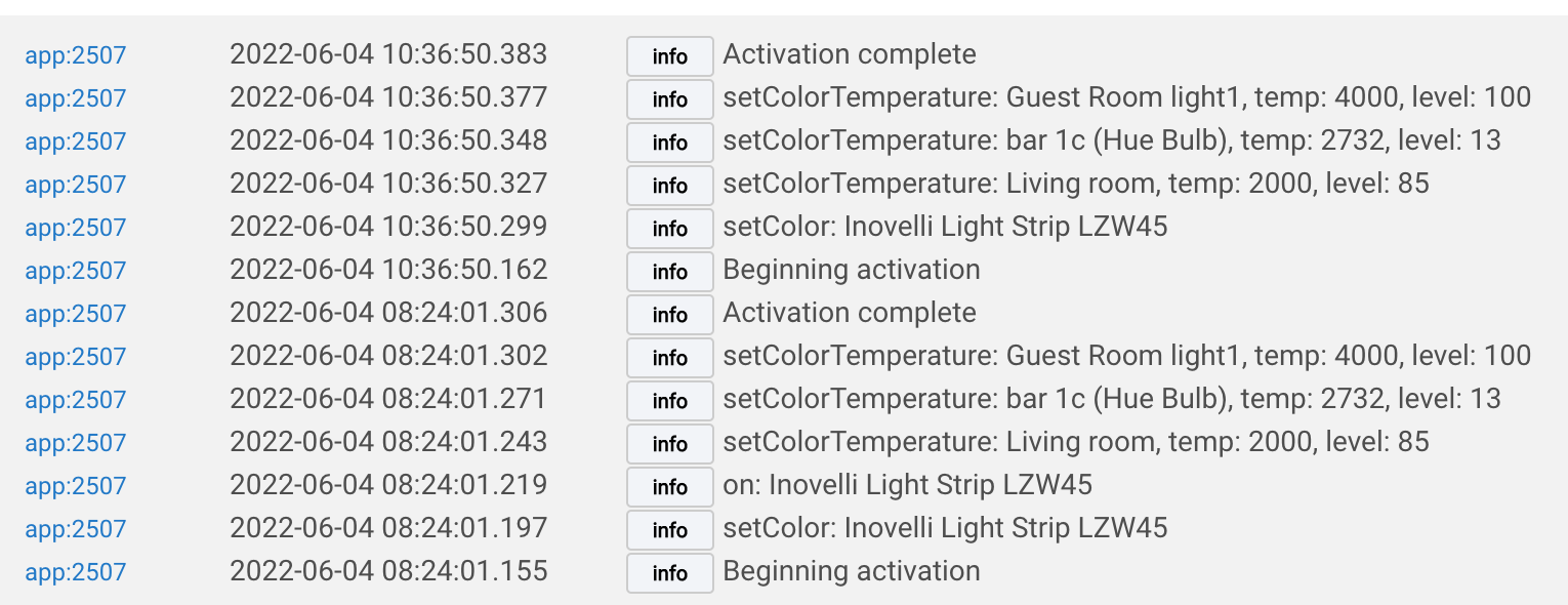

Here is the log from a Scene with Segled CT bulb, Inovelli RGB Lightstrip, Hue Bulb, and Hue Group:
The first activation the lightstrip was off and the on was sent. The second they were all on and no on command was sent.

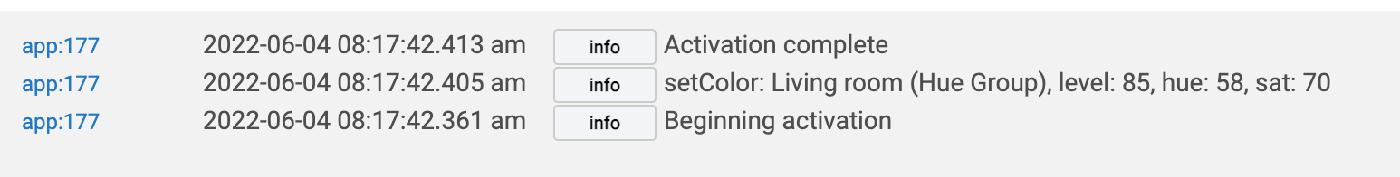

Similar with a scene with only one hue group (from CocoHue):
If only sends an On command if the device is off. It checks first. This is true irrespective of discrete on setting.

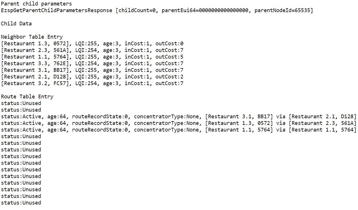

So I've tried changing channel and checking my Neighbour table, it looks okay, good LQI:
