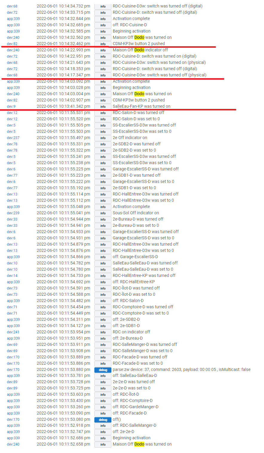

every night I press my zen32 button called "dodo" which calls a scene to turn all lights off (all zen72).
half the time I now have one light that does not turns off.
when I look at the logs, it appear that hubitat is smart enough to not ask a light that is already off to go off. GREAT! saves some useless zwave trafic.
when I look at my logs, I dont see the light that stayed on been asked to go off. then I manually turn it off and back on, then call the scene again and now it turns off.
so I really believe hubitat was simply out of sync regarding the status of that light (it though it was off when it was actually on)
how do I fix that?
so here is my logs:
at 10:11:52 (all the way down) I first press the DODO button for all lights to go off.
then we see all lights go off. note that the "RDC-cuisine-D" light is not listed in the logs
at 10:14:02, I press the button again. hubitat does not do anything as it thinks all lights are off. but trust me, my kitchen lights were still on.
at 10:14:17, I manually turn that light off and back on
at 10:14:32 I press DODO again and we see hubitat only turns off "cuisine" and nothing else
I had that occur with the basement and the bathroom

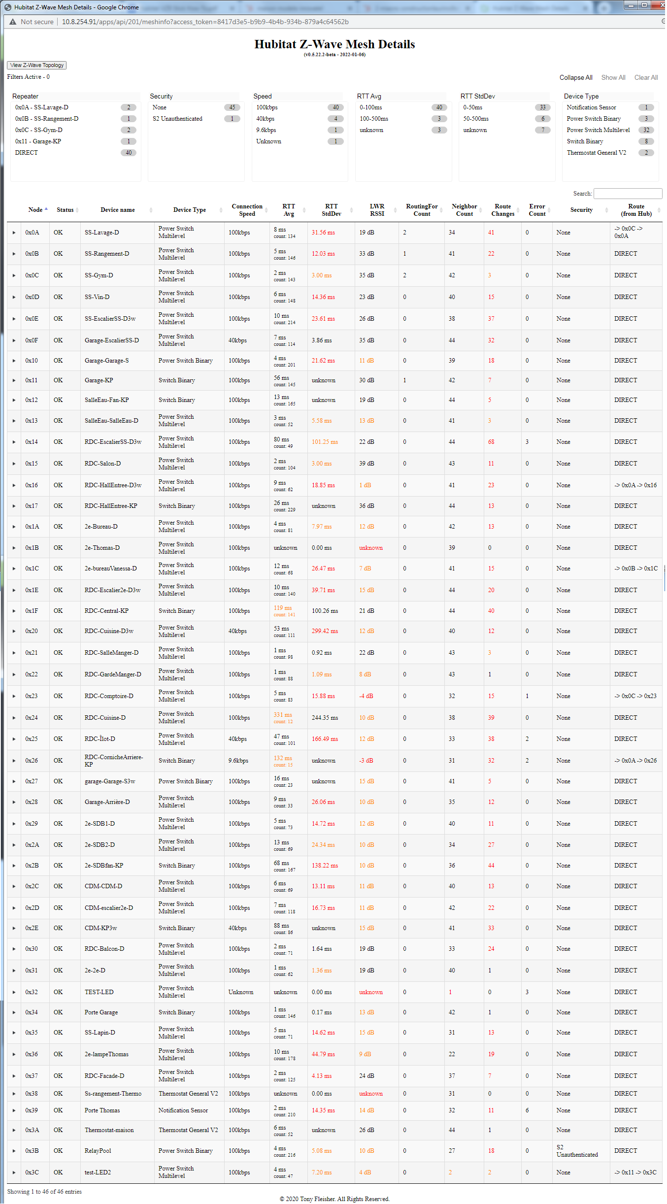

and since hub just got reboot, I dont have much in zwave detail page. but here is how it was 3 weeks ago (for what it worth. I didn't had the issue back then, but hopefully that can answer some other questions)
ill let the system wake up and post a fresh one in a few days
I have metal boxes
Can you post the native z-wave details page? Easier for me to read. Also shut down hub, unplug for 5 mins and power back up to reset z-wave radio

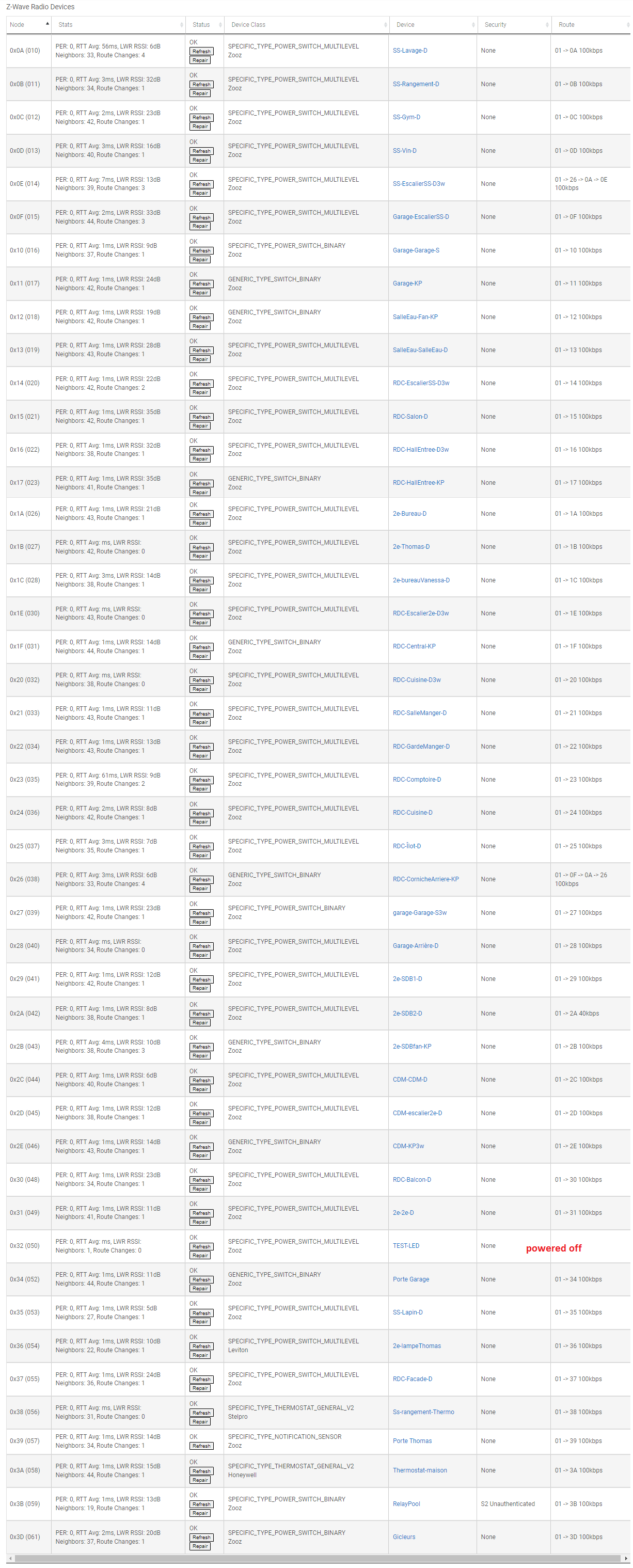

ok. so here is the zwave details.
I did not power off 5 minutes. all it did was reboot on its own after firmware upgrade. I can try a 5 minutes without power if you want tomorrow.
this evening, calling the all of scene left SS-Gym-D and 2e-SDB1-D on
thanks for your help!
Well you have that one powered off and it's a mains powered device. That will cause problems with your mesh because of things attempting to route through it.
I would shut down for the 5 mins (unplug at the wall NOT the hub).
Metal boxes can also inhibit signal somewhat. A beaming repeater near that light may help or @lewis.heidrick antenna mod. As I said though, that snipped of code isn't really a bandaid. If it works vs spending money on stuff it's a win in my book, lol.
Other than the one being powered down, your mesh looks pretty decent overall.
