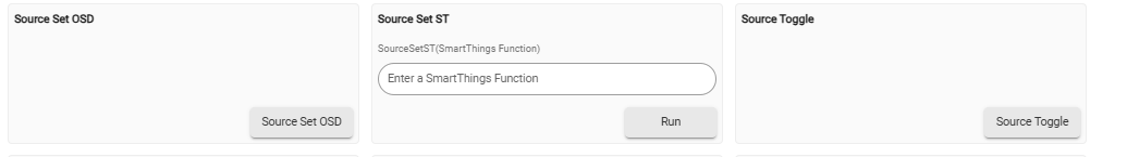

Is there a way to set a specific source ?
Yes, it definitely has that option.
This is from the commands page:
For more info, search this thread for the word source. Focus only on later posts.
