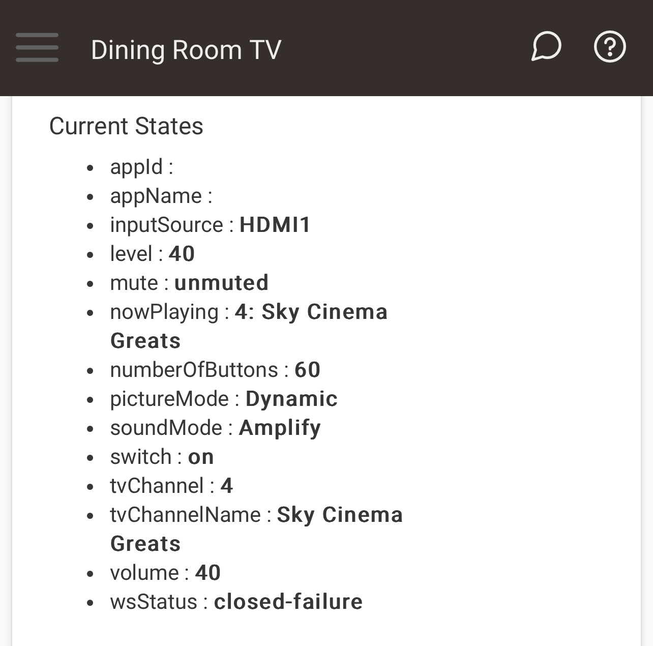

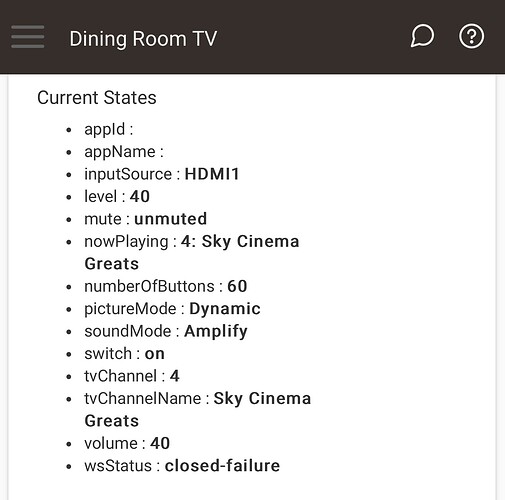

When I go to HPM, it tells me Updates are Available for this package. However, it says I have 4.1-2 installed, and that the current update is 2.3.9. This seems incorrect and thus I did not install the "update". Screenshot below.
Anyone know what is going on and how I fix this? What is the proper current version of the Samsung Hubitat TV Integration?
2.3.9 is the latest version mate, the numbering has changed to align with the platform version. 4.1-2 is the older version.

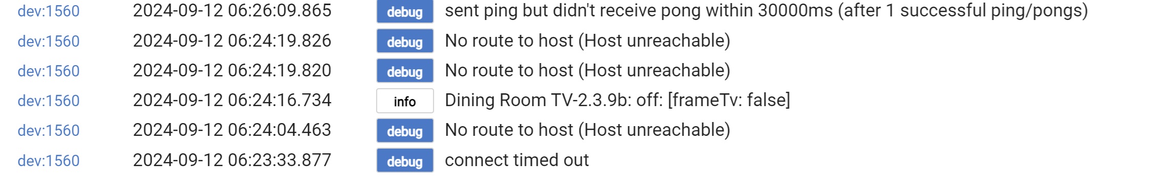

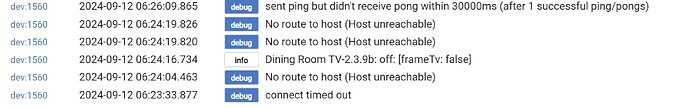

Is anyone else having issues with the updated driver? Since updating, whenever I send an off command, the first command fails and the second works, and last night the TV was off all night but the switch was reported as on. When I tried to refresh the device this morning, it failed to update the switch state, so I tried to manually open the web socket and refresh again, and the web socket failed.
Edit; I've resolved the issue by rolling the driver back to version 4.1-2

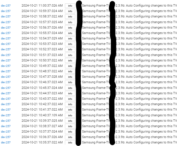

Looking at my logs, I see that something is happening with this TV in Hubitat every single minute, even when the TV is off. This never used to be the case, and I'd like to stop it. How do I stop this?
Below is an example (the black lines cover the personal info that is part of the device name) during a time when the TV is off:
@djgutheinz Hi - just wondering if you have any suggestions on how to stop this from running every minute 24/7/365...
Hello, I seem to have run into an issue lately where i can no longer control the off/on in 1.3.9 driver I seen where there was an updated driver in post 182 to seem to fix this issue is this correct? if so where do i find the latest driver 1.3.9.1 if there is one i checked with no success. Or would this be another issue on my part with the configurations? I to am getting the same logs as calinati above.
