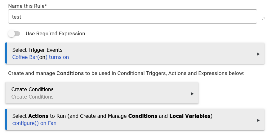

using Rule Machine, I set up (in several minutes) such a rule on one of my Kasa switches. See screenshot below. Key is the type of action on the development page is "Set Variable, Mode or File, Run Custom Action" on the Create New Action page. From there, pretty standard.

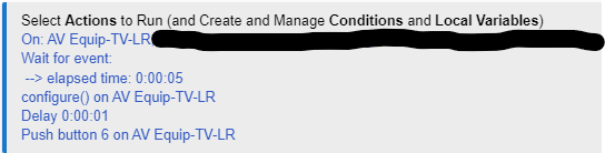

So to break it down even more for others who might be as befuddled by this as I was, in Rule Machine, I have a rule that, upon a certain trigger, turns on the TV. Then I have a Wait for event elapsed time 5 seconds rule to allow the TV to actually turn on.
To get the automation to then press Configure, I added a new action, as follows:
  1. Per @djgutheinz above, you select the "Set Variable...." option
  2. Select "Run Custom Action"
  3. At "Select capability of action device" you select "Button"
  4. Select your TV device from the dropdown of "Select Button devices to act on"
  5. At "Select custom command" you will see a drop down of what seems to be all the buttons on the Samsung TV device page!!!!! I selected "Configure"
  6. It also has a "Parameter Type" which I left blank.
    The above enabled me to have an Action in a RM rule just like @djgutheinz posted above!!
I entered a 1 second delay as the next action, then "Push Button 6" (Art Mode button) as the final action.
IT WORKS PERFECT!!!

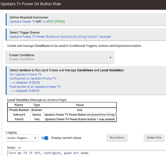

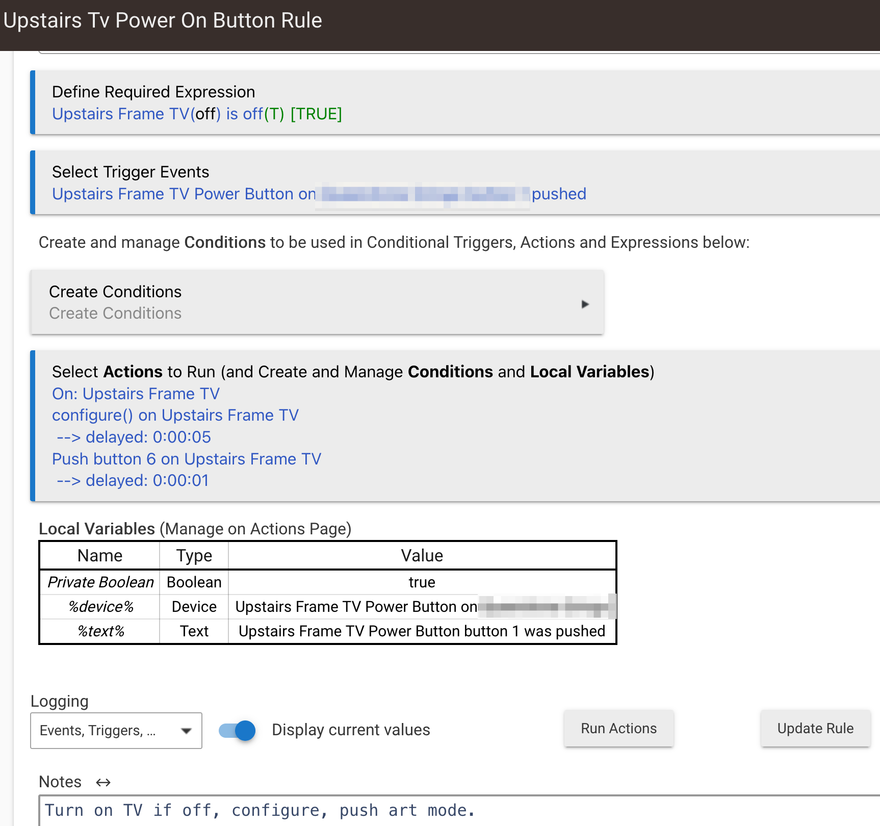

This is awesome. Could you post a screenshot of your rule?
Sure -
You need to add a trigger, then this is the balance of the RM rule. You get these per my instructions above.
Thank you! Just updated my rule to look like this, won't be able to test it out for a few days though.
I'm using delays on the actions themselves. Not sure if that is different or not from setting up discrete delays/waits like you have.

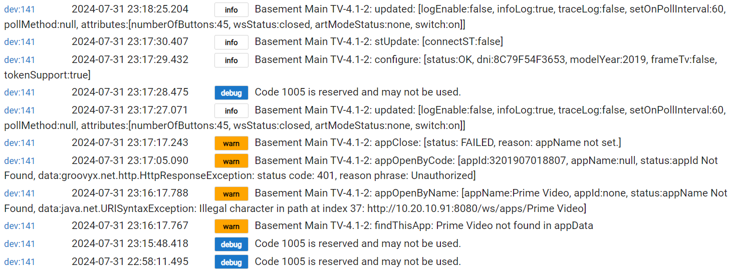

I'm sure I'm probably missing something silly but I have the driver installed, I have a 2019 Q60R. The Virtual Device has been created and updated the IP address for the TV I am testing with but I can't seem to get app to do anything. It does see the TV is on and reads some data from it, when I use the scan for codes it populated 45 buttons, but when I press most of the buttons I get the Code 1005 is reserved error, if I press the app buttons like Prime Video or Hulu I get an error saying not found in appData, but the apps most certainly are installed on the TV. I've never received the prompt from the TV asking to allow the app to work but some of the message details tells me it should be working.
