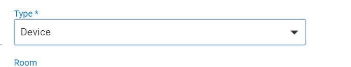

Looks like a Presence error with a Contact sensor, first thing to try is changing to the built-in Device driver and clearing everything.
Device
Then > Save Device > Configure

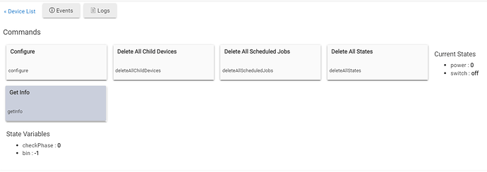

Click the Delete buttons:
Delete
And finally, restore the correct driver: > Save Device > Configure
