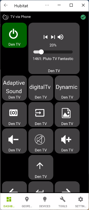

BTW, I created the below phone dashboard (three tiles wide and scrolling for other tiles. It requires some added attributes in the file for the music player to provide: channel/channeName, level control, and use prev/next track for channel up/down.

Dashboard: Finally, the new version has added attributes and commands to make the device compatible with the "Music Player" tile in Hubitat Dashboards. It allows volume and mute control plus the left/right at the top are channel down/channel up. Finally, when using the digitalTV source, it displays the channel and channel name. See example several posts up.
