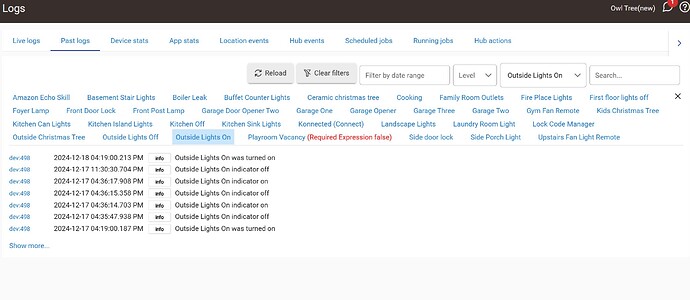

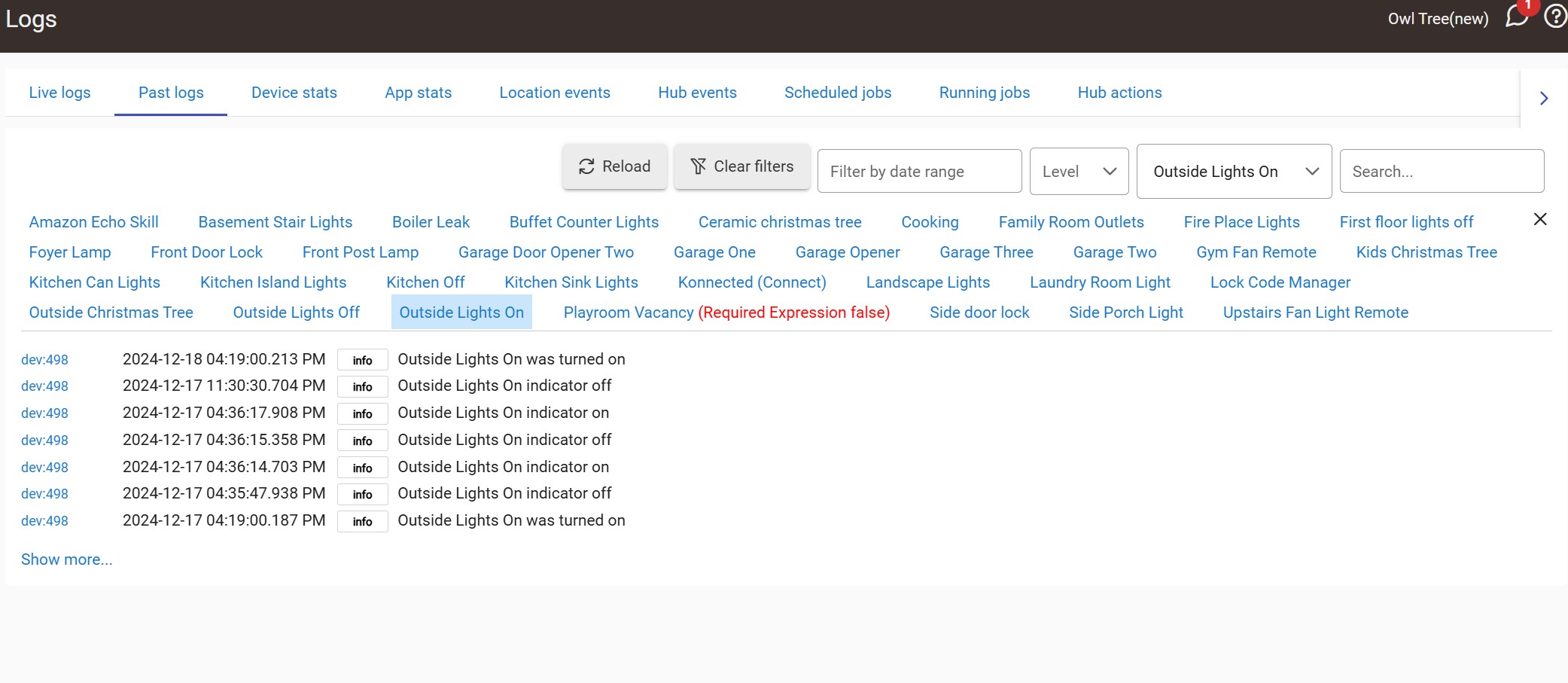

The first shot shows the log from the scene. You can see the scene logged on and off.

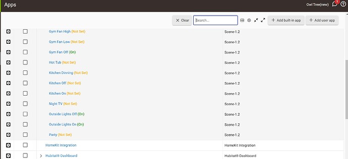

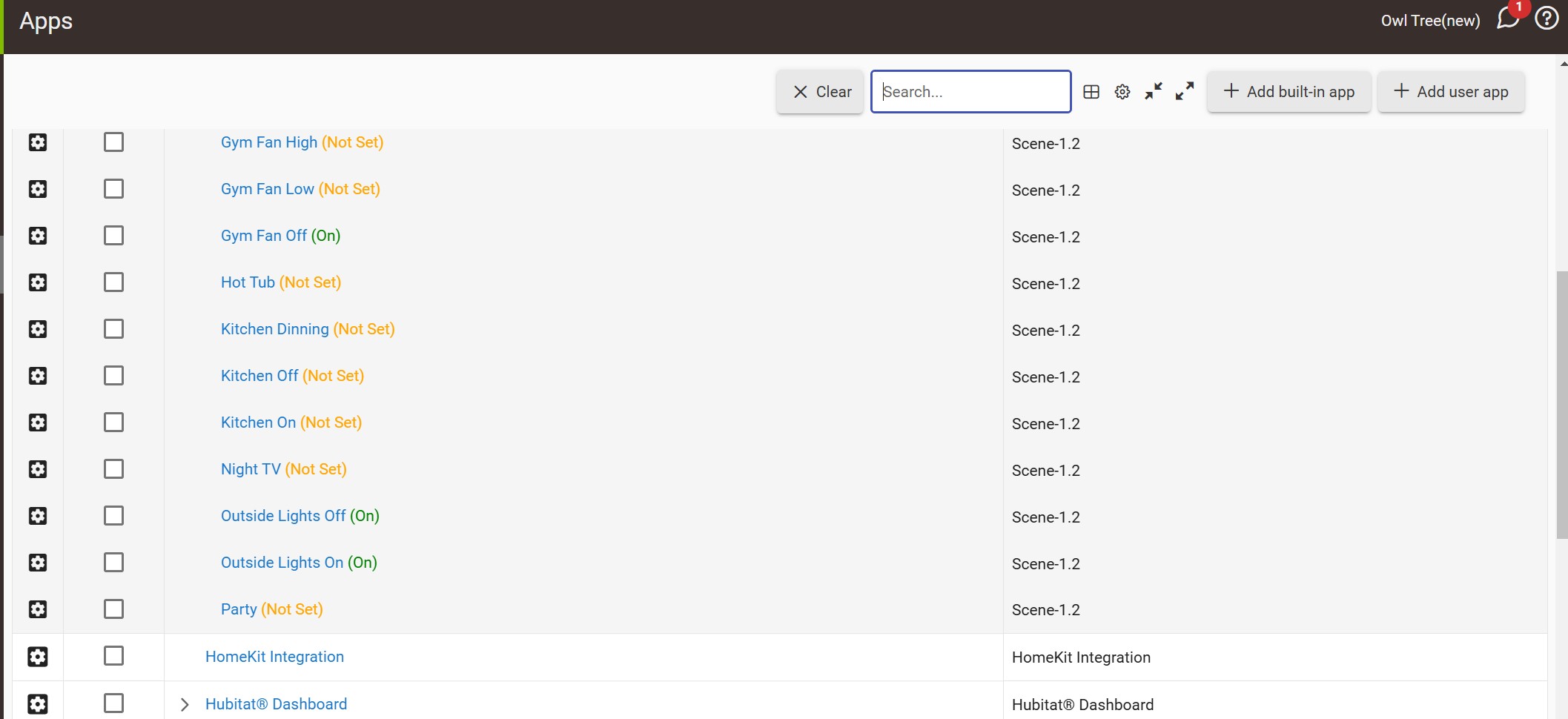

Note that after the Scene is logged on, I look at the Groups & Scene menu and see that both the Outside Lights on and Outside Lights off scene are "On"

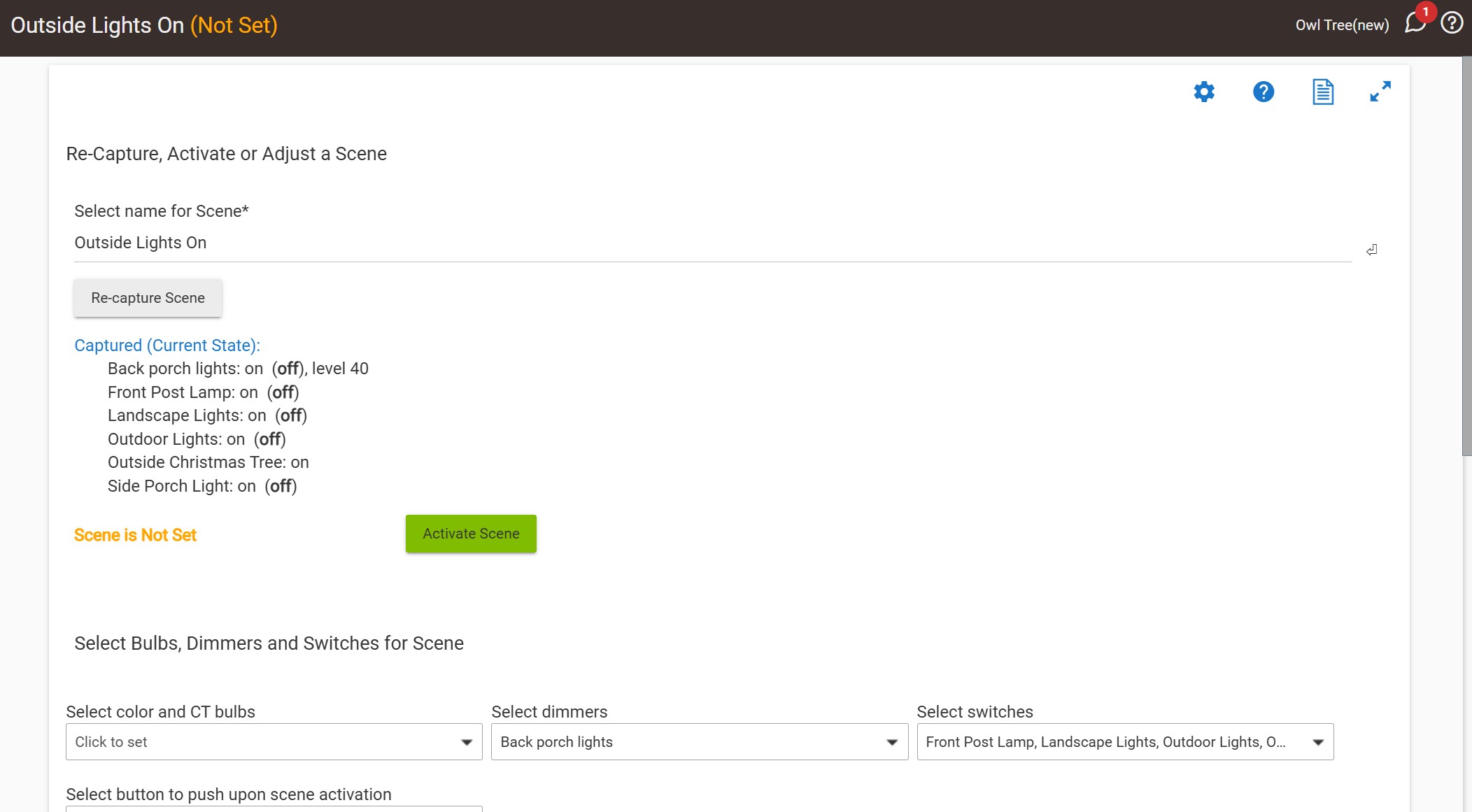

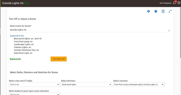

If I click into the scene, it shows the Scene is in fact not set. Why does the menu before say it is on?

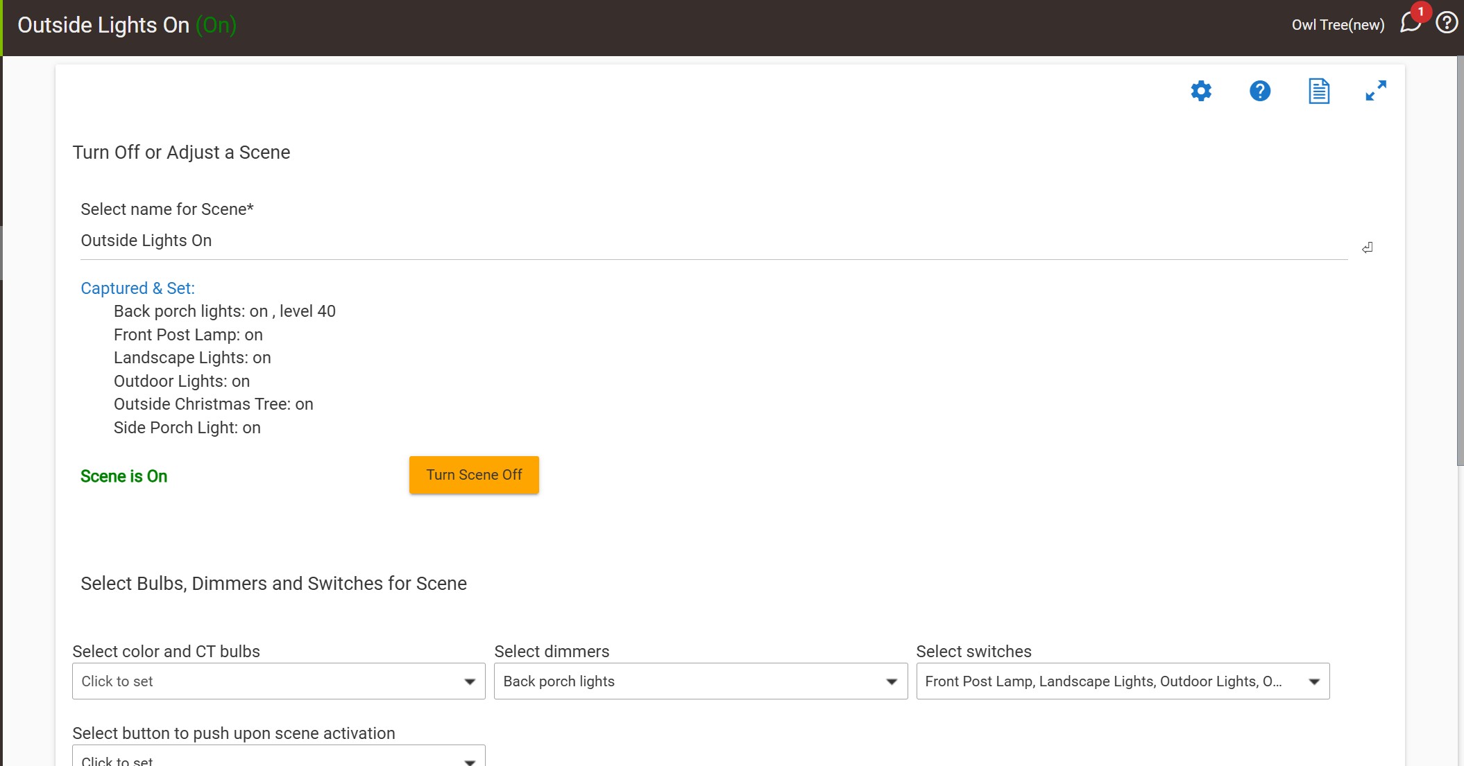

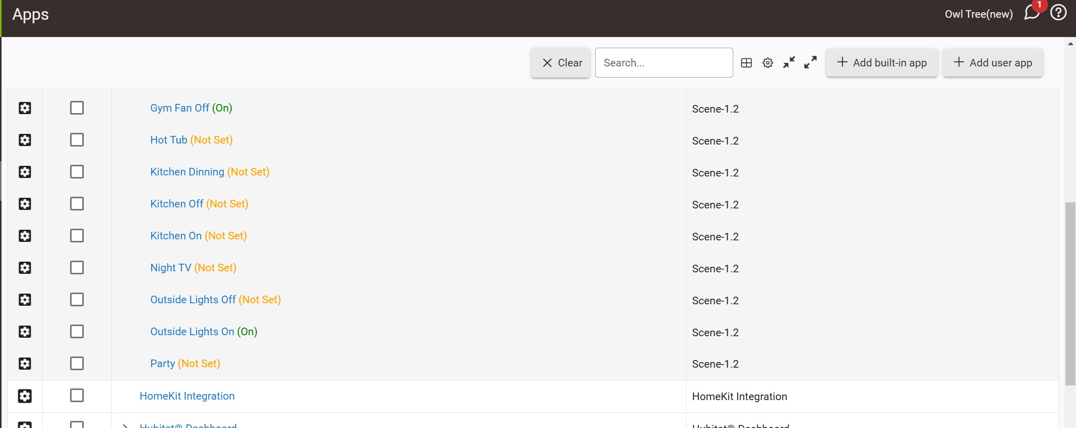

After I click the Activate Scene button, the lights come on.

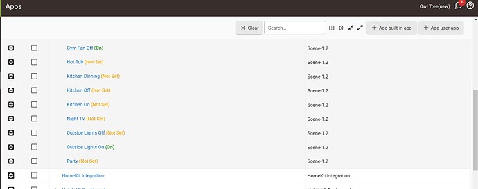

Now the Groups & Scene menu shows the scenes correctly.

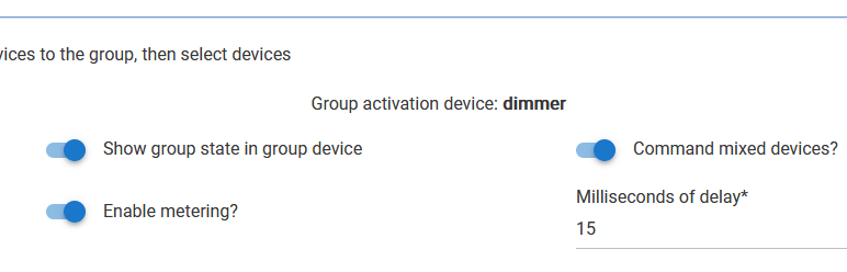

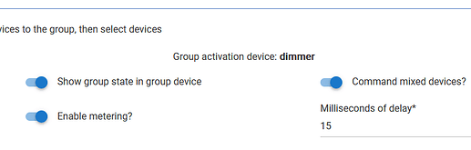

I'm sure its not related but i put a delay on all devices in groups - I've got 17 groups and I set a larger value the more devices are in the group. that stopped my problematic on/off's a long time ago. Maybe others might report doing this as well.
I picked up on the delay a while back from a previous thread. I have 50ms delay configured for the group. It's only 6 devices. Shouldn't be a big deal.
