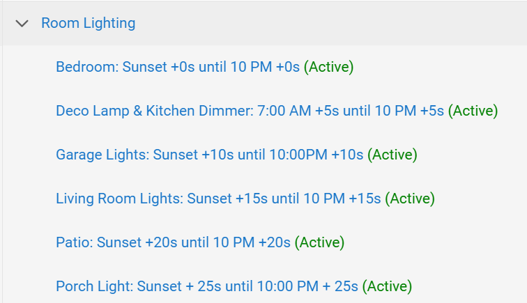

I had some Zigbee issue that caused me to pay really close attention to my automation routines. Those issue were resolved but I was still having issues with Room Lighting reliability that I think had been around for a while, possibly since I migrated to my C-8 Pro in the Spring.
It would be very hit or miss as to whether or not any given light would turn on or off. I'd say the success rate was about 60%. What was consistent was that if I went into the app and clicked the Activate button they would always work. I tried a few things including moving everything to Rule Machine with a similar outcome.
But what did work was this:
I added a small offset to each of the Room Lighting instances for both the Activate and Turn Off conditions. Since doing that (3 days ago) none of my lights have missed a single command which has not happened for months.

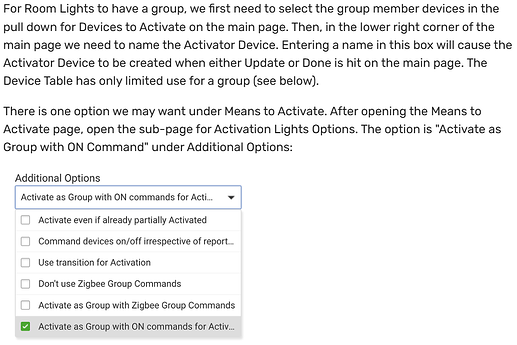

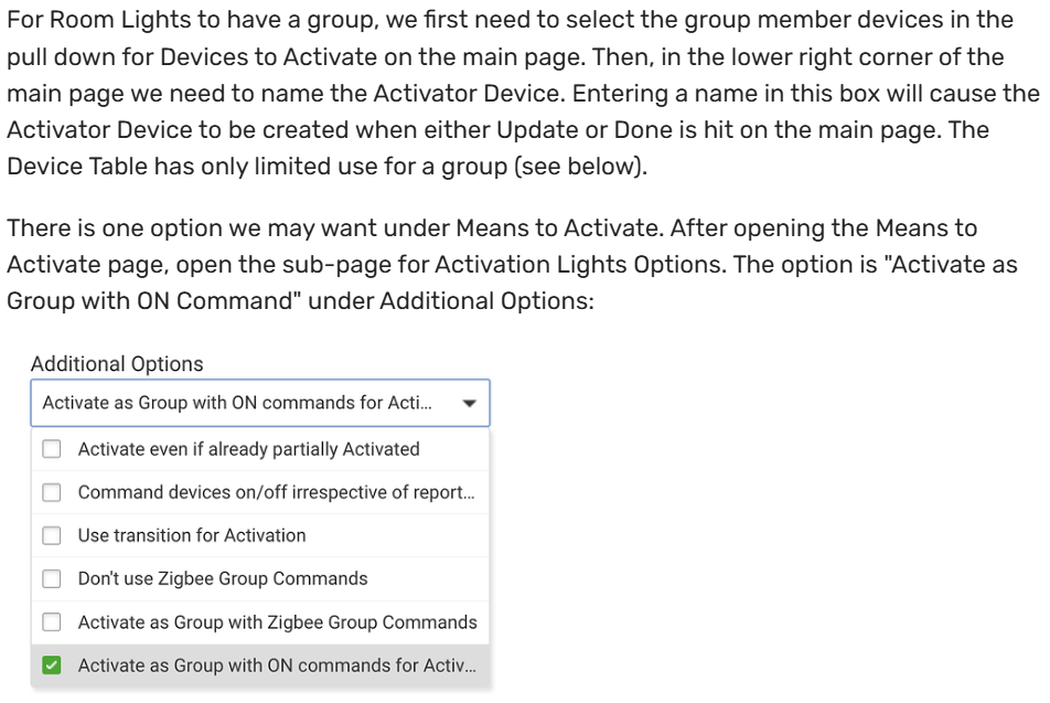

It's been a while since I've seen that option. I was aware of it and looked through Room Lighting to see if I could find it and try it out, but never did find it.
The advantage with group messaging is one command is broadcast to control the members of the group, vs one discreet command per device being controlled.
This is generally the best way to control a large number of zigbee devices for a goodnight routing ect.

I have zigbee groups with as few as two devices in them, simply for ease of management within apps.
In any event try it and see if there's any reliability improvement.
