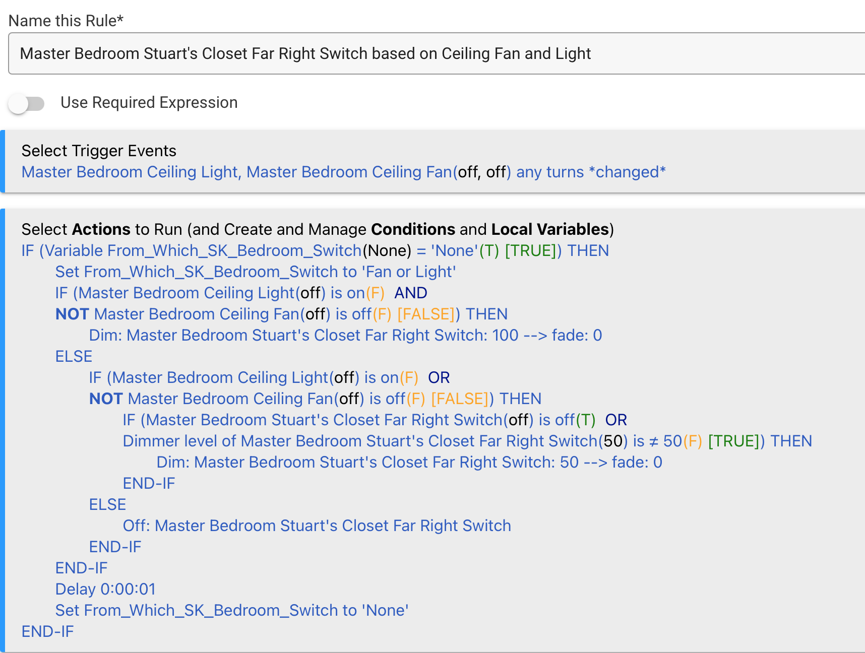

Here is the rule for when I push either the Ceiling Fan or Light switch which runs whenever the ceiling light or fan is changed.

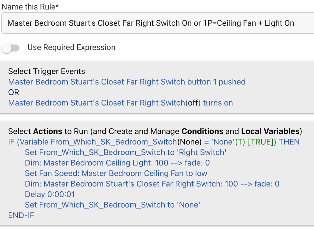

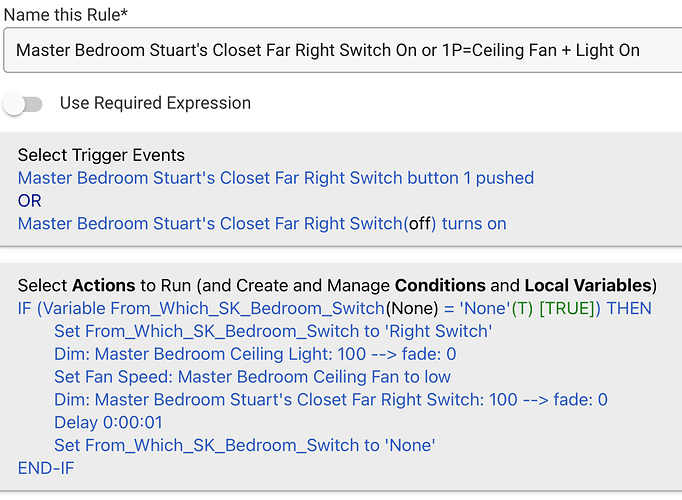

Here is the rule when I've either turned on the Ride Side Switch or Push button 1. Although that seems to be the same thing, it was needed to put both in to get it to run from both the physical switch and the dashboard.

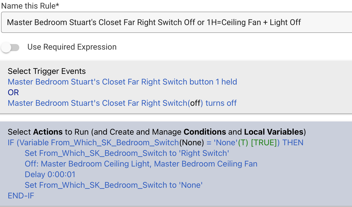

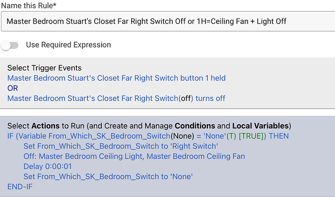

Finally here is the rule when the Right Side Switch is turned off. Again, both triggers are needed so it works from the physical switch and a dashboard.
