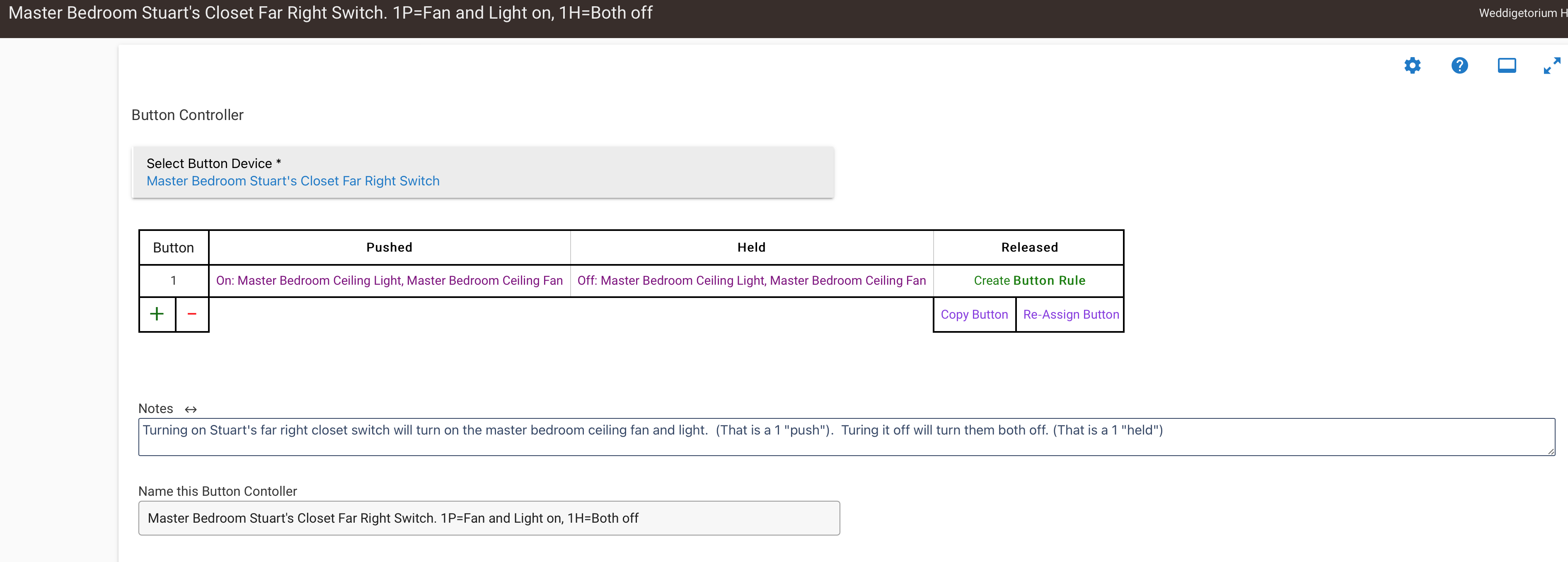

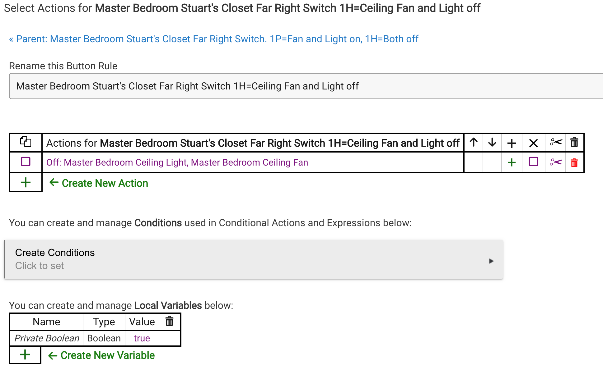

Here are some screenshots. The first is an overview of the red dimmer on/off (1 pushed/held) rule:

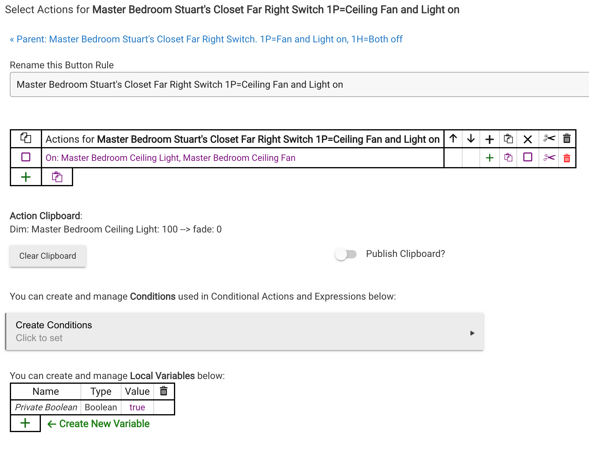

Here is the rule for the red dimmer to turn the fan and light on (The red dimmer is the Master Bedroom Stuart's Closed Far Right Switch).

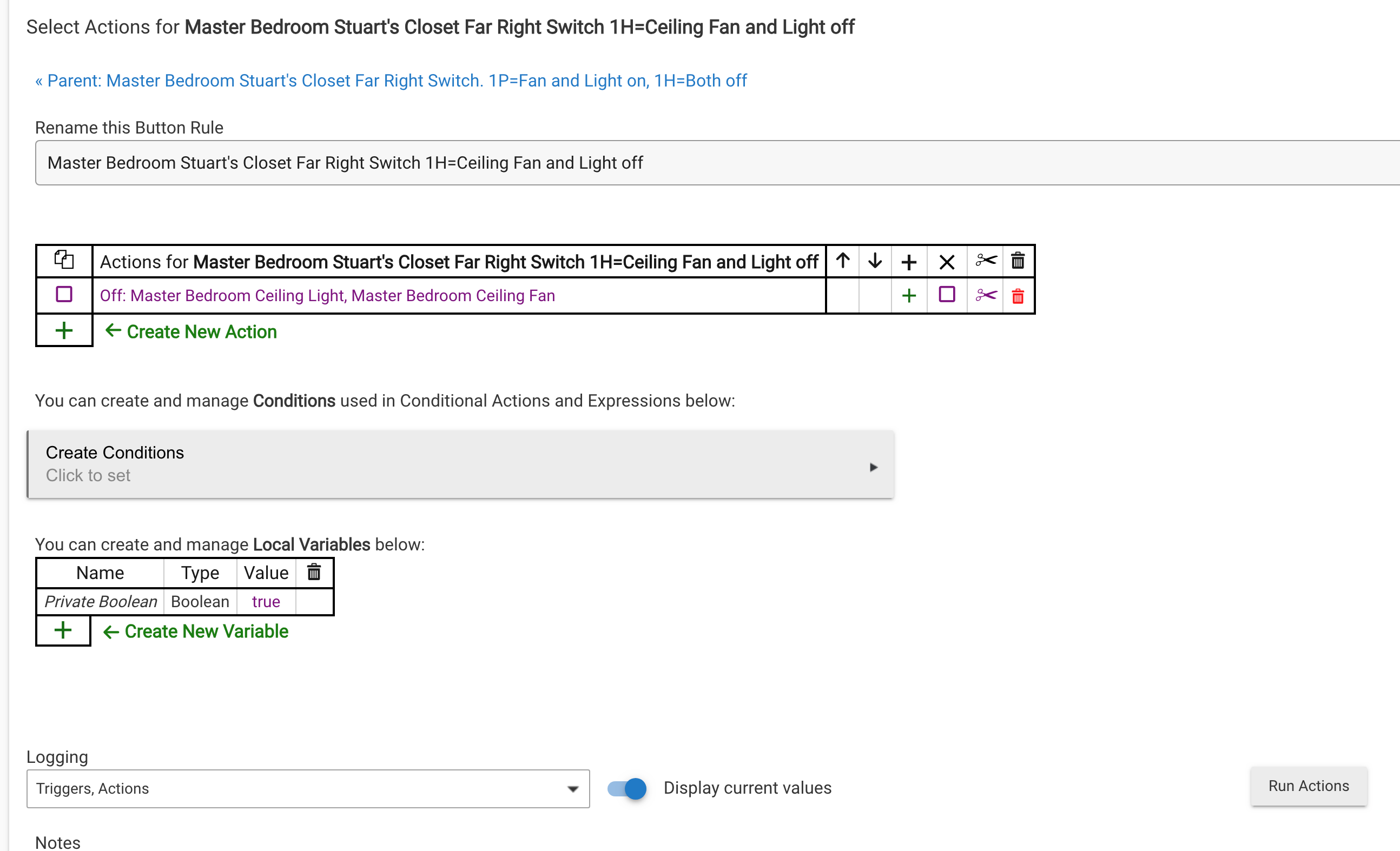

Here is the Off rule

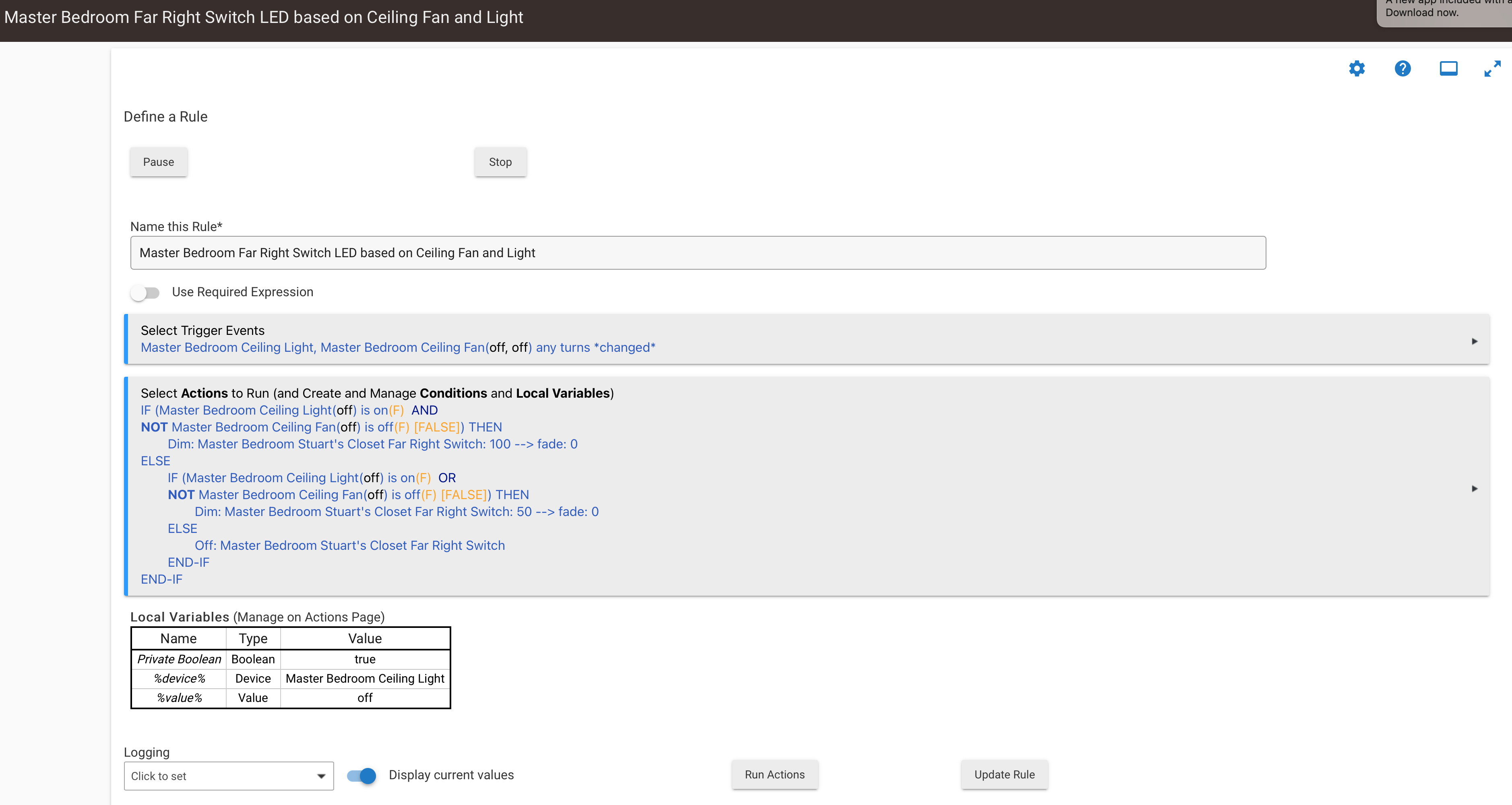

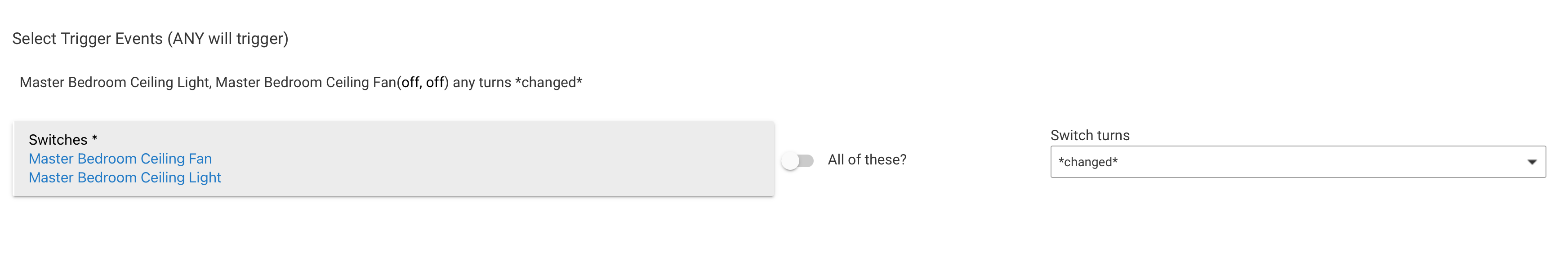

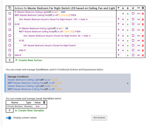

Here is the Rule Machine rule.
First here is the trigger: (Either the fan or light changes)
Here is the rule itself (BTW, I had to use NOT Off as I found I couldn't use "On" for the fan. It doesn't know that if it is set to low, medium, high, etc. that is "on"). The rule is If both the fan and light are on turn the red dimmer to 100%. Else If either is on turn the Red Dimmer to 50%, Else Turn the red dimmer off.
Here is another view, in case this one is easier to read:

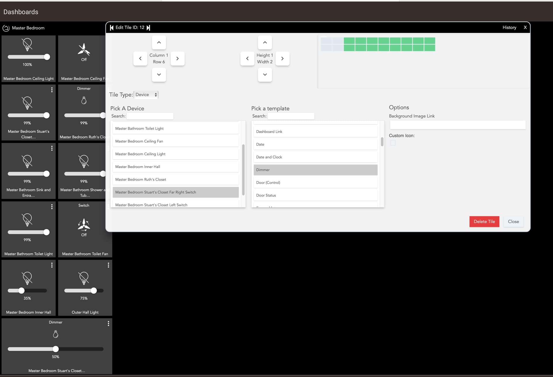

Finally, here is what the dashboard tile looks like for the red dimmer:

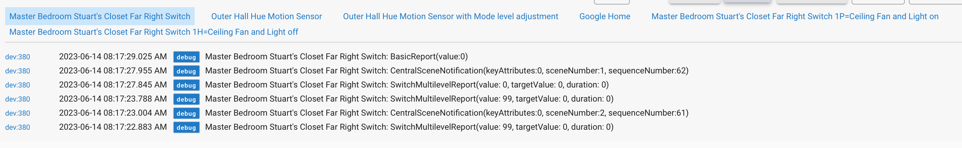

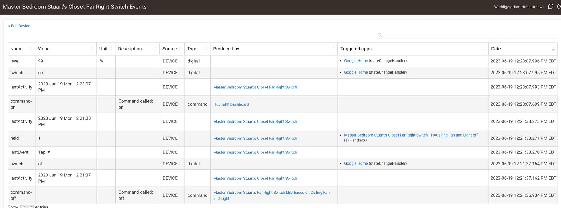

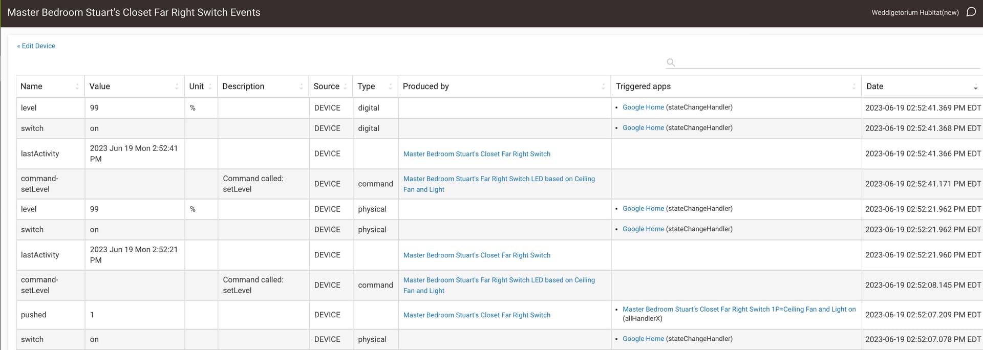

I tried an experiment and turned the red dimmer off from the app. The LED on the red dimmer went off, but, as expected, neither the fan or light went off. I then pressed the physical switch on the red dimmer, and this time it did shut off the fan and light. That made me think that maybe the dashboard was controlling just an LED child for the red dimmer. However, as you'll see from this screen shot there is no child created for it. (BTW, I included in the screenshot a red dimmer that has a child so you can see it would show up if it existed):
I then created 2 screenshots. The first is when I use the dashboard to turn the red dimmer on and off (since it is in last-first chronological order the top one is off and the bottom one is on).
Now here is a screenshot of the same on/off from the physical switch. As you see, it is not only showing more commands, but the On/Off rule I created is showing up. It seems that is significant, but I still don't know how to fix it.

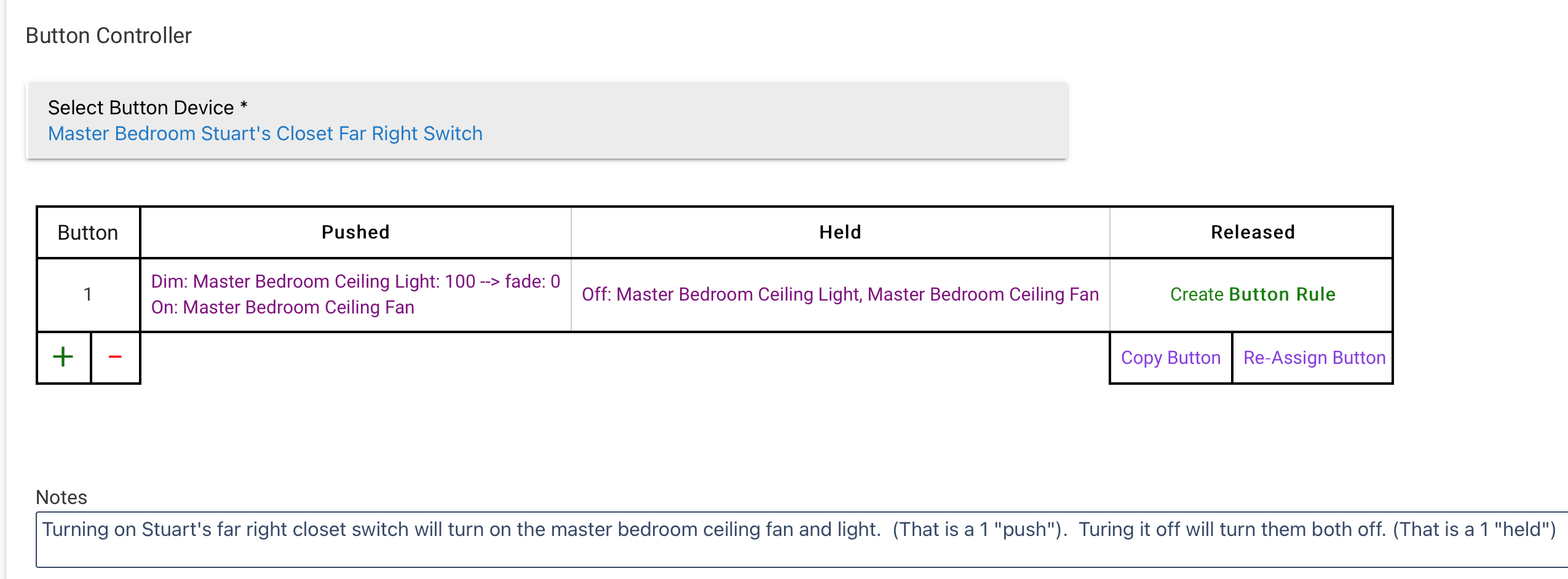

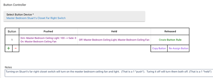

He is the Button Controller rule for the Inovelli Red Dimmer, called Master Bedroom Stuart's Closet Far Right Side. It does turn on both the fan + light when I do a physical 1 "push" and turn them both off when I do a physical 1 "hold".
I want the same thing to happen when I use the Dashboard button to turn that switch on or off. All my other dashboard buttons work being set up this way, but this one doesn't.

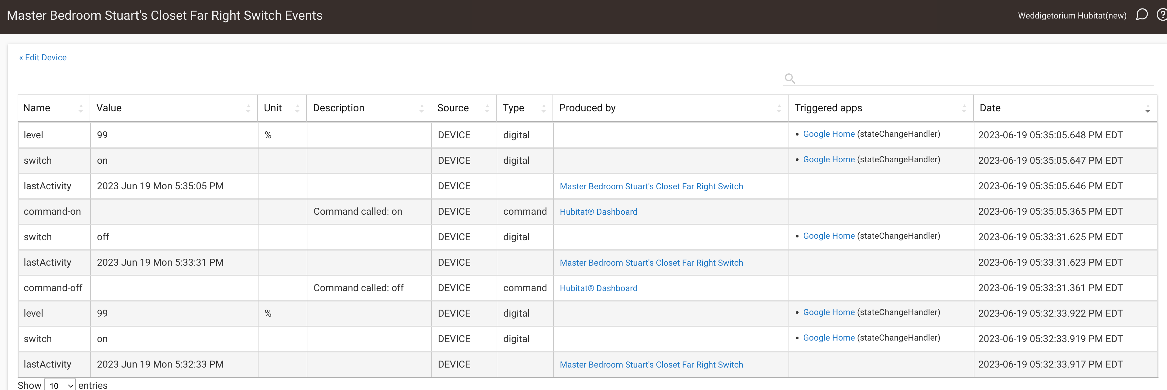

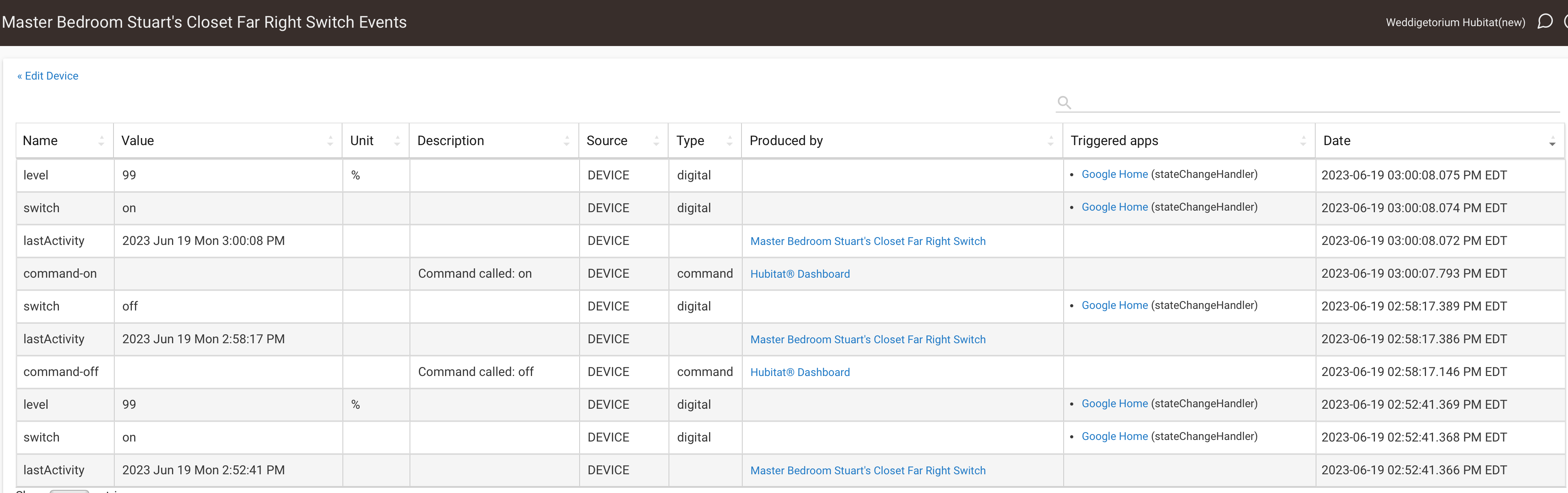

Here is a screenshot of the events page when I push the button to turn it on my Hubitat dashboard:
Here is the screenshot of the events page when I push the bottom to turn it off on my Hubitat dashboard:
What does the app that isn't working in response to this event look like?

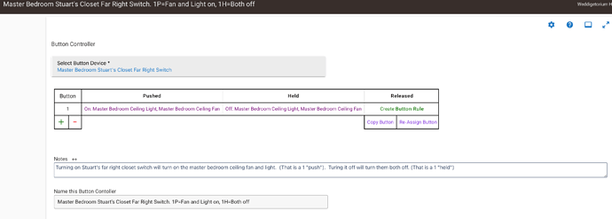

Here are 2 views of it.
Based on the device names, I would not expect that rule to trigger from any events in the previous screenshots (showing events). What do the events look like from the devices that are supposed to be triggering this rule?

The rule says if I turn on or off the Master Bedroom Stuart's Far Right Closet then turn on or off the Master Bedroom Ceiling Fan and Light. When I use the dashboard to turn that switch on or off I see the LED go on or off, but neither the ceiling fan light nor the fan go or on off. But, then if I push the physical switch the fan & light both will go on or off as they should.

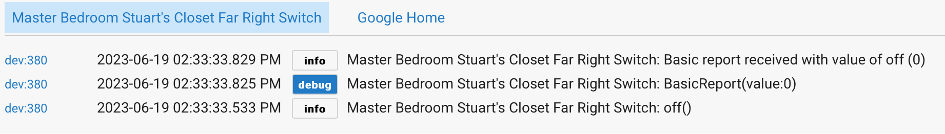

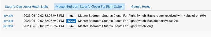

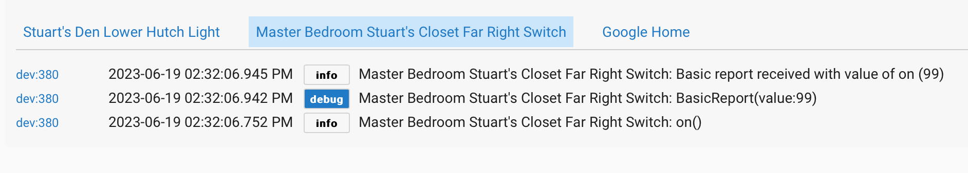

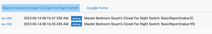

I turned on all logging for the Master Bedroom Stuart's Closet Far Right Switch, saved the preferences and saved the device.

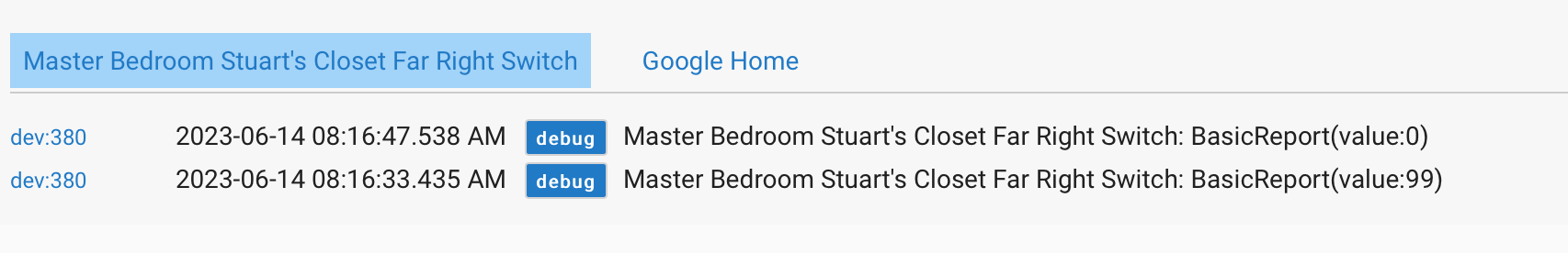

Here I pushed the button on the dashboard to turn it on:
Here I am turning it off:
Doing that does turn the LED on or off, so it is working to that extent. But then why doesn't that then turn the Master Bedroom ceiling fan and light on or off per this rule:

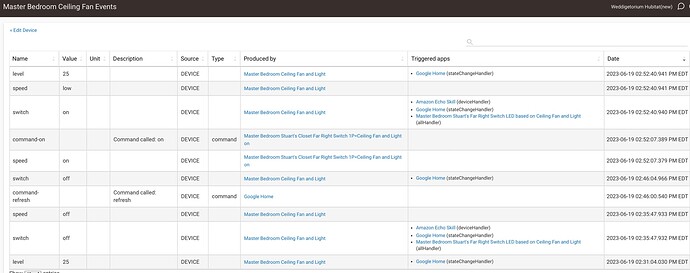

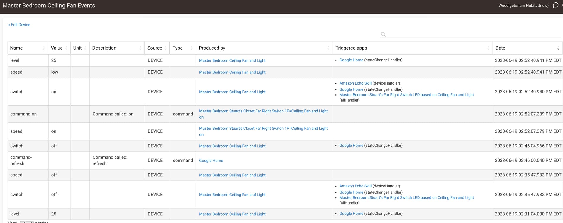

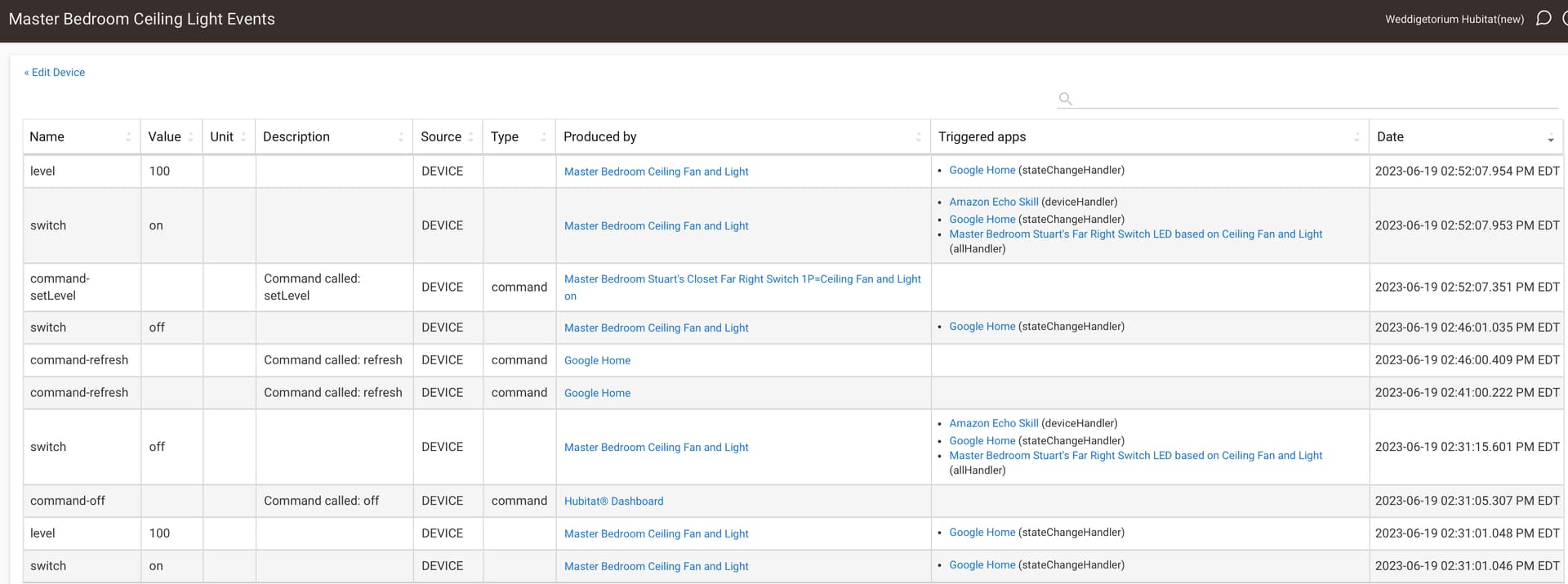

OK. Give me a few. I'll take screen shots of the events for the ceiling fan and light.
When I push the Master Bedroom Stuart's Closet Far Right switch from the Dashboard no events are generated for the ceiling fan light or switch.

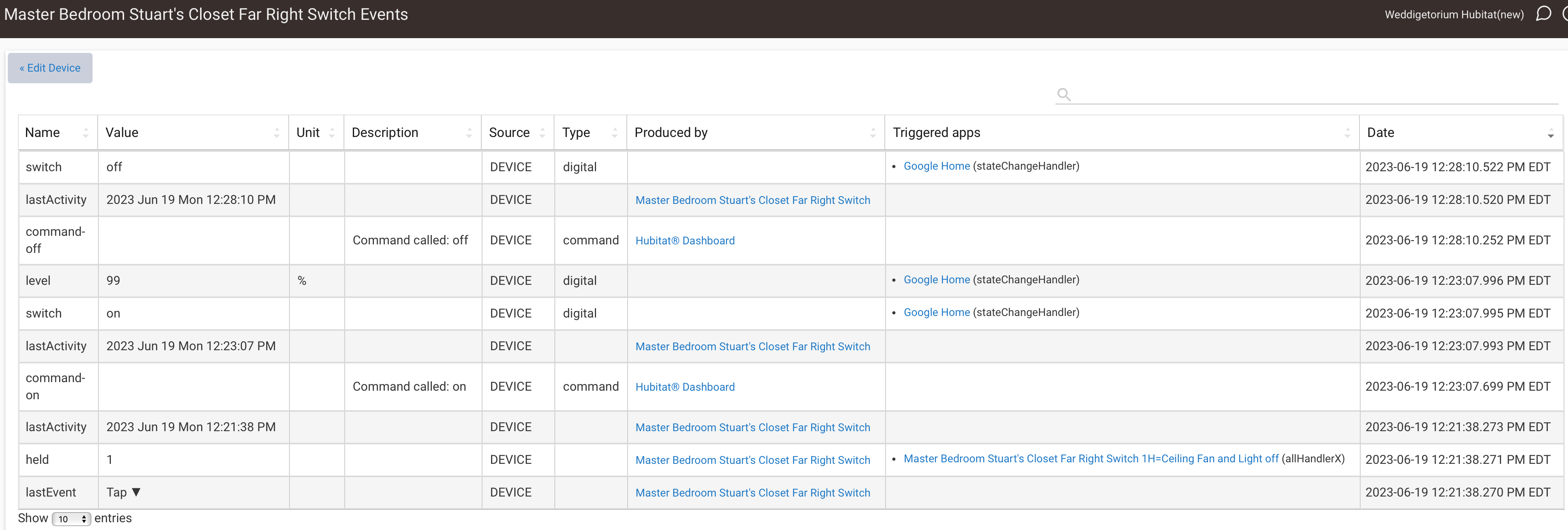

When I push the Master Bedroom Stuart's Closet Far Right physical switch here are the events it generated for itself:
And here are the events for the fan:
And here are the events for the light:
Finally, once again, here are the events for the Master Bedroom Stuart's Closet Far Right switch from the Dashboard:
OK, so based on those, it looks like the rule should have triggered -- there appears to be a matching event. One possible problem ruled out. :slight_smile:

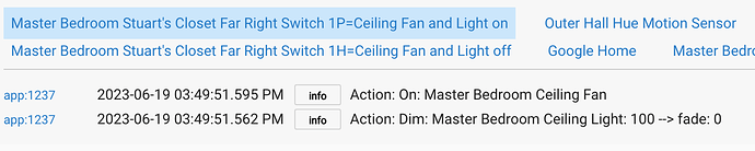

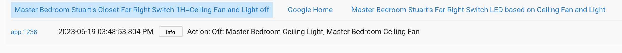

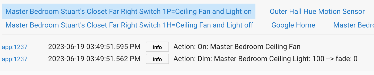

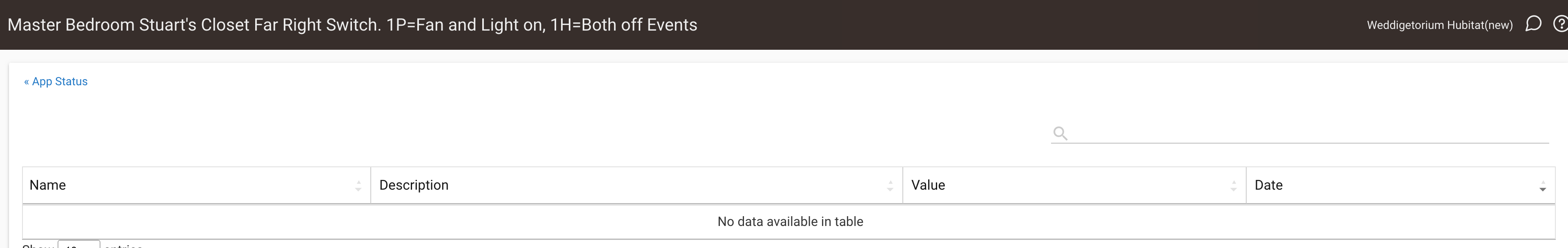

I hit Done in the simple Button Rule. That didn't wok. I then turned on logging for the rule (BTW there were only Triggers and Actions shown, there was no "Events"). Here you can see I have logging for the rule turned on:
When I do the physical button I get this in the log for the rule:
Off:
On:
When I use the dashboard button no events are generated. But, I do see the LED go off or on on the physical switch and the app button changes accordingly. Plus, inside the device itself I see the Current States for "switch" change accordingly.
Do you mean log entries or actual events? It would be good to know what event, if any, is generated from this if that is the part that isn't working. "Events" on the device detail page will again be the best clues.
(EDIT: I should add that everything above appears to be OK from what I understand about your setup and desired outcome...)

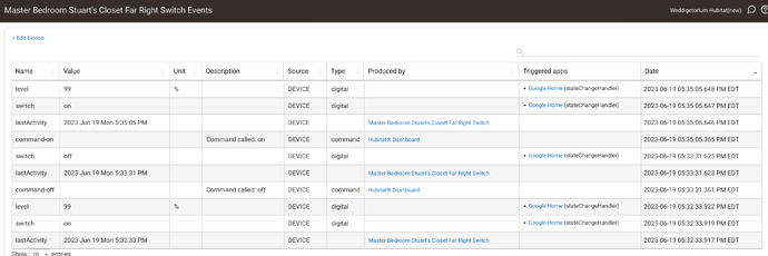

Both. Neither the physical nor dashboard generate any events when pushed. Here is the event page for the app after I used the physical button.

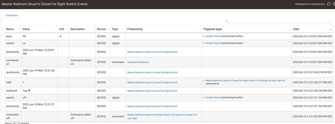

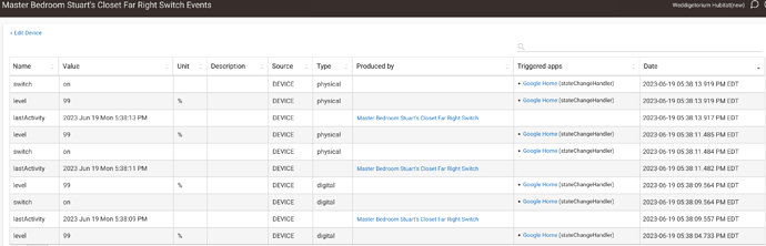

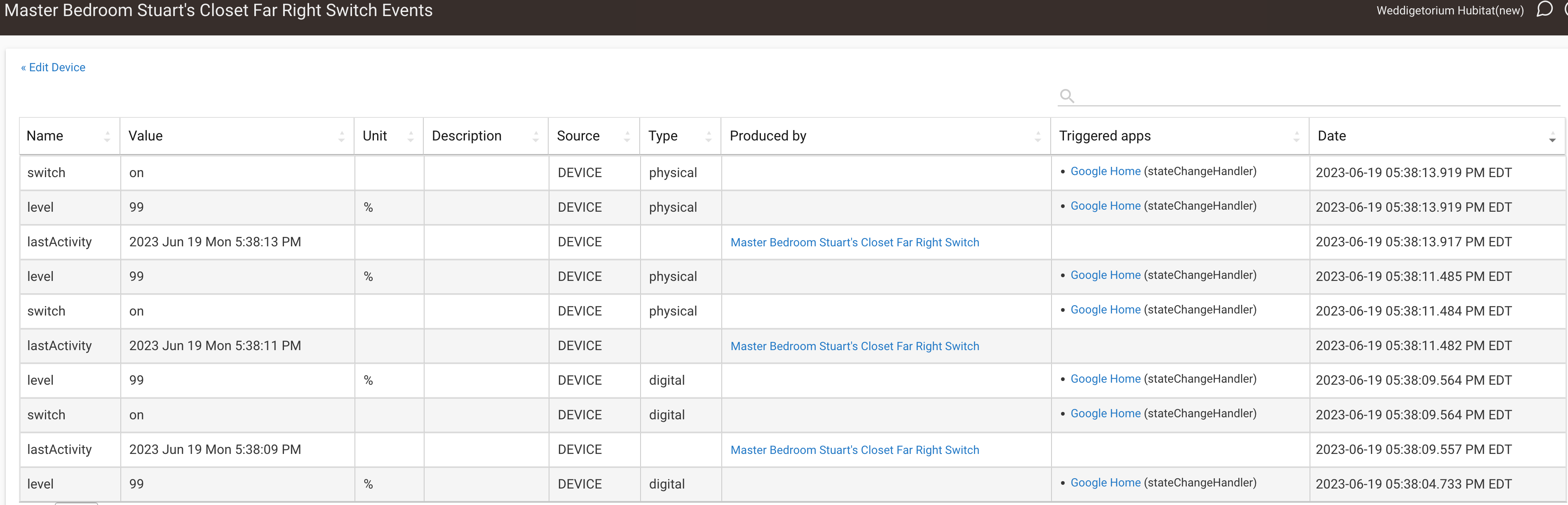

From the device itself I used the dashboard to turn on the light at 5:36. Here is a screen shot of that:
To get apples to apples I then turned off the switch physically and then turned it back on at5:38 . Here is a screen shot of that:
The only difference I can see is that when I used the Dashboard it starts with a command-on from the Dashboard. Then the lastActivity for north shows the device as the switch, the switch is on and the level is 99.
BTW, I've already tried deleting the dashboard tile and re-doing it. But, just for the heck of it I went and deleted the tile from the Master Bedroom dashboard and then re-added it. There is no change. If I turn it on or off from the dashboard everything says the dashboard and physical device are in sync, but the fan and light never turn or or off when done from the dashboard.
Your first screenshot is app events (from I don't know what, though it doesn't matter); it is very rare that apps put anything here. I'm looking for device events. It looks like the last two screenshots show the events getting generated correctly in both places. The only reason this shouldn't work as a rule trigger is if you have phyiscal switch specified instead of just switch as the trigger. If you're looking for a button event instead, I don't see that in the event history at all, though if you're using the Inovelli LZW36, that would be on the parent instead of any child device.
In case it isn't clear, what I'm asking you for is to figure out what events are actually being generated on the device from physical (on-device) or digital/virtual (from the hub) actions, then making sure that whatever app/automation you're using is actually subscribed to those events, waking up in response to them, and executing your intended actions — or where the breakdown is occurring if that's not happening. Everything you're doing sounds like it should generate some event, so the trick is getting the app subscription to match the event, however it works in the app you're using.

But with this extra information:
the thing I'd make sure of is that you're actually getting these events on your button device (the parent LZW36, it looks like?) for both real and virtual "presses" (push/hold) of the button. For Dashboard, you'd need the "button" template to do this, as a switch (on/off) template will not generate button events for scene dimmers like this, only switch events (or really commands that would normally result in an event, but similar idea).
