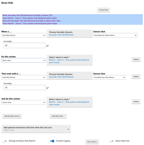

I have created the below basic rule that is supposed to open a rachio valve (sprinkler) when moisture sensor reading fall below a certain level, and then close it when it gets up to a certain level. Here's the rule:
I originally had the rule in Rule Manager because I have all my other rules there, but it wasn't working there so I tried Basic Rules. It's not working here either, or more specifically it's not triggering. I can see the moisture sensor is reading below the threshold and the rule doesn't start. If I manually chose Run Actions button in the rule it will open the valve and I can see the moisture sensor reading go up above the threshold but it doesn't stop. Why is the moisture sensor not able to trigger the rule to start?

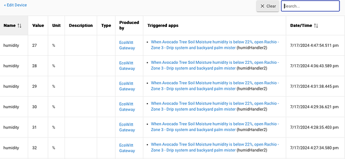

My first guess would be that the driver for the sensor is saving the humidity attribute as a string instead of a number. Can you show a screenshot of the Current States from the device page of the sensor?
Yes, here you go. For reference, it's an Ecowitt sensor
here's some of the events

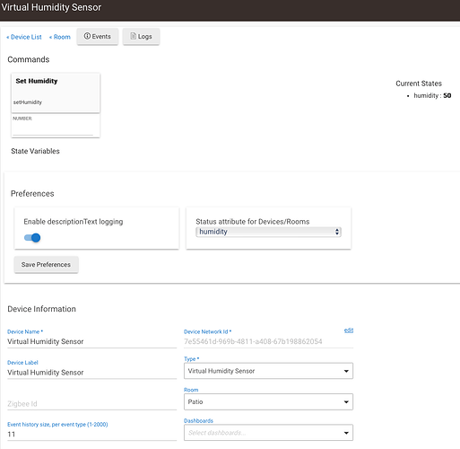

You could try making a virtual humidity sensor device, then use that in the rule. You can set the humidity to anything you want from the device page to test the rule. If it works there but not from the ecowitt device that gives clues.
That's a good idea, I'll try that right now
Something not working, I've created a Virtual Humidity Sensor and not matter what number I put in for setHumidity, the value stays at 50. Am I missing something?
Did you click the command button right above the entry box where it says Set Humidity? (not save prefs, it is not a preference).
omg, no, I was saving the device :joy: Rule ran fine when I set the humidity before the threshold, and stopped when set back above. Rule works, sensor isn't. There are other drivers for the Ecowitt, suppose I can try one of those unless you have any other ideas?

Change the code and tried it out with Basic Rule and nothing happened. Went to Rule Machine and tried it there since that rule gives you the TRUE / FALSE for the condition, which had wondering if it can evaluate it there then why not act on it. Well a couple minutes later the valve opened and the rule ran. What I noticed is that the humidity had just dropped and there was an event in the log updating the humidity and immediately after the rule kicked off. I’m wondering if the rule wasn’t running previously because the humidity wasn’t changing so the rule wasn’t aware. I was changing the threshold to kick off the rule when using the real sensor because I can’t change the humidity it reads, but with the virtual I was changing the humidity. I think that was the problem.
Um yes, the rule won’t run iust from you saving it at a different level. It actually resets the rule every time you save it. The humidity has to change for the rule to trigger :person_facepalming:
It seems the sensor is only reporting when it changes, not on regular intervals. The gateway checks it every minute, for seems reason thought the rule would too, but now I see it's passive and waits for an event to hit the logs. Thanks for all your help.
