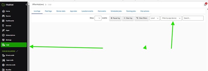

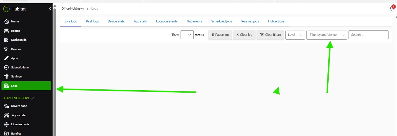

https://docs2.hubitat.com/en/user-interface/advanced-features/logs
Maybe. Those are live logs, which will only show you entries that get generated after the page was loaded. To find things that already happened (probably the case here), you need the "Past Logs" tab on that same page.
A shortcut to get to Past Logs filtered to just the app you came from is the logs icon in the top right of the app page (the specific rule, in your case), as I mentioned above:

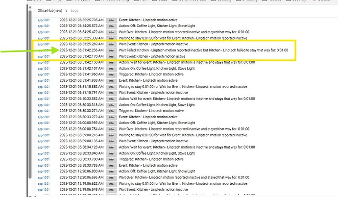

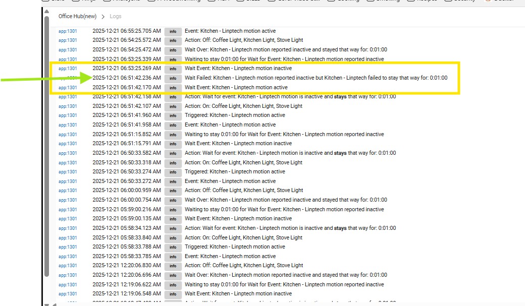

So just for grins is this when it was unplugged ?

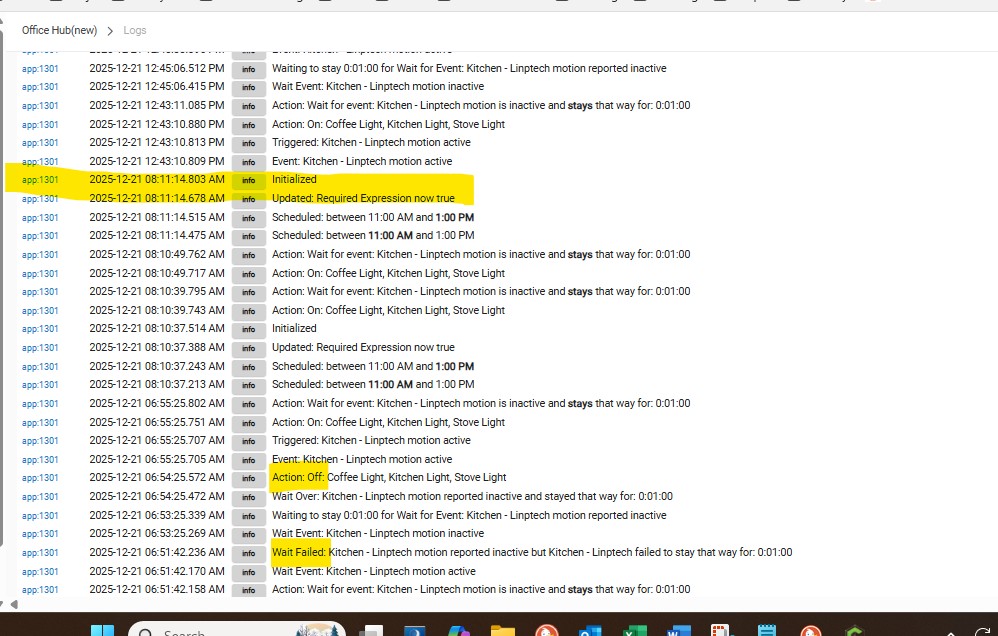

You are right again! This log tells all.
No, if the device is sending a motion event, it definitely wasn't unplugged -- a device with no power source cannot send any information to the hub.

Whenever the Linptech was sending motion events, it had power.
It does not have an on-board backup battery, so when unplugged, it's dead - it can't send any events (to include reporting any sort of "Yo, I'm out" back to the hub).
The hub can't tell exactly when it left... If your hub is a party host and all devices are guests, this is the Linptech doing an Irish Goodbye.
If you have some kind of a polling tool set up (e.g. Device Activity Check), then the hub would eventually realize, "Huh, it appears that Linptech left sometime since I last saw that dude around here at xx;xx time".
In the Past Logs for the Linptech (not the rule), you may be able to tell when it came back to the party, depending on its level of reporting -- there may be something along the lines of an "Initialized" entry then in those logs.
