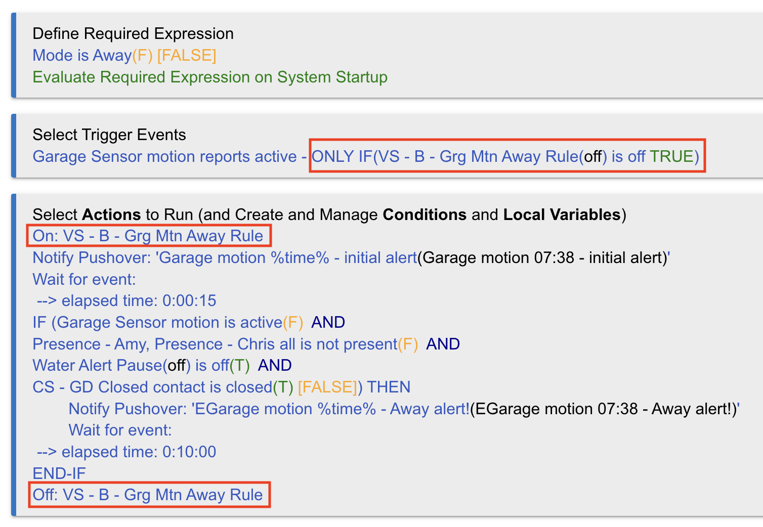

Here's one of my motion rules that use a VS in that way (note that I have a RE here too - it acts as the first / wider gatekeeper for the rule):
Summary
This kind of setup ensures that the rule doesn't get put in the position of re-firing on itself / stepping on itself.

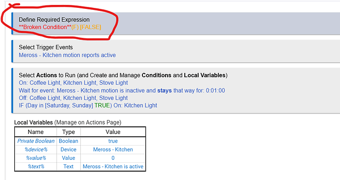

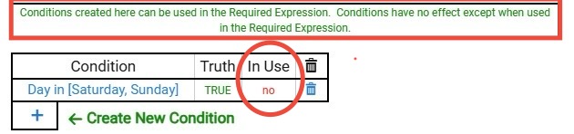

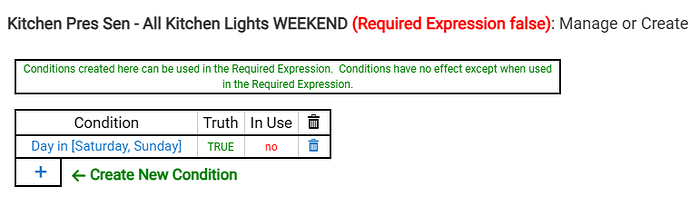

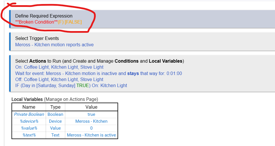

I’m not sure what exactly you did.
But from your last screenshot, I believe I can see what you didn’t do.
It appears as though you created a condition but you’re not using it in the required expression.
Rule machine is trying to tell you this, in two different places.

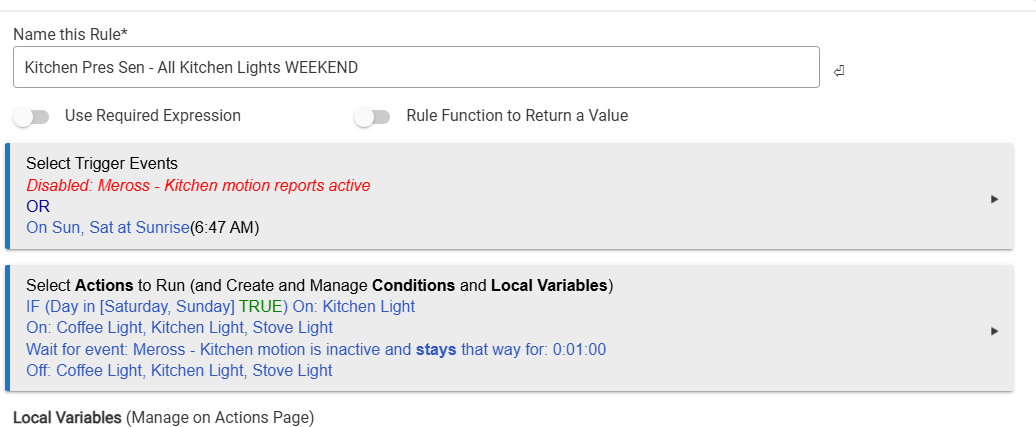

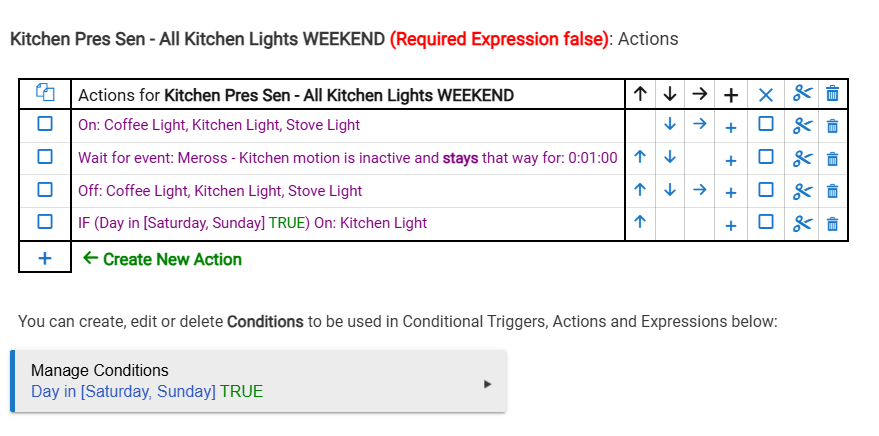

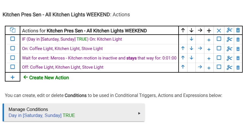

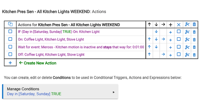

Okay I think I might have it figured out. Please see screenshots.
OR
should I leave the Motion active?
Is there a better app to use to display my screen and apps?

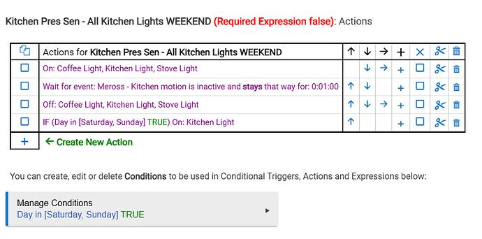

I would strongly suggest reading the docs, as, despite many previous attempts to correct this, your rule continues to show a fundamental misunderstabding of Rule Machine basics, including what trigger events actually do. You don't have to read the whole thing; this is explained pretty early on. I'm not saying this for no reason; I think it would be extremely helpful if you are going to use Rule Machine.
In your case, your trigger is sunrise on weekends. Triggers (as you'll see in the docs) will make you actions run. Surely that is not what you want. Further, your actions have a condition that would only be true if your trigger fired (day in Saturday or Sunday). This is the exact same as a mistake that has been pointed out to you in another rule previously. This should at least make you question the way it's written, and you'd be right to do so. At a minimum, you do want motion as the trigger, as you asked; but unless you want them to turn on without motion at all, it's likely the only trigger you need, too.
You may also need to rewrite your actions, as right now only your first action is restricted by your condition. It sounds like you maybe want everything to be restricted that way? If so, you'll need an IF THEN...END IF (not a "simple conditional" IF), a conditional trigger, a required expression, or some other approach to this problem. You may have actually closer before. :slight_smile: (But it depends on what you actually want to restrict.)
You may also want to consider creating this in Basic Rule and "importing" it into Rule Machine to get a better starting point if you do want to use RM. It looks doable in Basic Rule, so I'd really suggest just keeping it there, but if you don't want to, at least that would give you a good place to start.

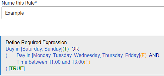

Give this a try...

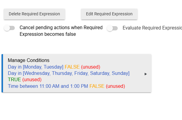

How do you get the "IF" requirement OR
I am using Monday & Tuesday as my "Sunday & Saturday" for testing.
days of week
Click “edit required expression”.

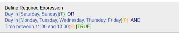

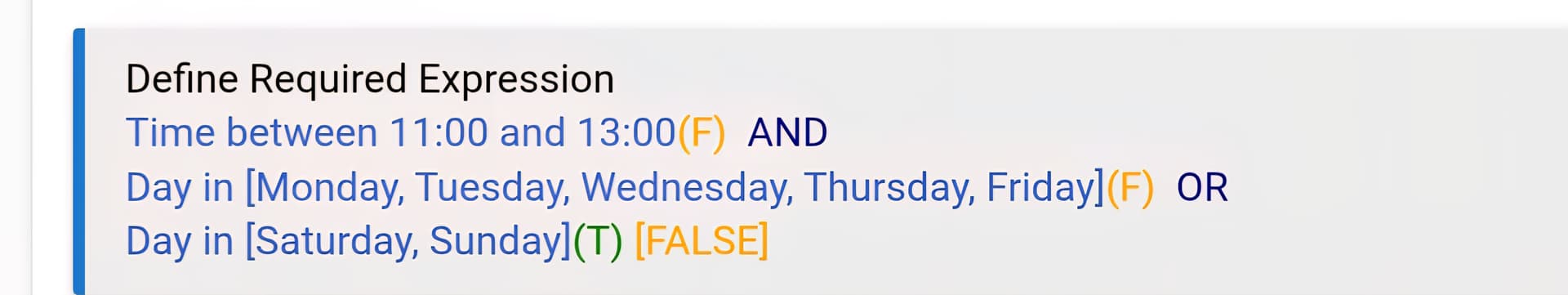

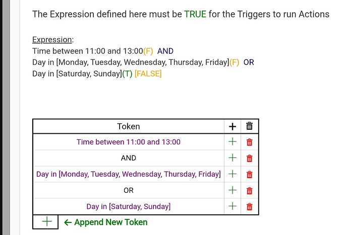

That looks like it would work, but it would depend on the order of precedence for "AND" and "OR" statements.
For example, I was going to offer the following suggestion, but I felt the result would be uncertain.
Can anyone shed any light on how each of these suggestions would be interpreted?
They are evaluated left to right with equal precedence. You can add parentheses in your expression to change this (creating sub-expressions that are evaluated as one unit outside the sub-expression), which you'd need to do for either of these expressions to evaluate how you probably want them to.
Thanks for your reply.
When adding "Actions" I was able to build reliable expressions using AND & OR (within If-Then groups), but I cannot figure out any way of adding parentheses when creating Required Expressions.
Any suggestions?

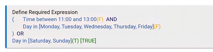

Click that first "+" then select "(" to add, and then click the 4th "+" to select and add a ")"
Thank you very much. ChatGPT told me to add parentheses as well. and I have been trying to accomplish that since yesterday.
After seeing how easy it was, I feel kinda stupid.:disappointed:

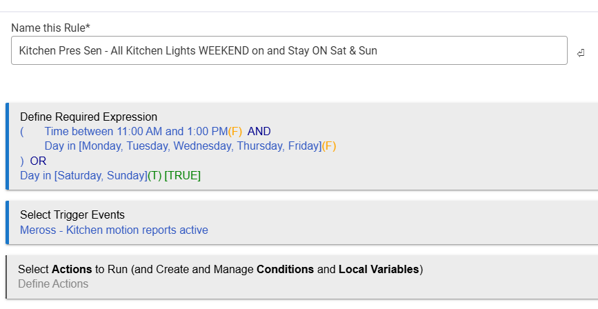

So like this then?
Still learning. That nugget helps with some other things I work on. Thanks.
That looks good!
Thank you all so much. I think I have it now. FYI I am learning so much from you guys! BIG THANKS!

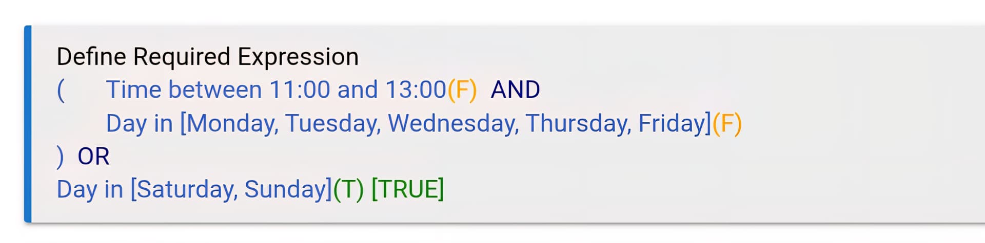

Just to make sure I explained myself correct, on Sat & Sun the Prescence sensor will trigger the lights ALL day. Monday - Friday the Pres sensor will only fire from 11:00 am to 1:00 pm? By the way how do you put military time in a rule? Like 1:00 pm 13:00? Every time I try it will not take the 13 or higher.
That looks good! Note that this rule itself will not actually do anything (you need to add actions, which I am assuming you know and are just taking this one step at a time; it affects the ability of your trigger device to trigger this rule but does not affect its behavior anywhere else, including other rules or any apps).
This is a hub setting, not specific to Rule Machine. It will affect time inputs in all apps. Go to Settings > Hub Details and select 24-hour time as your time format.
