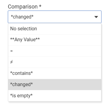

Being the payload is a string I do not get the < > etc. options even though the string value is a number....dang rabbit... If Battery <70 AND >50 THEN... will not work with string values as far as I can tell and read.
I have one rule working for PV Solar IN that contains "00" so 100watts, 200 watts, etc... The issue is these values still happen more than I need to know so trying to add some time or other condition between checking.
But I want to add a delay to do it only every 2 hours, Mins, whatever and I am not getting any values if I select "Any Value" or "Contains" with a Periodic Time.
Another attempt that does not work... Exceeds? Can't it is string not integer???
If I add 2 Actions I get an OR condition and should be an AND so Run every 2 hours AND IF contains "00" send a notification... can't seem to get the AND working. Might be interpreting it wrong... but it ain't working sooo ???

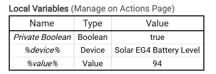

Here is what my Local Variables looks like on the one rule that is working and sending too many.
I would love to be able to trigger an Action on less than or greater than, but I only get these options

One way to stop a rule from triggering often is to use a private Boolean required expression. Below is an example of a rule that sends me a pushover message once an hour, while the 18000 limit runtime is exceeded. How the message is sent is not important that is a separate rule, but it only will send it once an hour. You can use this with the changed trigger you have. Every time the value changes you set the PB false. then send your notification. Then set a delay to set the PB back true. Set the delay for whatever amount of time you want to wait. Once the PB is set back true the rule will trigger again on a change. Using the required expression, as long as the PB is False the rule will not trigger.
The rule below uses a wait. If I change the filter and reset the Ecobee runtime it will = 0 and continue, otherwise it will timeout in one hour. Then the next increase in the runtime will trigger the rule again and I get another Pushover notification.
The set is just set variable.
You could also use a separate rule that converts the data to a decimal number and puts it in a hub variable that you trigger on and use an expression for your trigger as I do in the rule below. runtime > 18000.
