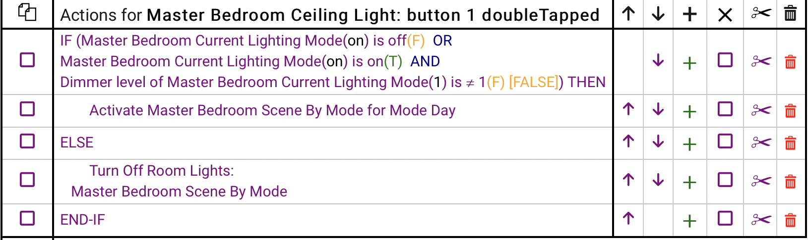

Okay, so in your example, "scene 2 b" is a regular scene and not part of Room Lighting?
Okay, so I think we are going in circles here. I am asking that this feature be added. This is how I achieve my instance.Under the double tap section. Each Scene is a separate scene. I wish to achieve the same via the RL app. And to be able to "Toggle" each RL by mode" in the same fashion.
There is not need to use conditional statements if only using the single scene activator for the Room lighting instance. I just use toggle already in the room lighting instance. I need a way to "Toggle" a different mode lighting scene within the room lighting.

It seems to me that you're making this overly complicated. You can certainly have a button action that activates each mode, and another action on those same buttons that toggles each mode (as shown above). These are clearly different things to do. So they have to be invoked by different means.
If you really want to use a single button action to either just activate or toggle, depending on some state, then that state needs to be available to be tested. This could be done by setting a virtual dimmer to different values, one per scene. Then the test is what value is the dimmer, and what state is the switch.
Okay, so the virtual dimmer is defiantly outside the box, but sounds absolutely doable. It's still not the "Mona Lisa" of room lighting I'm trying to propose. But should at least irradicate most of the clutter I have to deal with. it reduces the virtual devices (I am lumping activators in with virtual devices) from 4 to 2. and also allows me to consolidate the scenes from 4 to 0 and use Room lighting for the scenes.
OK, but you're making contradictory proposals. One is toggle per mode (which won't work for your scenario above), and the other is activate per mode; and you want these all on a single button action. Like I said, this is way too much complexity, and I'm willing to bet that you will rarely use this "feature".

Came up with this, its more "Hubble space telescope" than "Mona Lisa", but it works to "Toggle" as needed. Still leaves out the re-capture part (Solution still needed for that).
