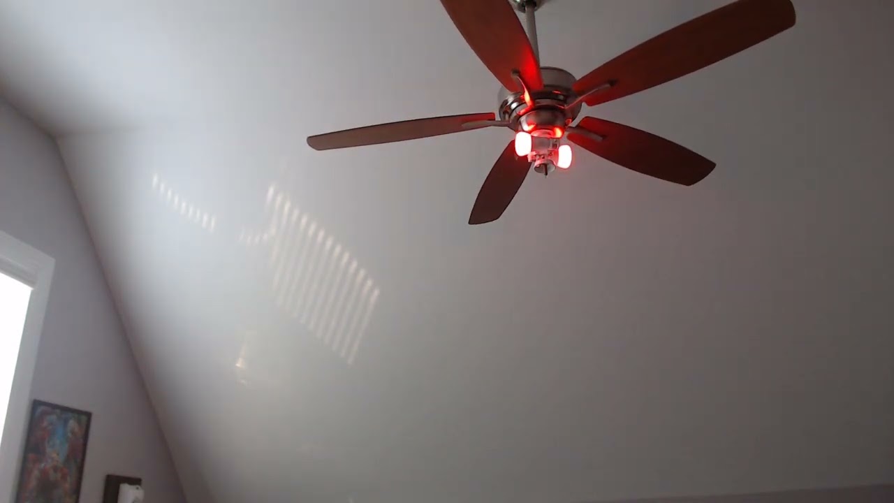

Just to make sure I wasn't crazy. I set this back up using my office fan. It has two Hue bulbs imported as a group with RL being the only thing controlling it.
I set the light to CT 3000k, 100% brightness, and then turn it off. I updated the RL activation settings to have it turn back on red at 20%.

Ah, then you're looking for answers in the wrong place. Room Lights sent a single command, based on your logs: setColor(). Everything that happened after that has nothing to do with Room Lights.
You could verify what you're seeing by just doing a setColor command on the device page for Office Fan Light.

No matter how I turn them on, it happens.
All of this becomes so much easier to figure out when you use the logs to answer your questions. The apps, by and large, show in the logs exactly what they do. In this case, since the app only did the one thing it was supposed to do, it couldn't very well be the problem, right?
