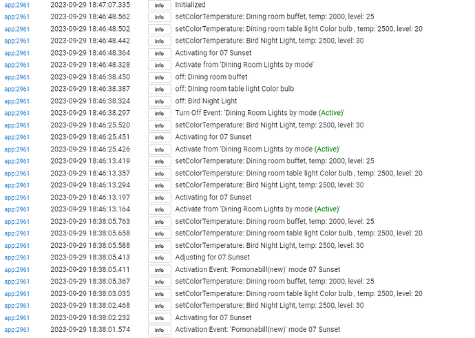

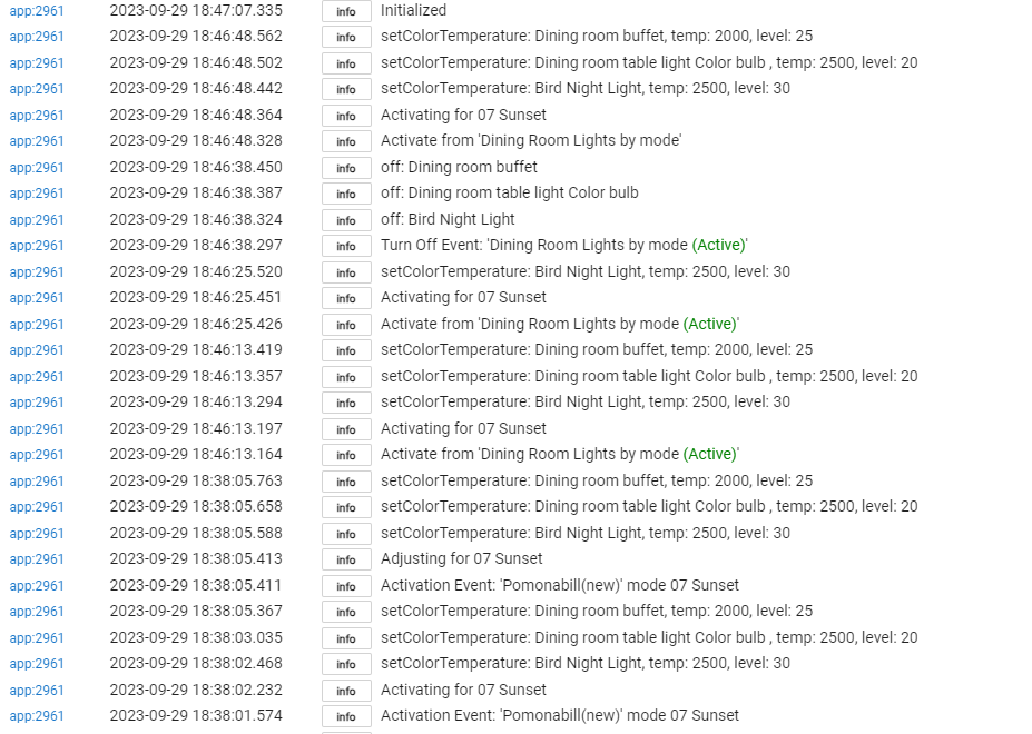

Here is the log of a RL rule that ran, but did not turn on the lights, even when I manually activated a couple of times:

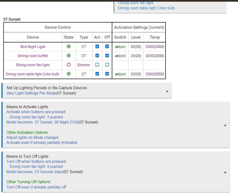

Even though RL thinks it turned the lights on, none of them were actually on, and the indications in the "state" column for all the lights was a red X.
the screenshot was after I clicked on Turn off, then clicked on Activate, but they were all X
Kinda looks like ALL the lights lost communication.
I used to have a RM rule for the same lights and that always seemed to work,, just RL has been flakey.

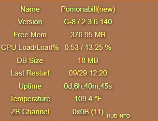

Also a C8 on 2.3.6.140. Seems to run a little hot too:
just wondering if the hub is too busy and missing commands....

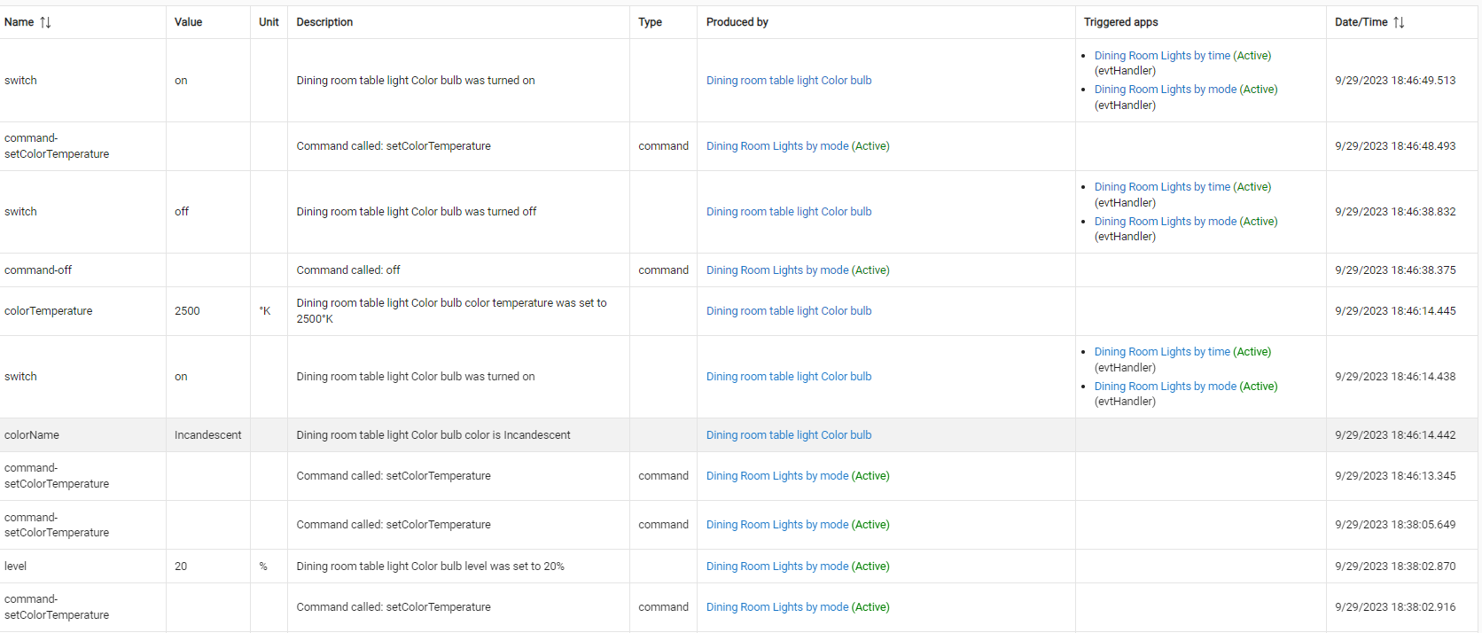

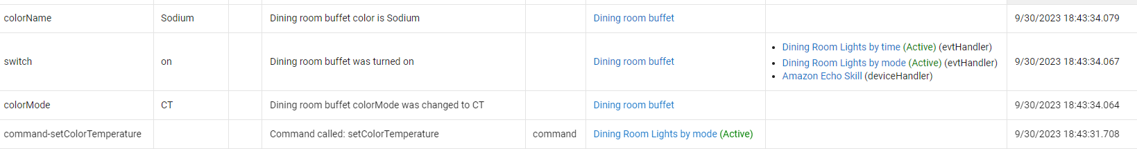

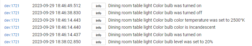

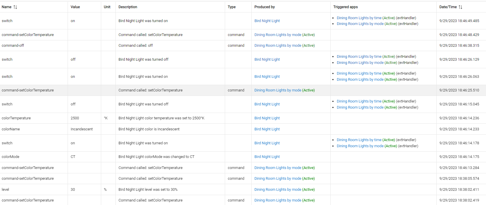

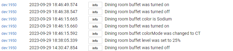

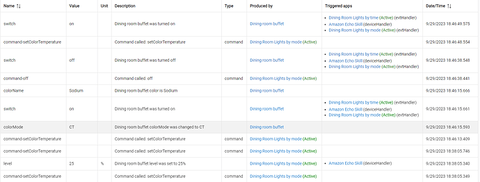

What logs and events do you see for the lights when this occurs?
dining room buffet:
dining room table light:
bird night light:

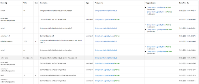

I have seen this in the past with RL.... the light is turned on, then within 1 second is turned off then within .5 seconds, back on... sometimes. Another oddity with RL?

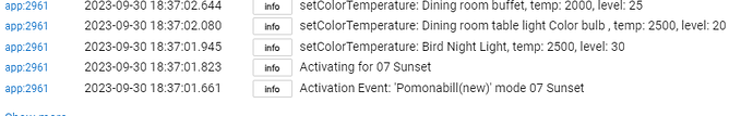

Well tonight, 9/30, RL failed again, and ALL the lights in the dining room were red X.
Here is the by mode log:

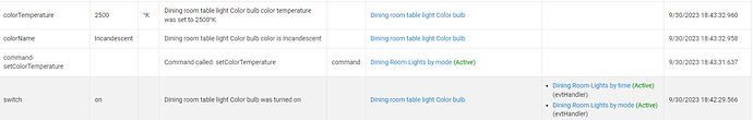

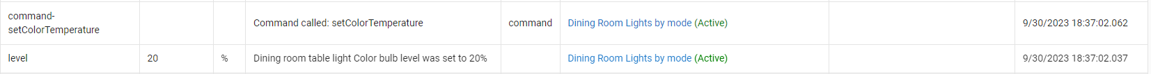

Here is dining room table light:
the log:
dining room buffet:
log:

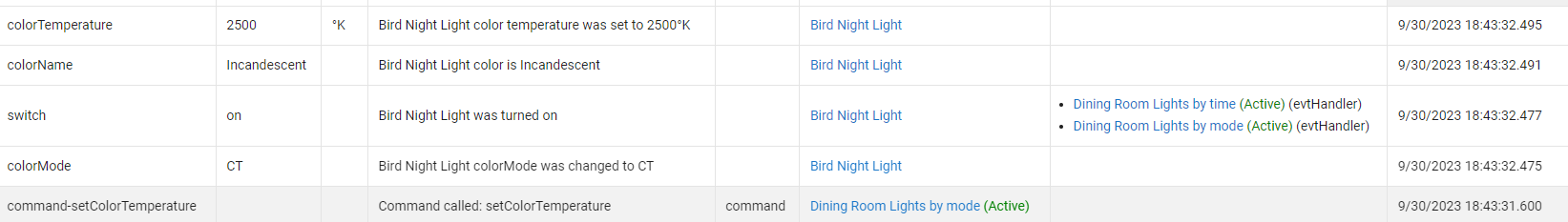

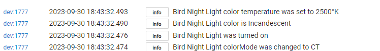

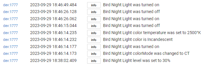

bird night light:
log:
NONE of the lights came on, they ALL had the dreaded red X in RL.
I went to the device page for the table light and manually click on ON and ALL of the light's red X in RL were gone (not just the table light).
I then clicked on ACTIVATE in RL and they all came on like they should have.

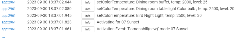

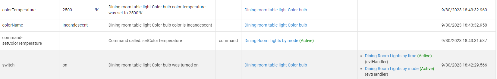

log:

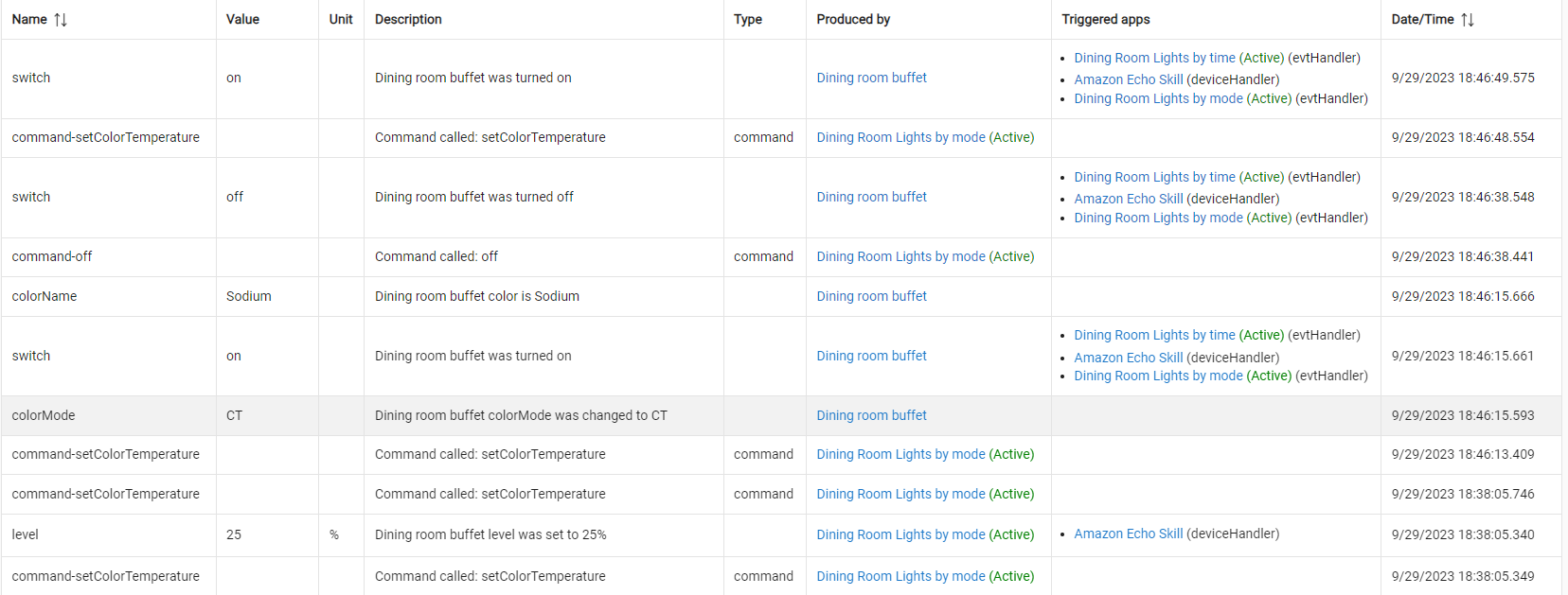

dining room buffet:
log:

Noticed that when the lights failed, there were NO "turned on" commands, ONLY a "set level".
A clue???
setLevel implies on, there is no need for an explicit on.
Do you have pre-staging enabled? That would explain your problem.
Why is there no CT or color commands either ?

I wondered what the red X meant also?
I did noticed when I clicked on the X that it changed to the filled circle and the light turned on.

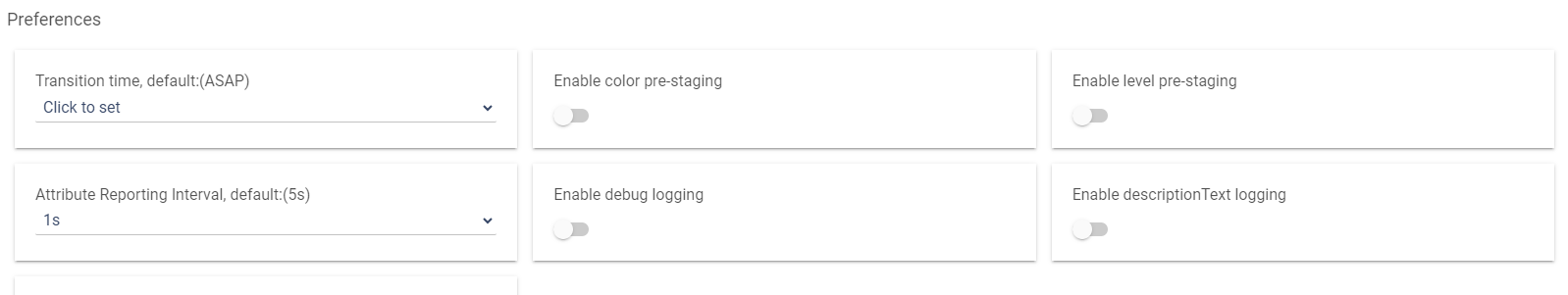

The is the default setting in the driver.
I will change it to 1 second as the only options are disable/1 sec/5 sec. This is the attribute change reporting interval setting.
Which driver?
The Sengled Element Color Plus... this is a native driver in HE.
Please show a screenshot of the setting you are referring to.

The setting "Attribute Reporting Interval ". The options are disabled/1 second/5 seconds
