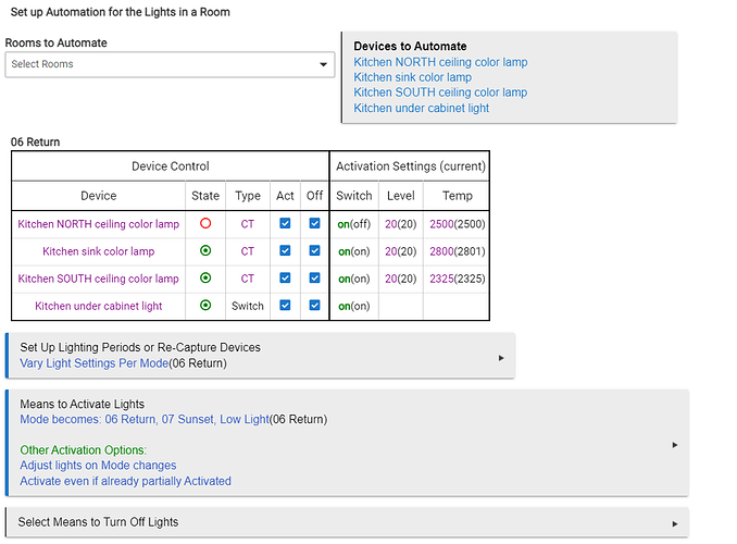

Here is tonight's kitchen lighting RL:
Notice that the kitchen NORTH ceiling color lamp "thinks" it is off, but it did turn on.

Does the option to "Activate even if already partially activated" create two "cycles" of the RL?

On the device page for kitchen NORTH, it is indicating the light is off, when it IS on.
Even thought I don't have a RL for my living room lighting (they are still in a RM rule), when my Living room HIFI light turned on tonight, the device page for the light indicates it is off when it IS on!
Also, the living room sofa SOUTH is indicating off when it IS on, but the NORTH light is indicating ON
It just looks like the lights are not reporting reliably.
