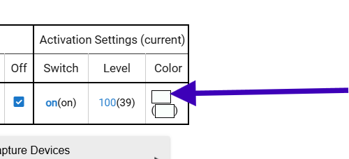

Is it possible to change the color of the lights to the time of day? I would like to have it set to this setting at night - see screenshot below.
Green at night
In the morning a bright white light.
  • So Green at night
  • White in the morning

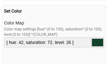

Click on the color squares, this will bring up a window and there should be an option for green or click on pick color

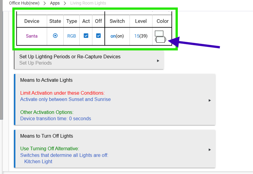

I clicked in color box and nothing happens.
Color box

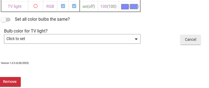

It should look something like:

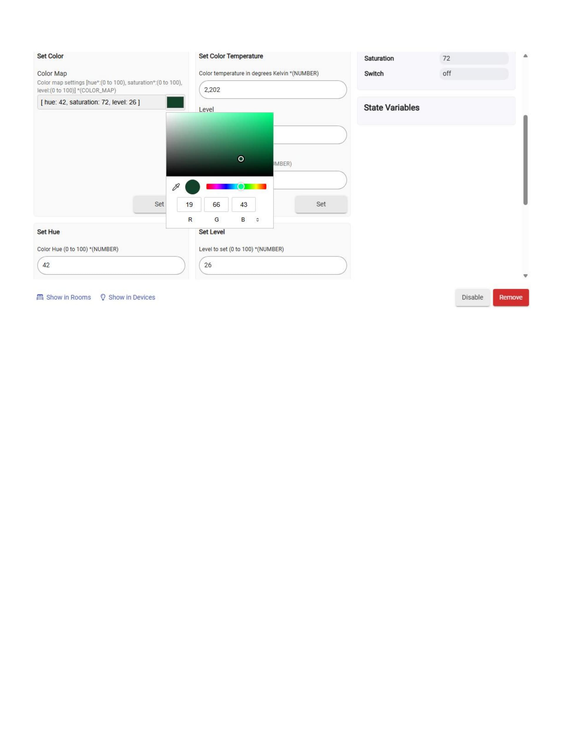

Just had another idea. Go ahead and setup your time periods. Go into each bulb's device page and set the color and level you want. Then click on re-capture for the time period. Do the same thing again for the next time period. That "should" set the colors.

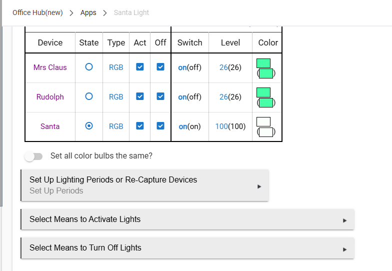

Here are the device settings.
