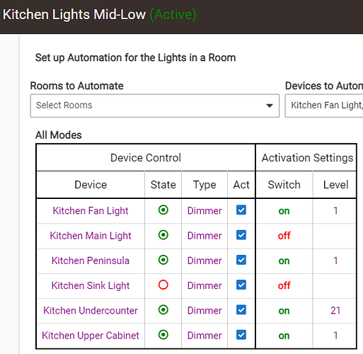

As I turned on debug logging for each of the scenes in question, the active status went away (as shown under Apps). It had been set to "Mid-High", and even a web refresh (F5, not full Ctrl-F5) didn't bring it back. Activating the scene again did.
I then bounced between 3 different scenes - all now 3 show active (physical lights did change as expected). But even if they didn't, if there isn't a perfect match to a scene, it shouldn't show as Active, should it?
