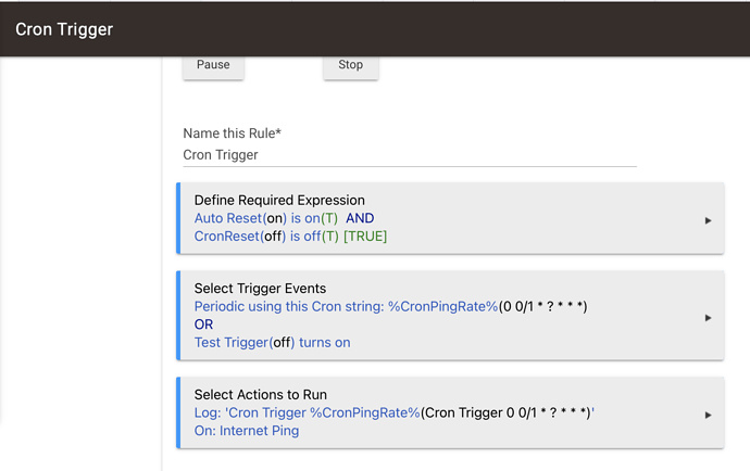

Since the latest releases, 139, and now 140, I'm having problems with CRON triggers stopping when I update the cron string based on a variable.
I've been using the Cron string trigger for my network reset routine. When you added the string variable feature, a variable subscription was not released, therefore I incorporated a work-around where I used a predicate (required condition) based on a 2sec auto-off virtual switch 'CronReset'. The predicate is that the switch is off. CronString is set through a second cron update routine that updates the string based on polling rate, 15 minutes when the network is up, 1 minute when the network goes down. The update routine is triggered by a change in the polling rate, then sets the new string, and turns on the CronReset switch.
The cycling of the predicate condition was sufficient to capture the new cron string and continue polling, it worked great when I originally put it in place.
I'm not sure if you have added the variable subscription to Cron where the predicate is no longer required. I noticed, however, that when the string updates, it stops triggering until I go in and open= the app.
I tried adding a resume at the end of the update routine, that still didn't work. The 5 sec delay was to allow the 2 sec CronReset switch to reset to off.
Below are screenshots of the two primary, trigger and update, routines.
