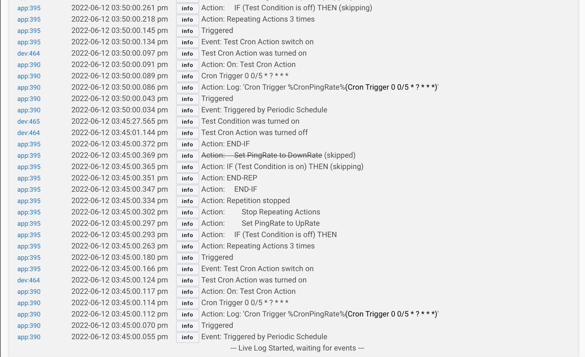

Bruce - I installed 2.3.2.124 to test the cron trigger. First review it doesn't appear to be completely fixed. I first tried it right after the update, the rules were showing broken, but an open/save corrected that. I tested the trigger by moving from a normal periodic trigger (I'm using 15, changed to 5 minutes for testing), when then goes to a 1 minute trigger when down, and back to a normal (15 or 5 for testing) trigger once the down condition is corrected.

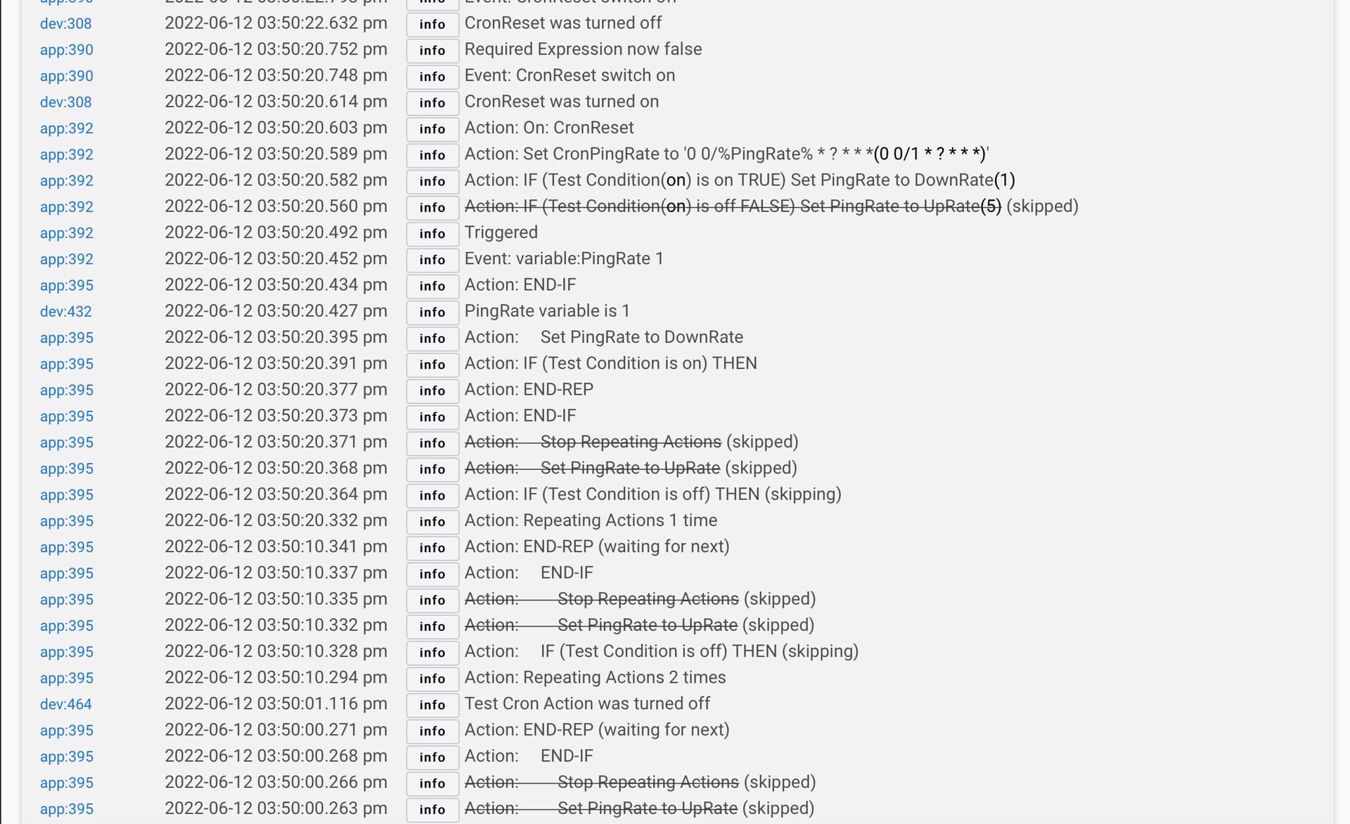

It appears the cron timer is transitioning from 5 to 1, but when it goes back to 5 it halts. I also tried removing the predicate condition I previously used to 'reset' the app which (before the previous 2.3.1 update), worked to restart the cron timer. It behaved the same and still would stop triggering when transition from 1 minute back to 5 minute increments.
This was an initial quick look yesterday evening, I'm going to take a more in depth look this weekend, probably with a completely separate test routine, to see if I can confirm the above and narrow down the conditions which is causing the trigger to fail.
One possible thought - there is a repeat loop in the timer which goes through x times. If it gets through all x times (upon failure of the test), it transitions to the 1 minute trigger. If it tests OK, the repeat loop is canceled and it transitions back to normal periodic triggers. During normal testing, if it tests OK, the repeat is canceled and the cron timer isn't updated. Not sure if canceling the repeat loop during the variable update is somehow canceling the cron timer, but figure those are likely completely unrelated.

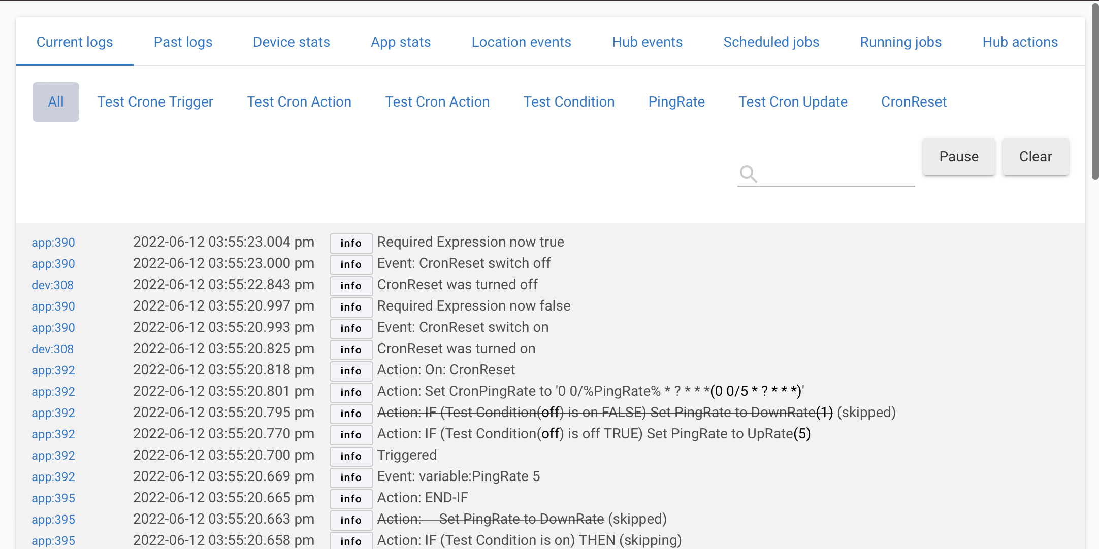

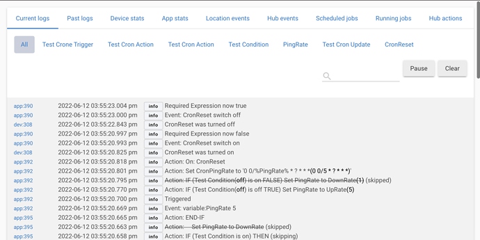

Thanks Bruce. I was able to test the routine and ultimately correct my problem. I found a required condition that was still in one of my apps that was causing the issue. It appears, however, that required conditions used in conjunction with Cron timers and variable updates are creating problems.
It is likely that in this test I'm triggering a reset in the app immediately after updating the string and the app doesn't have a chance to pick up the variable change. It picks it up fine from 5 minutes to 1, but not the reverse. I ran several tests with the same results.
I created a series of simplified test apps that models how my network test routines run that demonstrates the issue. In the logs, the rate starts at 5 minutes, shifts to 1 minute, then is set to shift back to 5 minutes. The Cron String is updated to 5, but the timer keeps triggering at 1 minute intervals (starting at 12:02). Removing the predicate condition corrects the problem, but there is a potential for problems for users who use CRON in conduction with required conditions.
I removed the required condition from my apps and they are working fine. It was legacy when under an early version (prior to 2.3.1) I was using the predicate to restart the Cron timer. This is info for review at your convenience.
I'm running the .125 update.

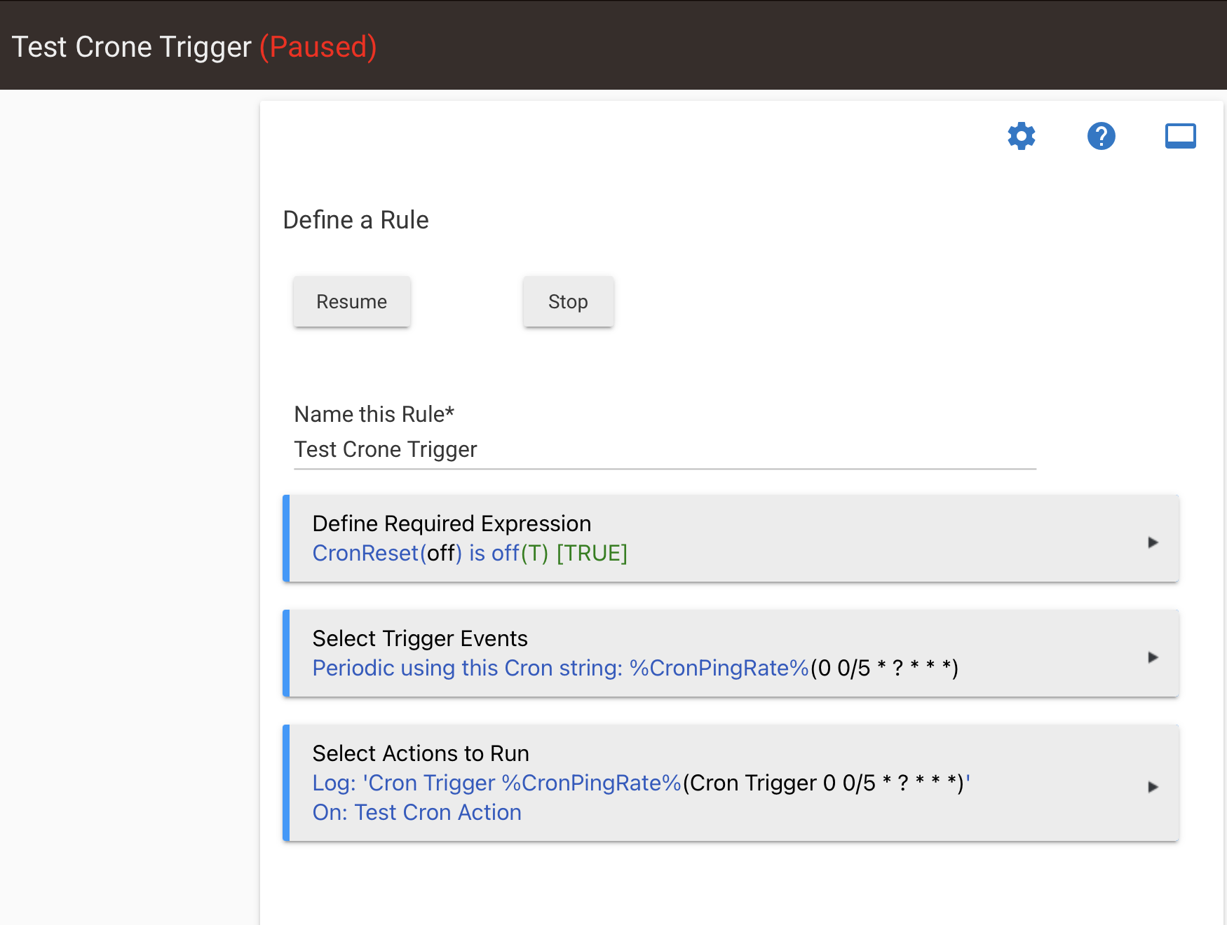

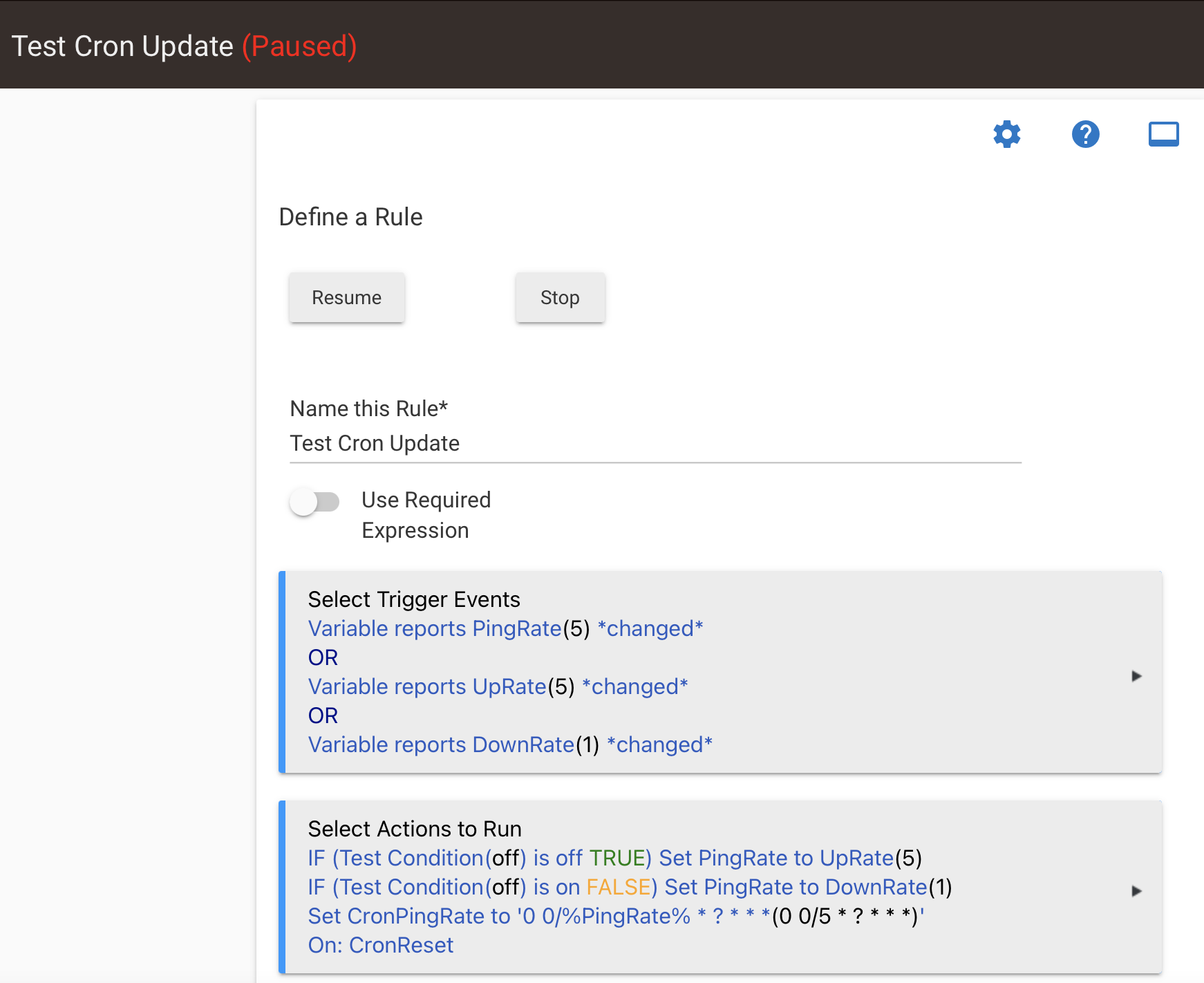

TEST CRON TRIGGER (app 390):
Contains the Cron trigger, logs it, then trips the Test Cron Action virtual switch to trigger that app.

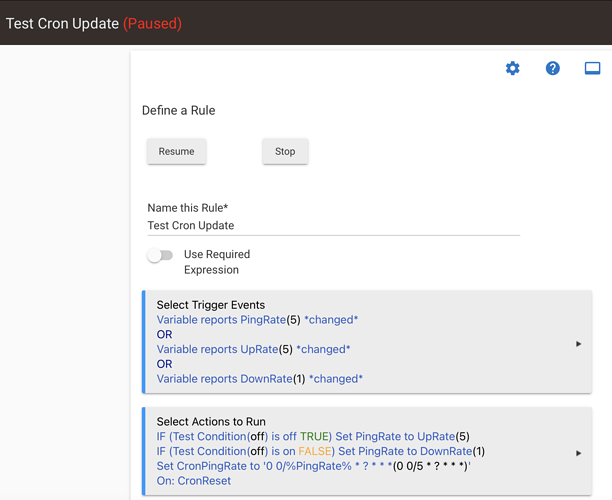

TEST CRON UPDATE (app 392):
Triggered by a change in the UpRate (if user modified on my dashboard), DownRate (same), or PingRate (by a change in the app). Captures the new string and sets the Cron Timer. At the end, turns on the CronReset which triggers the required condition in TEST CRON TRIGGER. Again - the last part is what breaks the timer.

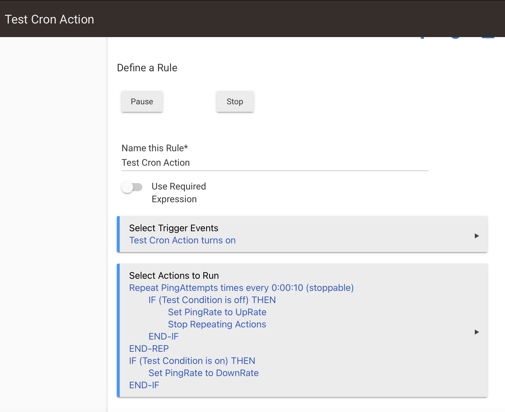

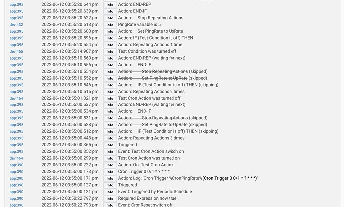

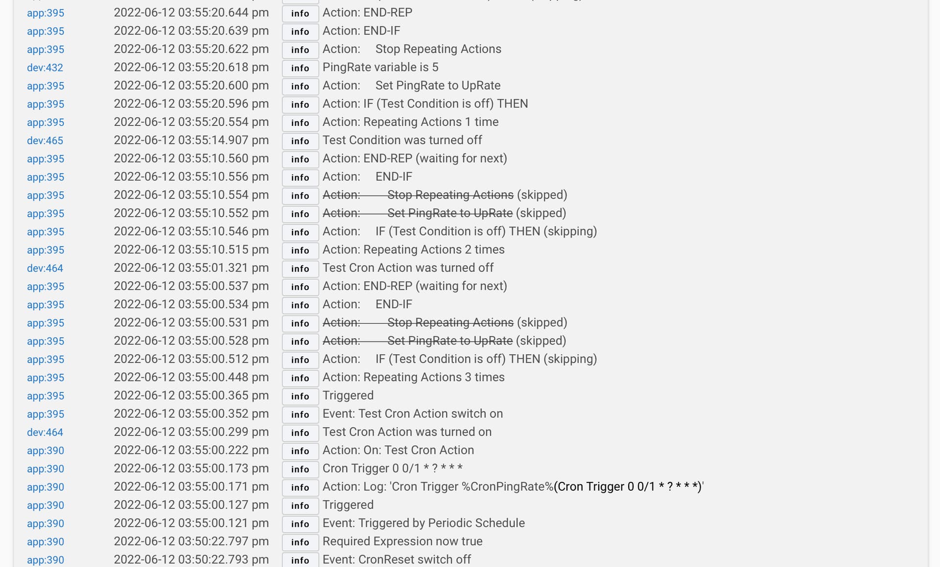

TEST CRON ACTION (app 395):
Repeats to check the TEST CONDITION. If the TEST CONDITION is off, sets PingRate to UpRate and jumps out of the loop. If it is ON through all X cycles, then sets PingRate to DownRate.

dev:4642022-06-12 12:07:01.104 am infoTest Cron Action was turned off
app:3952022-06-12 12:07:00.307 am infoAction: END-IF
app:3952022-06-12 12:07:00.305 am infoAction: Set PingRate to DownRate (skipped)
app:3952022-06-12 12:07:00.301 am infoAction: IF (Test Condition is on) THEN (skipping)
app:3952022-06-12 12:07:00.288 am infoAction: END-REP
app:3952022-06-12 12:07:00.284 am infoAction: END-IF
app:3952022-06-12 12:07:00.271 am infoAction: Repetition stopped
app:3952022-06-12 12:07:00.240 am infoAction: Stop Repeating Actions
app:3952022-06-12 12:07:00.236 am infoAction: Set PingRate to UpRate
app:3952022-06-12 12:07:00.233 am infoAction: IF (Test Condition is off) THEN
app:3952022-06-12 12:07:00.204 am infoAction: Repeating Actions 3 times
app:3952022-06-12 12:07:00.131 am infoTriggered
app:3952022-06-12 12:07:00.120 am infoEvent: Test Cron Action switch on
dev:4642022-06-12 12:07:00.087 am infoTest Cron Action was turned on
app:3902022-06-12 12:07:00.082 am infoAction: On: Test Cron Action
app:3902022-06-12 12:07:00.079 am infoCron Trigger 0 0/5 * ? * * *
app:3902022-06-12 12:07:00.077 am infoAction: Log: 'Cron Trigger %CronPingRate%(Cron Trigger 0 0/5 * ? * * *)'
app:3902022-06-12 12:07:00.038 am infoTriggered
app:3902022-06-12 12:07:00.029 am infoEvent: Triggered by Periodic Schedule
dev:4642022-06-12 12:06:01.109 am infoTest Cron Action was turned off
app:3952022-06-12 12:06:00.316 am infoAction: END-IF
app:3952022-06-12 12:06:00.313 am infoAction: Set PingRate to DownRate (skipped)
app:3952022-06-12 12:06:00.310 am infoAction: IF (Test Condition is on) THEN (skipping)
app:3952022-06-12 12:06:00.295 am infoAction: END-REP
app:3952022-06-12 12:06:00.291 am infoAction: END-IF
app:3952022-06-12 12:06:00.278 am infoAction: Repetition stopped
app:3952022-06-12 12:06:00.247 am infoAction: Stop Repeating Actions
app:3952022-06-12 12:06:00.244 am infoAction: Set PingRate to UpRate
app:3952022-06-12 12:06:00.240 am infoAction: IF (Test Condition is off) THEN
app:3952022-06-12 12:06:00.212 am infoAction: Repeating Actions 3 times
app:3952022-06-12 12:06:00.137 am infoTriggered
app:3952022-06-12 12:06:00.126 am infoEvent: Test Cron Action switch on
dev:4642022-06-12 12:06:00.093 am infoTest Cron Action was turned on
app:3902022-06-12 12:06:00.086 am infoAction: On: Test Cron Action
app:3902022-06-12 12:06:00.084 am infoCron Trigger 0 0/5 * ? * * *
app:3902022-06-12 12:06:00.082 am infoAction: Log: 'Cron Trigger %CronPingRate%(Cron Trigger 0 0/5 * ? * * *)'
app:3902022-06-12 12:06:00.041 am infoTriggered
app:3902022-06-12 12:06:00.032 am infoEvent: Triggered by Periodic Schedule
dev:4642022-06-12 12:05:01.104 am infoTest Cron Action was turned off
app:3952022-06-12 12:05:00.306 am infoAction: END-IF
app:3952022-06-12 12:05:00.303 am infoAction: Set PingRate to DownRate (skipped)
app:3952022-06-12 12:05:00.300 am infoAction: IF (Test Condition is on) THEN (skipping)
app:3952022-06-12 12:05:00.286 am infoAction: END-REP
app:3952022-06-12 12:05:00.282 am infoAction: END-IF
app:3952022-06-12 12:05:00.270 am infoAction: Repetition stopped
app:3952022-06-12 12:05:00.239 am infoAction: Stop Repeating Actions
app:3952022-06-12 12:05:00.236 am infoAction: Set PingRate to UpRate
app:3952022-06-12 12:05:00.232 am infoAction: IF (Test Condition is off) THEN
app:3952022-06-12 12:05:00.204 am infoAction: Repeating Actions 3 times
app:3952022-06-12 12:05:00.132 am infoTriggered
app:3952022-06-12 12:05:00.121 am infoEvent: Test Cron Action switch on
dev:4642022-06-12 12:05:00.088 am infoTest Cron Action was turned on
app:3902022-06-12 12:05:00.082 am infoAction: On: Test Cron Action
app:3902022-06-12 12:05:00.080 am infoCron Trigger 0 0/5 * ? * * *
app:3902022-06-12 12:05:00.078 am infoAction: Log: 'Cron Trigger %CronPingRate%(Cron Trigger 0 0/5 * ? * * *)'
app:3902022-06-12 12:05:00.038 am infoTriggered
app:3902022-06-12 12:05:00.029 am infoEvent: Triggered by Periodic Schedule
dev:4642022-06-12 12:04:01.111 am infoTest Cron Action was turned off
app:3952022-06-12 12:04:00.342 am infoAction: END-IF
app:3952022-06-12 12:04:00.339 am infoAction: Set PingRate to DownRate (skipped)
app:3952022-06-12 12:04:00.336 am infoAction: IF (Test Condition is on) THEN (skipping)
app:3952022-06-12 12:04:00.322 am infoAction: END-REP
app:3952022-06-12 12:04:00.318 am infoAction: END-IF
app:3952022-06-12 12:04:00.273 am infoAction: Repetition stopped
app:3952022-06-12 12:04:00.242 am infoAction: Stop Repeating Actions
app:3952022-06-12 12:04:00.238 am infoAction: Set PingRate to UpRate
app:3952022-06-12 12:04:00.234 am infoAction: IF (Test Condition is off) THEN
app:3952022-06-12 12:04:00.206 am infoAction: Repeating Actions 3 times
app:3952022-06-12 12:04:00.131 am infoTriggered
app:3952022-06-12 12:04:00.119 am infoEvent: Test Cron Action switch on
dev:4642022-06-12 12:04:00.087 am infoTest Cron Action was turned on
app:3902022-06-12 12:04:00.081 am infoAction: On: Test Cron Action
app:3902022-06-12 12:04:00.079 am infoCron Trigger 0 0/5 * ? * * *
app:3902022-06-12 12:04:00.077 am infoAction: Log: 'Cron Trigger %CronPingRate%(Cron Trigger 0 0/5 * ? * * *)'
app:3902022-06-12 12:04:00.039 am infoTriggered
app:3902022-06-12 12:04:00.030 am infoEvent: Triggered by Periodic Schedule
app:3902022-06-12 12:03:02.636 am infoRequired Expression now true
app:3902022-06-12 12:03:02.632 am infoEvent: CronReset switch off
dev:3082022-06-12 12:03:02.488 am infoCronReset was turned off
dev:4642022-06-12 12:03:01.105 am infoTest Cron Action was turned off
app:3902022-06-12 12:03:00.605 am infoRequired Expression now false
app:3902022-06-12 12:03:00.599 am infoEvent: CronReset switch on
dev:3082022-06-12 12:03:00.475 am infoCronReset was turned on
app:3922022-06-12 12:03:00.472 am infoAction: On: CronReset
app:3922022-06-12 12:03:00.453 am infoAction: Set CronPingRate to '0 0/%PingRate% * ? * * *(0 0/5 * ? * * *)'
app:3922022-06-12 12:03:00.444 am infoAction: IF (Test Condition(off) is on FALSE) Set PingRate to DownRate(1) (skipped)
app:3922022-06-12 12:03:00.417 am infoAction: IF (Test Condition(off) is off TRUE) Set PingRate to UpRate(5)
app:3952022-06-12 12:03:00.366 am infoAction: END-IF
app:3952022-06-12 12:03:00.363 am infoAction: Set PingRate to DownRate (skipped)
app:3952022-06-12 12:03:00.358 am infoAction: IF (Test Condition is on) THEN (skipping)
app:3952022-06-12 12:03:00.350 am infoAction: END-REP
app:3952022-06-12 12:03:00.340 am infoAction: END-IF
app:3922022-06-12 12:03:00.331 am infoTriggered
app:3952022-06-12 12:03:00.328 am infoAction: Repetition stopped
app:3922022-06-12 12:03:00.300 am infoEvent: variable:PingRate 5
app:3952022-06-12 12:03:00.297 am infoAction: Stop Repeating Actions
dev:4322022-06-12 12:03:00.284 am infoPingRate variable is 5
app:3952022-06-12 12:03:00.254 am infoAction: Set PingRate to UpRate
app:3952022-06-12 12:03:00.250 am infoAction: IF (Test Condition is off) THEN
app:3952022-06-12 12:03:00.210 am infoAction: Repeating Actions 3 times
app:3952022-06-12 12:03:00.133 am infoTriggered
app:3952022-06-12 12:03:00.122 am infoEvent: Test Cron Action switch on
dev:4642022-06-12 12:03:00.089 am infoTest Cron Action was turned on
app:3902022-06-12 12:03:00.082 am infoAction: On: Test Cron Action
app:3902022-06-12 12:03:00.080 am infoCron Trigger 0 0/1 * ? * * *
app:3902022-06-12 12:03:00.077 am infoAction: Log: 'Cron Trigger %CronPingRate%(Cron Trigger 0 0/1 * ? * * *)'
app:3902022-06-12 12:03:00.039 am infoTriggered
app:3902022-06-12 12:03:00.029 am infoEvent: Triggered by Periodic Schedule
dev:4652022-06-12 12:02:21.963 am infoTest Condition was turned off
app:3952022-06-12 12:02:20.398 am infoAction: END-IF
app:3952022-06-12 12:02:20.394 am infoAction: Set PingRate to DownRate
app:3952022-06-12 12:02:20.391 am infoAction: IF (Test Condition is on) THEN
app:3952022-06-12 12:02:20.377 am infoAction: END-REP
app:3952022-06-12 12:02:20.374 am infoAction: END-IF
app:3952022-06-12 12:02:20.372 am infoAction: Stop Repeating Actions (skipped)
app:3952022-06-12 12:02:20.369 am infoAction: Set PingRate to UpRate (skipped)
app:3952022-06-12 12:02:20.365 am infoAction: IF (Test Condition is off) THEN (skipping)
app:3952022-06-12 12:02:20.334 am infoAction: Repeating Actions 1 time
app:3952022-06-12 12:02:10.345 am infoAction: END-REP (waiting for next)

app:3952022-06-12 12:02:10.332 am infoAction: IF (Test Condition is off) THEN (skipping)
app:3952022-06-12 12:02:10.297 am infoAction: Repeating Actions 2 times
dev:4642022-06-12 12:02:01.120 am infoTest Cron Action was turned off
app:3952022-06-12 12:02:00.274 am infoAction: END-REP (waiting for next)
app:3952022-06-12 12:02:00.271 am infoAction: END-IF
app:3952022-06-12 12:02:00.269 am infoAction: Stop Repeating Actions (skipped)
app:3952022-06-12 12:02:00.266 am infoAction: Set PingRate to UpRate (skipped)
app:3952022-06-12 12:02:00.262 am infoAction: IF (Test Condition is off) THEN (skipping)
app:3952022-06-12 12:02:00.231 am infoAction: Repeating Actions 3 times
app:3952022-06-12 12:02:00.149 am infoTriggered
app:3952022-06-12 12:02:00.138 am infoEvent: Test Cron Action switch on
dev:4642022-06-12 12:02:00.104 am infoTest Cron Action was turned on
app:3902022-06-12 12:02:00.098 am infoAction: On: Test Cron Action
app:3902022-06-12 12:02:00.095 am infoCron Trigger 0 0/1 * ? * * *
app:3902022-06-12 12:02:00.093 am infoAction: Log: 'Cron Trigger %CronPingRate%(Cron Trigger 0 0/1 * ? * * *)'
app:3902022-06-12 12:02:00.039 am infoTriggered
app:3902022-06-12 12:02:00.030 am infoEvent: Triggered by Periodic Schedule
app:3952022-06-12 12:01:20.390 am infoAction: END-IF
app:3952022-06-12 12:01:20.386 am infoAction: Set PingRate to DownRate
app:3952022-06-12 12:01:20.383 am infoAction: IF (Test Condition is on) THEN
app:3952022-06-12 12:01:20.369 am infoAction: END-REP
app:3952022-06-12 12:01:20.366 am infoAction: END-IF
app:3952022-06-12 12:01:20.363 am infoAction: Stop Repeating Actions (skipped)
app:3952022-06-12 12:01:20.361 am infoAction: Set PingRate to UpRate (skipped)
app:3952022-06-12 12:01:20.357 am infoAction: IF (Test Condition is off) THEN (skipping)
app:3952022-06-12 12:01:20.326 am infoAction: Repeating Actions 1 time
app:3952022-06-12 12:01:10.334 am infoAction: END-REP (waiting for next)
app:3952022-06-12 12:01:10.331 am infoAction: END-IF
app:3952022-06-12 12:01:10.329 am infoAction: Stop Repeating Actions (skipped)
app:3952022-06-12 12:01:10.326 am infoAction: Set PingRate to UpRate (skipped)
app:3952022-06-12 12:01:10.322 am infoAction: IF (Test Condition is off) THEN (skipping)
app:3952022-06-12 12:01:10.291 am infoAction: Repeating Actions 2 times
dev:4642022-06-12 12:01:01.112 am infoTest Cron Action was turned off
app:3952022-06-12 12:01:00.273 am infoAction: END-REP (waiting for next)
app:3952022-06-12 12:01:00.270 am infoAction: END-IF
app:3952022-06-12 12:01:00.268 am infoAction: Stop Repeating Actions (skipped)
app:3952022-06-12 12:01:00.265 am infoAction: Set PingRate to UpRate (skipped)
app:3952022-06-12 12:01:00.261 am infoAction: IF (Test Condition is off) THEN (skipping)
app:3952022-06-12 12:01:00.229 am infoAction: Repeating Actions 3 times
app:3952022-06-12 12:01:00.146 am infoTriggered
app:3952022-06-12 12:01:00.134 am infoEvent: Test Cron Action switch on
dev:4642022-06-12 12:01:00.096 am infoTest Cron Action was turned on
app:3902022-06-12 12:01:00.089 am infoAction: On: Test Cron Action
app:3902022-06-12 12:01:00.087 am infoCron Trigger 0 0/1 * ? * * *
app:3902022-06-12 12:01:00.084 am infoAction: Log: 'Cron Trigger %CronPingRate%(Cron Trigger 0 0/1 * ? * * *)'
app:3902022-06-12 12:01:00.044 am infoTriggered
app:3902022-06-12 12:01:00.035 am infoEvent: Triggered by Periodic Schedule
app:3902022-06-12 12:00:22.908 am infoRequired Expression now true
app:3902022-06-12 12:00:22.904 am infoEvent: CronReset switch off
dev:3082022-06-12 12:00:22.751 am infoCronReset was turned off
app:3902022-06-12 12:00:20.889 am infoRequired Expression now false
app:3902022-06-12 12:00:20.884 am infoEvent: CronReset switch on
dev:3082022-06-12 12:00:20.735 am infoCronReset was turned on
app:3922022-06-12 12:00:20.728 am infoAction: On: CronReset
app:3922022-06-12 12:00:20.717 am infoAction: Set CronPingRate to '0 0/%PingRate% * ? * * *(0 0/1 * ? * * *)'
app:3922022-06-12 12:00:20.711 am infoAction: IF (Test Condition(on) is on TRUE) Set PingRate to DownRate(1)
app:3922022-06-12 12:00:20.689 am infoAction: IF (Test Condition(on) is off FALSE) Set PingRate to UpRate(5) (skipped)
app:3922022-06-12 12:00:20.616 am infoTriggered
app:3922022-06-12 12:00:20.540 am infoEvent: variable:PingRate 1
app:3952022-06-12 12:00:20.529 am infoAction: END-IF
dev:4322022-06-12 12:00:20.525 am infoPingRate variable is 1
app:3952022-06-12 12:00:20.498 am infoAction: Set PingRate to DownRate
app:3952022-06-12 12:00:20.495 am infoAction: IF (Test Condition is on) THEN
app:3952022-06-12 12:00:20.481 am infoAction: END-REP
app:3952022-06-12 12:00:20.478 am infoAction: END-IF
app:3952022-06-12 12:00:20.476 am infoAction: Stop Repeating Actions (skipped)
app:3952022-06-12 12:00:20.473 am infoAction: Set PingRate to UpRate (skipped)
app:3952022-06-12 12:00:20.469 am infoAction: IF (Test Condition is off) THEN (skipping)
app:3952022-06-12 12:00:20.438 am infoAction: Repeating Actions 1 time
app:3952022-06-12 12:00:10.445 am infoAction: END-REP (waiting for next)
app:3952022-06-12 12:00:10.442 am infoAction: END-IF
app:3952022-06-12 12:00:10.440 am infoAction: Stop Repeating Actions (skipped)
app:3952022-06-12 12:00:10.437 am infoAction: Set PingRate to UpRate (skipped)
app:3952022-06-12 12:00:10.433 am infoAction: IF (Test Condition is off) THEN (skipping)
app:3952022-06-12 12:00:10.402 am infoAction: Repeating Actions 2 times
dev:4642022-06-12 12:00:01.212 am infoTest Cron Action was turned off
app:3952022-06-12 12:00:00.392 am infoAction: END-REP (waiting for next)
app:3952022-06-12 12:00:00.389 am infoAction: END-IF
app:3952022-06-12 12:00:00.387 am infoAction: Stop Repeating Actions (skipped)
app:3952022-06-12 12:00:00.384 am infoAction: Set PingRate to UpRate (skipped)
app:3952022-06-12 12:00:00.380 am infoAction: IF (Test Condition is off) THEN (skipping)
app:3952022-06-12 12:00:00.341 am infoAction: Repeating Actions 3 times
app:3952022-06-12 12:00:00.259 am infoTriggered
app:3952022-06-12 12:00:00.246 am infoEvent: Test Cron Action switch on
dev:4642022-06-12 12:00:00.193 am infoTest Cron Action was turned on
app:3902022-06-12 12:00:00.185 am infoAction: On: Test Cron Action
app:3902022-06-12 12:00:00.182 am infoCron Trigger 0 0/5 * ? * * *
app:3902022-06-12 12:00:00.180 am infoAction: Log: 'Cron Trigger %CronPingRate%(Cron Trigger 0 0/5 * ? * * *)'
app:3902022-06-12 12:00:00.104 am infoTriggered
app:3902022-06-12 12:00:00.088 am infoEvent: Triggered by Periodic Schedule
dev:4652022-06-11 11:57:17.577 pm infoTest Condition was turned on
dev:4642022-06-11 11:55:01.107 pm infoTest Cron Action was turned off
app:3952022-06-11 11:55:00.317 pm infoAction: END-IF
app:3952022-06-11 11:55:00.315 pm infoAction: Set PingRate to DownRate (skipped)
app:3952022-06-11 11:55:00.311 pm infoAction: IF (Test Condition is on) THEN (skipping)
app:3952022-06-11 11:55:00.295 pm infoAction: END-REP
app:3952022-06-11 11:55:00.291 pm infoAction: END-IF
app:3952022-06-11 11:55:00.278 pm infoAction: Repetition stopped
app:3952022-06-11 11:55:00.247 pm infoAction: Stop Repeating Actions
app:3952022-06-11 11:55:00.244 pm infoAction: Set PingRate to UpRate
app:3952022-06-11 11:55:00.240 pm infoAction: IF (Test Condition is off) THEN
app:3952022-06-11 11:55:00.212 pm infoAction: Repeating Actions 3 times
app:3952022-06-11 11:55:00.137 pm infoTriggered
app:3952022-06-11 11:55:00.125 pm infoEvent: Test Cron Action switch on
dev:4642022-06-11 11:55:00.091 pm infoTest Cron Action was turned on
app:3902022-06-11 11:55:00.084 pm infoAction: On: Test Cron Action
app:3902022-06-11 11:55:00.082 pm infoCron Trigger 0 0/5 * ? * * *
app:3902022-06-11 11:55:00.079 pm infoAction: Log: 'Cron Trigger %CronPingRate%(Cron Trigger 0 0/5 * ? * * *)'
app:3902022-06-11 11:55:00.041 pm infoTriggered
app:3902022-06-11 11:55:00.032 pm infoEvent: Triggered by Periodic Schedule
app:3902022-06-11 11:53:51.380 pm infoInitialized
app:3902022-06-11 11:53:51.303 pm infoinit: Required Expression now true
app:3952022-06-11 11:53:22.445 pm infoInitialized
dev:4642022-06-11 11:53:01.109 pm infoTest Cron Action was turned off
app:3952022-06-11 11:53:00.365 pm infoAction: END-IF
app:3952022-06-11 11:53:00.362 pm infoAction: Set PingRate to DownRate (skipped)
app:3952022-06-11 11:53:00.358 pm infoAction: IF (Test Condition is on) THEN (skipping)
app:3952022-06-11 11:53:00.341 pm infoAction: END-REP
app:3952022-06-11 11:53:00.336 pm infoAction: END-IF
app:3952022-06-11 11:53:00.332 pm infoAction: Repetition stopped
app:3952022-06-11 11:53:00.287 pm infoAction: Stop Repeating Actions
app:3952022-06-11 11:53:00.284 pm infoAction: Set PingRate to UpRate
app:3952022-06-11 11:53:00.280 pm infoAction: IF (Test Condition is off) THEN
app:3952022-06-11 11:53:00.228 pm infoAction: Repeating Actions 3 times
app:3952022-06-11 11:53:00.143 pm infoTriggered
app:3952022-06-11 11:53:00.130 pm infoEvent: Test Cron Action switch on
dev:4642022-06-11 11:53:00.091 pm infoTest Cron Action was turned on
app:3902022-06-11 11:53:00.085 pm infoAction: On: Test Cron Action
app:3902022-06-11 11:53:00.083 pm infoCron Trigger 0 0/5 * ? * * *
app:3902022-06-11 11:53:00.080 pm infoAction: Log: 'Cron Trigger %CronPingRate%(Cron Trigger 0 0/5 * ? * * *)'
app:3902022-06-11 11:53:00.040 pm infoTriggered
app:3902022-06-11 11:53:00.030 pm infoEvent: Triggered by Periodic Schedule
app:3952022-06-11 11:52:51.701 pm infoInitialized
dev:4642022-06-11 11:52:01.106 pm infoTest Cron Action was turned off
app:3952022-06-11 11:52:00.312 pm infoAction: END-IF
app:3952022-06-11 11:52:00.309 pm infoAction: Set PingRate to DownRate (skipped)
app:3952022-06-11 11:52:00.306 pm infoAction: IF (Test Condition is on) THEN (skipping)
app:3952022-06-11 11:52:00.292 pm infoAction: END-REP
app:3952022-06-11 11:52:00.288 pm infoAction: END-IF
app:3952022-06-11 11:52:00.275 pm infoAction: Repetition stopped
app:3952022-06-11 11:52:00.244 pm infoAction: Stop Repeating Actions
app:3952022-06-11 11:52:00.241 pm infoAction: Set PingRate to UpRate
app:3952022-06-11 11:52:00.237 pm infoAction: IF (Test Condition is off) THEN
app:3952022-06-11 11:52:00.208 pm infoAction: Repeating Actions 3 times
app:3952022-06-11 11:52:00.133 pm infoTriggered
app:3952022-06-11 11:52:00.121 pm infoEvent: Test Cron Action switch on
dev:4642022-06-11 11:52:00.088 pm infoTest Cron Action was turned on
app:3902022-06-11 11:52:00.083 pm infoAction: On: Test Cron Action
app:3902022-06-11 11:52:00.080 pm infoCron Trigger 0 0/5 * ? * * *
app:3902022-06-11 11:52:00.078 pm infoAction: Log: 'Cron Trigger %CronPingRate%(Cron Trigger 0 0/5 * ? * * *)'
app:3902022-06-11 11:52:00.039 pm infoTriggered
app:3902022-06-11 11:52:00.030 pm infoEvent: Triggered by Periodic Schedule
dev:4642022-06-11 11:51:01.111 pm infoTest Cron Action was turned off
app:3952022-06-11 11:51:00.317 pm infoAction: END-IF
app:3952022-06-11 11:51:00.315 pm infoAction: Set PingRate to DownRate (skipped)
app:3952022-06-11 11:51:00.311 pm infoAction: IF (Test Condition is on) THEN (skipping)
app:3952022-06-11 11:51:00.298 pm infoAction: END-REP
app:3952022-06-11 11:51:00.294 pm infoAction: END-IF
app:3952022-06-11 11:51:00.281 pm infoAction: Repetition stopped
app:3952022-06-11 11:51:00.249 pm infoAction: Stop Repeating Actions
app:3952022-06-11 11:51:00.246 pm infoAction: Set PingRate to UpRate
app:3952022-06-11 11:51:00.242 pm infoAction: IF (Test Condition is off) THEN
app:3952022-06-11 11:51:00.213 pm infoAction: Repeating Actions 3 times
app:3952022-06-11 11:51:00.140 pm infoTriggered
app:3952022-06-11 11:51:00.128 pm infoEvent: Test Cron Action switch on
dev:4642022-06-11 11:51:00.093 pm infoTest Cron Action was turned on
app:3902022-06-11 11:51:00.087 pm infoAction: On: Test Cron Action
app:3902022-06-11 11:51:00.085 pm infoCron Trigger 0 0/5 * ? * * *
app:3902022-06-11 11:51:00.082 pm infoAction: Log: 'Cron Trigger %CronPingRate%(Cron Trigger 0 0/5 * ? * * *)'
app:3902022-06-11 11:51:00.042 pm infoTriggered
app:3902022-06-11 11:51:00.032 pm infoEvent: Triggered by Periodic Schedule
dev:4642022-06-11 11:50:01.105 pm infoTest Cron Action was turned off
app:3952022-06-11 11:50:00.365 pm infoAction: END-IF
app:3952022-06-11 11:50:00.362 pm infoAction: Set PingRate to DownRate (skipped)
app:3952022-06-11 11:50:00.359 pm infoAction: IF (Test Condition is on) THEN (skipping)
app:3952022-06-11 11:50:00.345 pm infoAction: END-REP
app:3952022-06-11 11:50:00.341 pm infoAction: END-IF
app:3952022-06-11 11:50:00.328 pm infoAction: Repetition stopped
app:3952022-06-11 11:50:00.266 pm infoAction: Stop Repeating Actions
app:3952022-06-11 11:50:00.262 pm infoAction: Set PingRate to UpRate
app:3952022-06-11 11:50:00.259 pm infoAction: IF (Test Condition is off) THEN
app:3952022-06-11 11:50:00.226 pm infoAction: Repeating Actions 3 times
app:3952022-06-11 11:50:00.146 pm infoTriggered
app:3952022-06-11 11:50:00.133 pm infoEvent: Test Cron Action switch on
dev:4642022-06-11 11:50:00.088 pm infoTest Cron Action was turned on
app:3902022-06-11 11:50:00.082 pm infoAction: On: Test Cron Action
app:3902022-06-11 11:50:00.080 pm infoCron Trigger 0 0/5 * ? * * *
app:3902022-06-11 11:50:00.078 pm infoAction: Log: 'Cron Trigger %CronPingRate%(Cron Trigger 0 0/5 * ? * * *)'
app:3902022-06-11 11:50:00.039 pm infoTriggered
app:3902022-06-11 11:50:00.030 pm infoEvent: Triggered by Periodic Schedule
I can't/won't deal with logs that are copy/paste. They have to be screenshots. Too hard to read otherwise. You have a very complex thing going on, and I may not be able to help you.
I sensed the same (complex problem). Screenshot logs below. I re-ran the test over a shorter timeframe, this time through it did not update to the 1 minute rate at time 3:50 (3 full cycles with TEST CONDITION ON). Time :55 it triggered again on the previous rate, I turned the TEST CONDITION off.

3:45 - normal 5 minute trigger - test OK
3:45 - TEST CONDITION set ON
3:50 - 5 minute trigger - TEST CONDITION sets PingRate to 1 minute, CRON TRIGGER continues at 5 minute intervals.
3:55 - 5 minute trigger - TEST CONDITION set to OFF after 1st cycle.
Screenshot Logs
