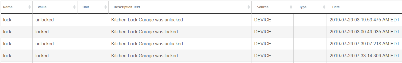

Via logging I can see that certain codes were entered to unlock the lock, but no events are ever created for it in the device events list:
When I compare this to my Schlage Zwave lock, it is entering events:
Is this the cause of the rule not firing? I asked a few owners of this same Schlage lock if events are logged for specific lock codes in this thread:
Yes, that's the reason.
