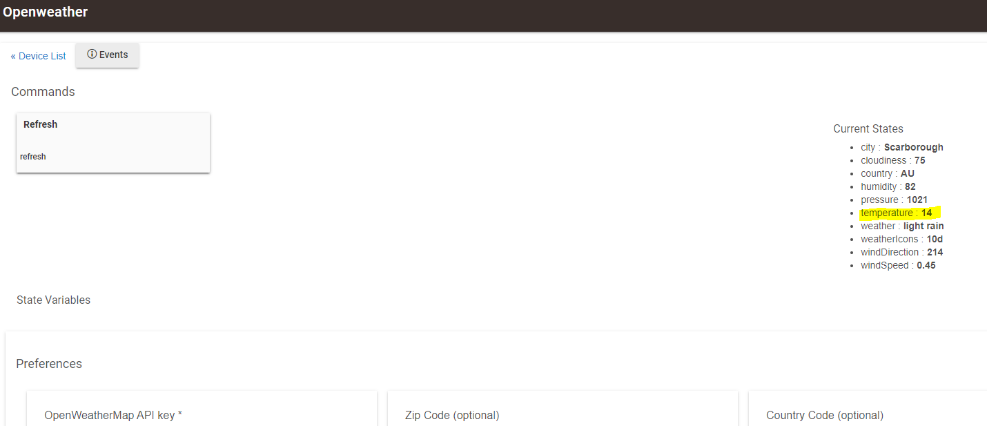

Hi there - I had a related problem (I think) and found a workaround by setting a global variable within the conditional rule set.
In your particular case, you probably could have simply used %value%, as it should contain the value of the trigger event that caused the rule to run.
Thanks - I did try that at first, but it came up with 'null'.
What was the event? Take a screenshot of the Events from the Openweather device (top of device page).
I will look into this a bit... Not sure why %value% was not set properly.
