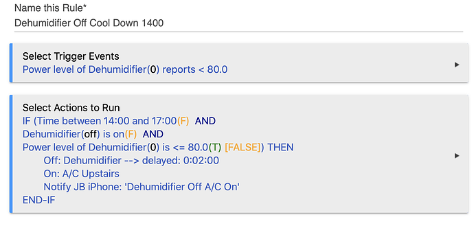

I am wondering if someone can help me with this and tell me what I am doing wrong. I thought I had this, but it seems I don't know what the heck is going wrong or what I am missing. In the morning, 8AM, I have my dehumidifier turn on and turn off the A/C units upstairs (mini-splits). The dehumidifier runs all day and I have it monitoring the power meter on the plug. When the time is 14:00-17:00 and the watts drop below 80, it waits two minutes then turns off the plug and then turns the A/C back on. I am using this to let the compressor turn off and the fan run for two minutes after the compressor turns off so it doesn't do a hard power off. This has worked on ST with a automation but I can't seem to replicate this in RM. Can someone help me with this? I have been working on this for several hours and it just doesn't want to work.
In this case I would make the trigger whenever the humidifier power goes below 80. Then your condition would be the time only. Since RM is event based the power going from above 80 to below 80 will only happen each time it does that transition and when the hum is on, so it shouldn't be needed in the condition (you can double check for the hum being on if you want). Therefore the only condition really necessary is the time.
Why don't you use 'Dehumidifier becomes on' as the trigger? You aren't even looking at the off condition. Then you could get rid of the first part of your conditional, and just look at the power level.
Or, what is posted just above. Power level becoming less than 80 surely means it's on.

Hi @bravenel, just for my knowledge. If the trigger was 'hum turns on' then wouldn't the rule only run once at 8am (it was indicated that's the 'on' event) and then never again until the hum went from off to on again? Therefore the rule would never get triggered later in the day to be within the 1400-1700 window, or am I misunderstanding the trigger?
Yeah, it has to be triggered from the power level, clearly. Even at 0 power, it doesn't send an off event, or an on event after that.

You shouldn't need the dehum in the condition at all. The condition needed is the time and you can put the AC in the condition to limit the rule from only doing the actions once in case the rule triggers as the power continues to decrease.
Rule triggers when power <80
If between (1400 and 1700) and AC Upstairs is off then
turn off the dehum after 2 mins
turn on AC
Notify...
Endif
