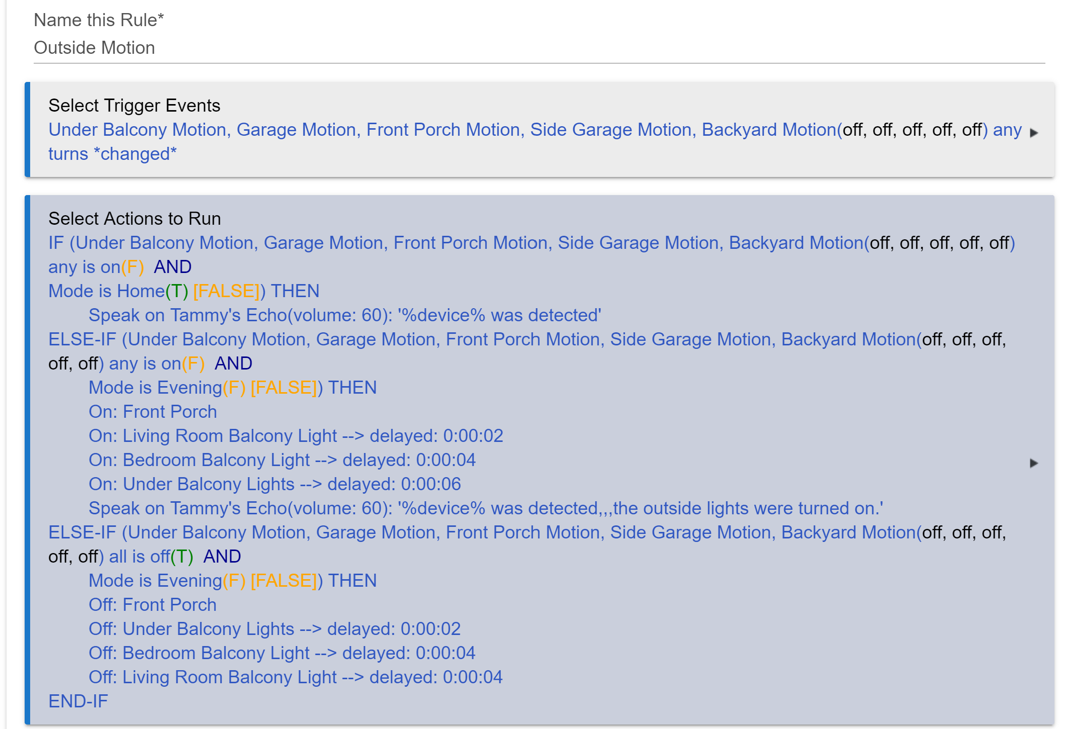

I could use some help here
We have 5 camera around the outside of our house, when each detects motion, it turns on a V-Switch via an Alexa Routine, thus triggering the rule below
I send my wife on a lap around the house to trigger each camera motion
Since it's daytime, we are currently in Home mode here, so the IF statement runs as expected.... Then 3-4 mins later, we get the same announcements as when she lapped the house the first time
Is it b/c the trigger is set to "changed" and when moving between each camera it keeps retriggering the Rule?
I guess one way to fix this is to create 5 individual rules however I would rather have just one
Thoughts?
Thanks, Rick

Man, This is a big one. but I think It can be made a bit easier to work with.
Trigger:  Motion1, Motion2, Motion3, Motion4, Motion5 any turns on
Actions:
IF Mode is Home
    Speak "%device% was Detected"
ELSE-IF Mode is Evening
   On light1
   On Light2 Delay 2
   On Light3 Delay 3
   Speak "%device% detected Lights turned on"
   Wait for condition  Motion1, Motion2, Motion3, Motion4, Motion5 all off
   Off light1
   Off Light2 Delay 2
   Off Light3 Delay 3
END-IF
Then if you wanted to keep the announcements to only so many times per some period. you could use a Private Boolean to de-bounce the rule. If you search the community for de-bounce or debounce you should find lots of examples.
