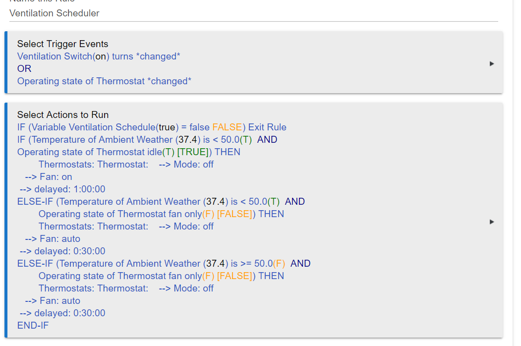

I have the following Rule that doesn't seem to be firing anymore, any assistance is appreciated.
The Logs show after the scheduled 1 hour delay it was supposed to turn the fan on.
The Event Logs for the Rule Show the last event logged was the "start" of the 1 hour delay.
The Device Events show the same thing the last event logged was the "start" of the 1 hour delay.
So the very top line of the "logs" showing Delay over and the fan turning on doesn't happen?
Any thoughts?

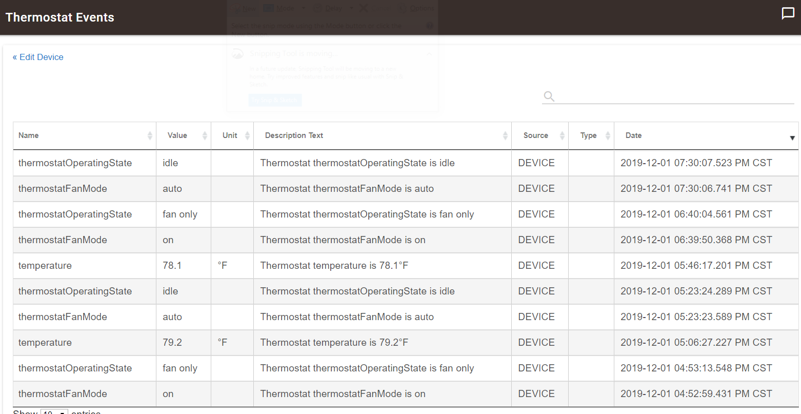

And the logs show the fan being turned on at 8:30 with the "Delay Over" log entry. So it looks like the rule did what you asked it to do.
Except the fan doesn't turn on as shown by the event logs of the rule and the device events

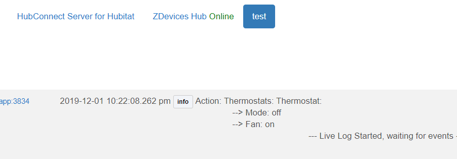

I'll look into it tomorrow, but I doubt this is a rule problem. Why don't you try a simple experiment, minus all of the rule overhead. Create a simple action that turns on the fan and sets the thermostat mode to off. Save that rule, then open it again. Hit Run Actions (with logging on). See what happens.
Also, look at the App Status for the rule above, and see if there is a setting called "thermoFanMainX", where X is some number.
It works perfectly fine.

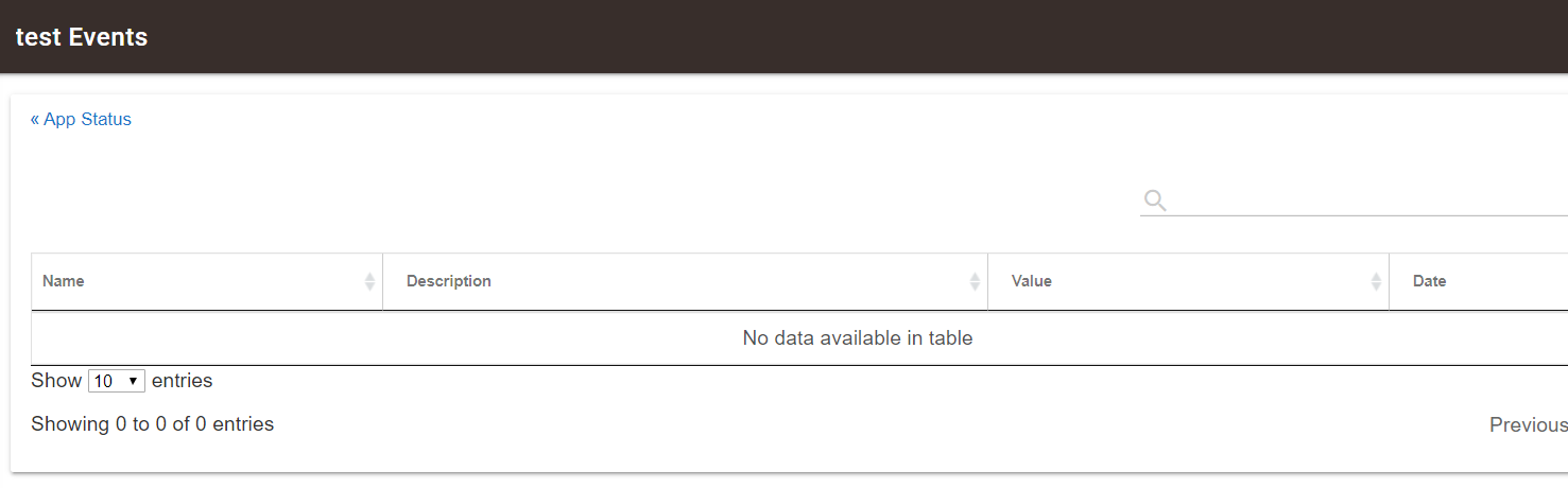

But it didin't log any events for the rule
But DID log an event for the device
Did you change the rule option 'Logging' to enable events logging?
Any idea what might be happening above?
So it worked in a simple way, right? So try that simple rule with a 1 minute delay and see if that works also. If not, let me know. If it does, then that would rule out RM as having a problem, and the problem lies somewhere else. I don't have a clue, but these are the steps I would take.
