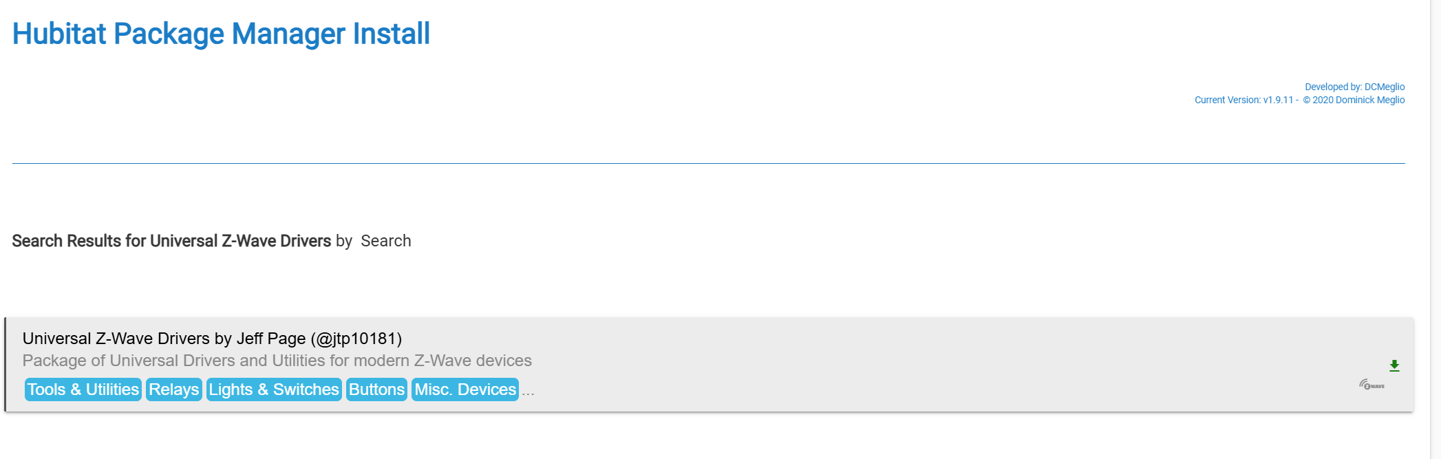

It does not appear to be in hpm. But I'm a novice so I could be doing something wrong.
Hmm, should be. :thinking:
Showing up for me:
Find on Hubitat Package Manager (HPM):
Package Name: :small_blue_diamond: Universal Z-Wave Drivers :small_blue_diamond:
HPM Install Docs: HPM Documentation
NOTE: The scanner driver is marked as required in the package so it is always installed no matter what other drivers you select to install with it (or select no other drivers to get just the scanner).

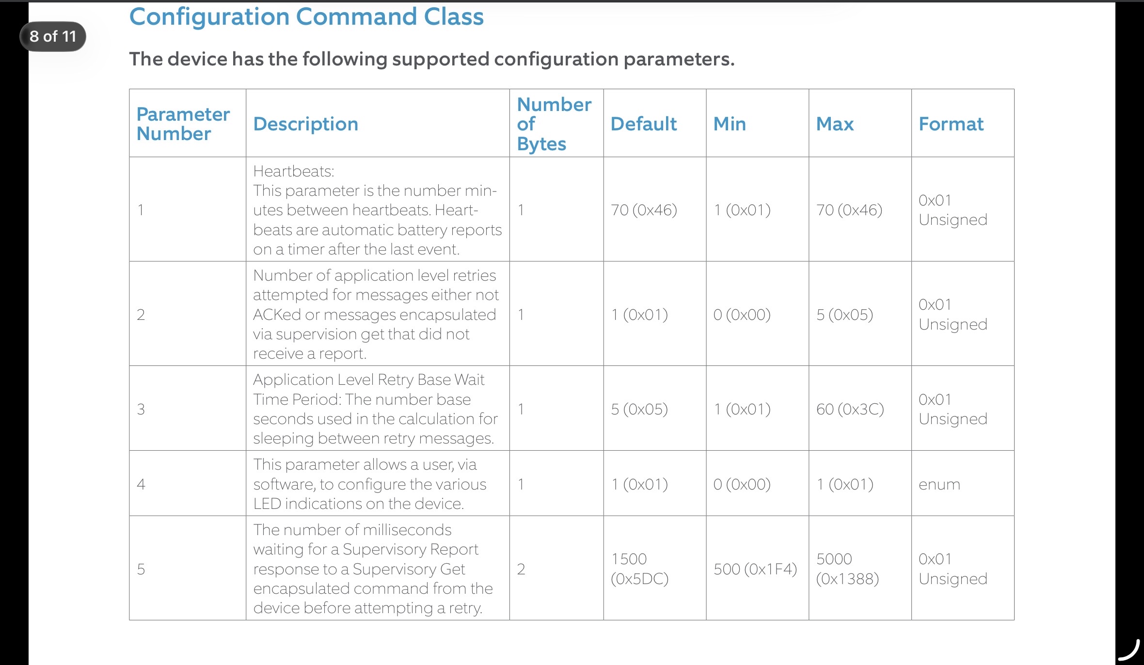

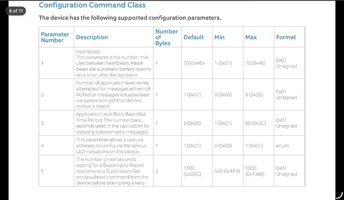

Okay I found it I had search terms reverse. Now to figure out how to use, The Ring Extender driver has no parms at all.
If you use the community [RELEASE] Ring Alarm Range Extender Gen2 driver
You will automatically get the Heartbeat parameter.
