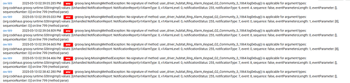

My logs are full of errors. No one else is seeing this issue?
Try it now. I fixed the motion parsing which resulted in that debug log being attempted, and also fixed the debug logging lines.
Hubitat-by-Mavrrick/Ring/rkg2_driver.groovy at rkg2_update · jtp10181/Hubitat-by-Mavrrick · GitHub

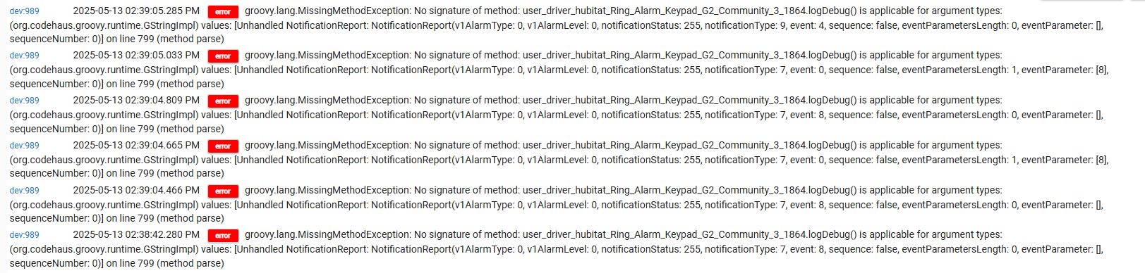

I updated the driver and now I'm seeing a new error in the logs
That one appears to be a platform bug, it was mentioned up above.
